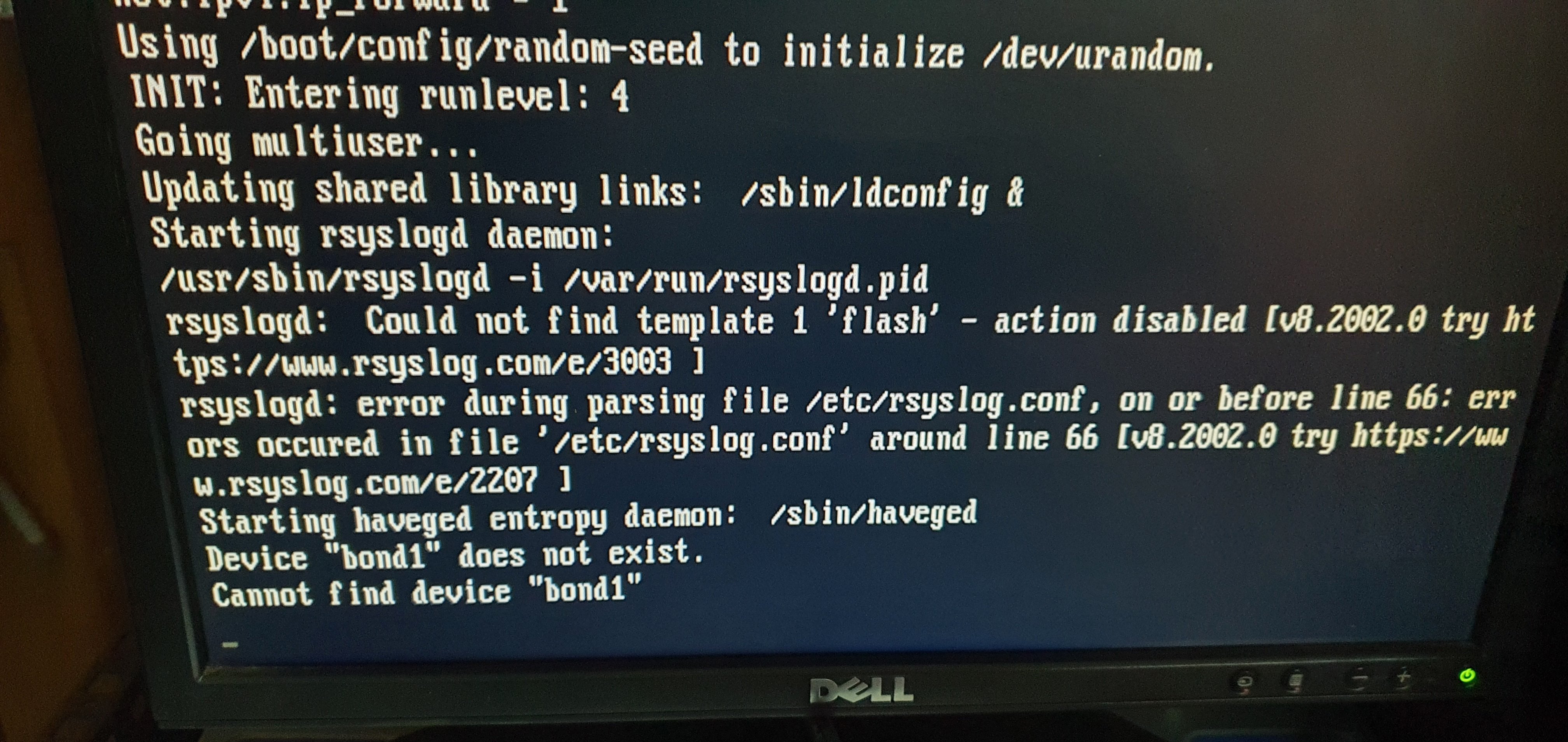

July 27, 20206 yr Good Day All I an New to the Unraid world and know my Way around NAS and Servers but i keep getting Freeze ups when doing random Task on my Server, some days when i let it Run and do nothing but as soon as i copy data over to a Share or Run a VM like MacinaBox the whole System Freezes up. where the Web Ui does not respond and Network Drives go offline and the Server Freezes, i have also Ran it in GUI mode on the Server and it does the Same not matter the Mode i launch it in. Please help hydrogen-diagnostics-20200727-1256.zip Okay update on the 28 July 2020 Ran a Mem Test and all passed fine Also i get this error on boot up hydrogen-diagnostics-20200728-2024.zip Edited July 28, 20206 yr by [email protected] added new updates and logs
