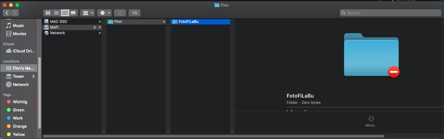

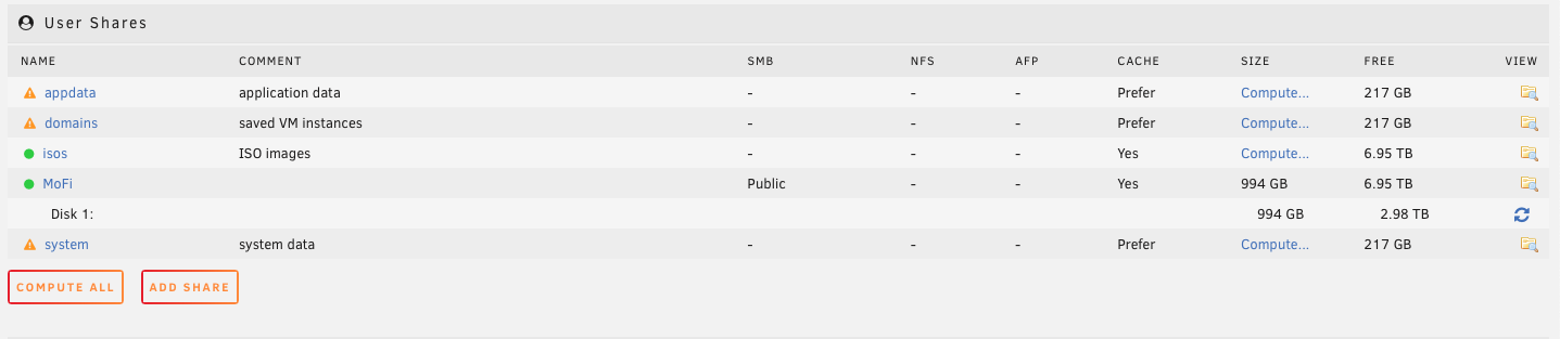

Its working fine and I can see my shares with my Mac and also with my phone/tablet but I can't open the files or view them ...
65396683_Screenshot2020-05-21at14_03_16.thumb.png.6076f2e616b6d9986a59ea5ff390d69a.png
812479515_Screenshot2020-05-21at14_04_03.thumb.png.6a50293d0b8e6eae9b4d61780c50cb7b.png
When I want to access the Folder inside my share it says I don't have permission

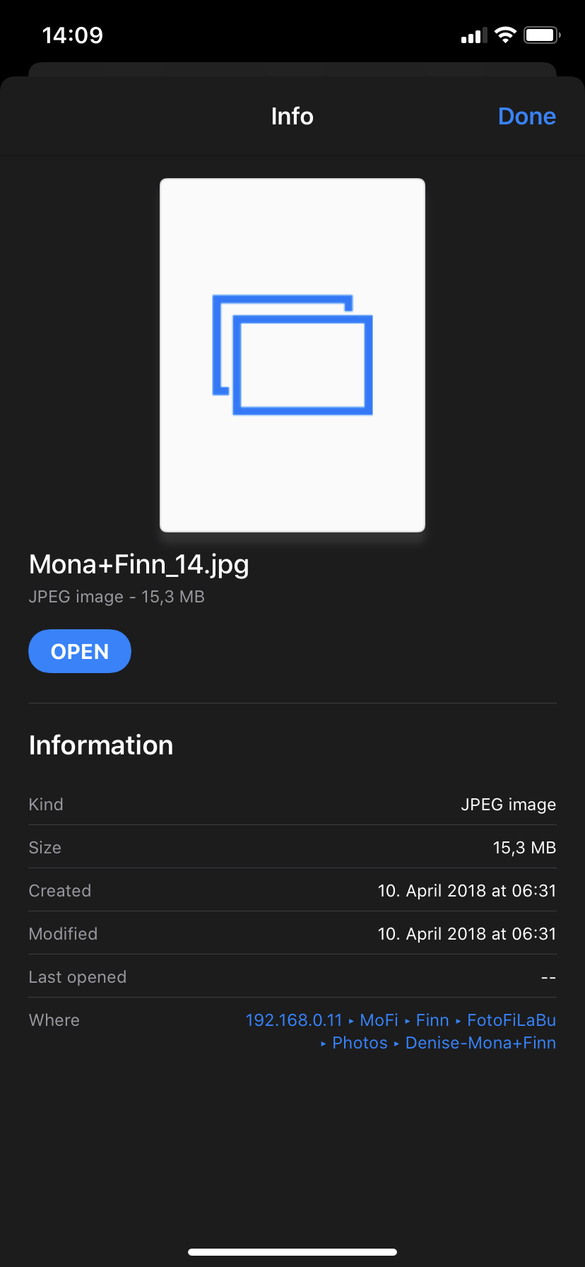

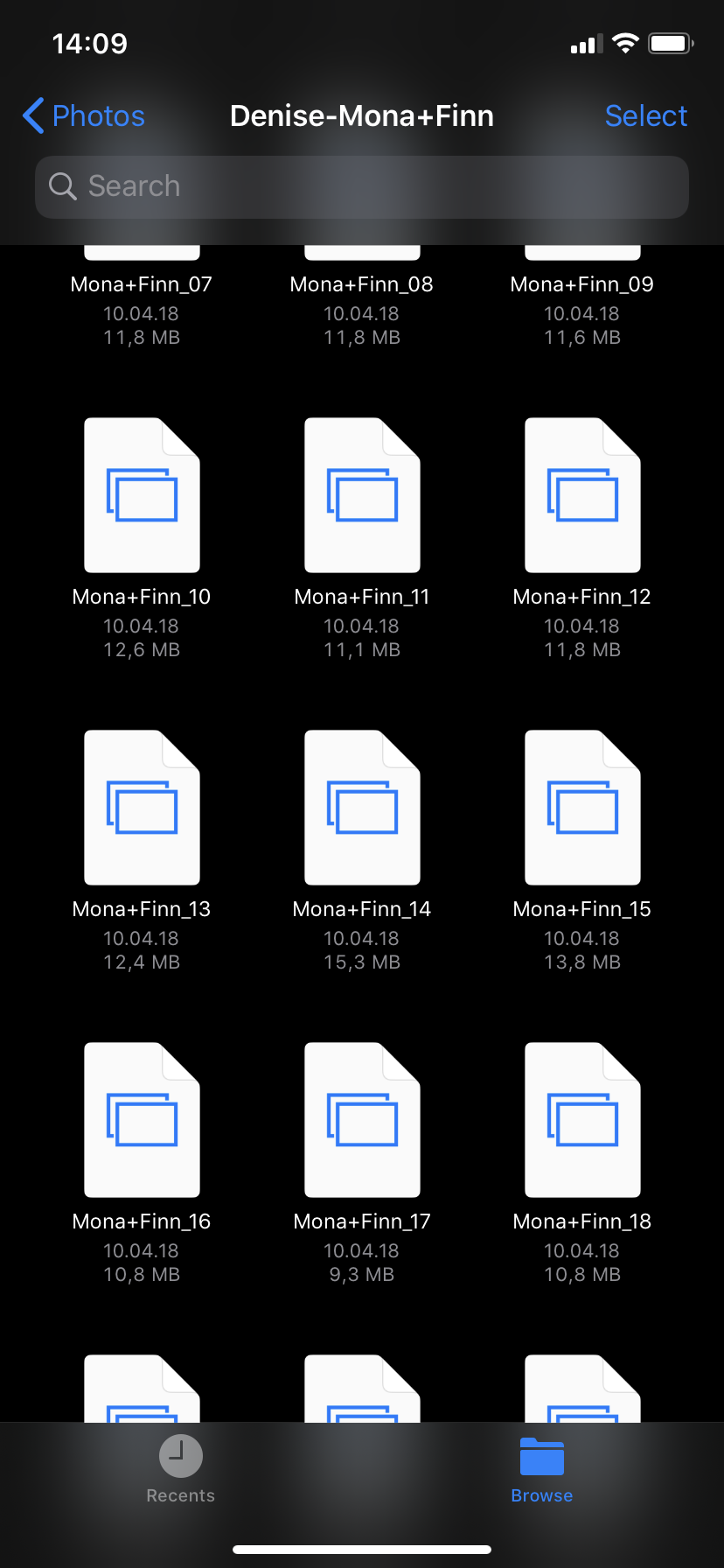

When I use my phone or tablet I can go inside this folder but it won't show/load the content that's inside.
IMG_0500.thumb.PNG.9d290bf15889357e079d8bd405decc68.PNGIMG_0501.thumb.PNG.66d0a170decf5c27da14ffa5d61206e9.PNG

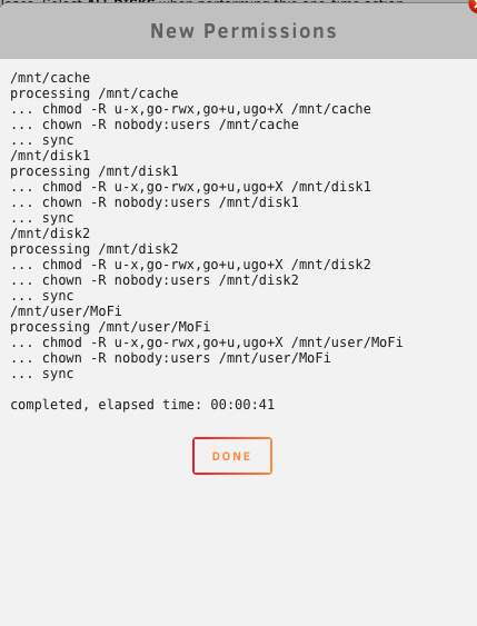

You probably have incorrect permissions on the files since you did not load the files over the network. :(
run Tools >> New Permissions on the shares you have just loaded and that should correct any permission issues.
Just did that , also restarted my mac, the folder inside my share still wont let me in or fixed the preview for the pictures on my phone.
