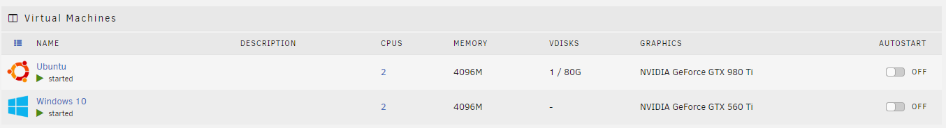

UPDATE AFTER A FEW HOURS:
I just tried swapping my GPU`s in my system ; still dont get a display with the Windows VM`s.....
Strange enough, even my Ubuntu VM has stopped displaying via my graphics cards....Might be something I did honestly
I`m not sure what i`m doing wrong, at this point

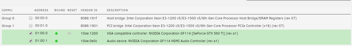

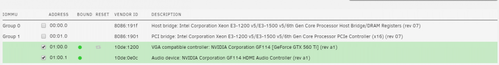

Update so far:
Ive got Ubuntu and other Linux distros working well. For the stuttery audio issue, I reffered the fix mentioned here : https://forums.unraid.net/topic/53062-ubuntu-16041-x64-quotdemonicquot-audio/ , and it worked like a charm.
But I STILL CANNOT get a Windows VM to boot. I did notice that it had booted ONCE via both my Display cards, and after that Nothing. Anyone with pointers?
Todays findings:
I followed the instructions from Spies, here :
. Seemed pretty close to what Ive been experiencing.
Kept the machine specs as is and the added the following line to my sysLinux section (You can get the PCI adresss from Tools > System Devices):
append vfio-pci.ids=10dxx:12xx10xx:0exx initrd=/bzroot,/bzroot-gui
And then rebooted UNRAID.
The Windows VM again, Launched once.....and post a reboot, dead as a door nail. I did happen to notice, during the time it showed up, the Keyboard and mouse were unresponsive. So I unplugged all the USB devices and tried again, no display.
I modified the line in SYSlinux to look like this:
append vfio-pci.ids=10dxx:12xx10xx:0exx video=efifb:off  initrd=/bzroot
Still nothing from the Windows VM
I even tried this one (With a reboot)
append vfio-pci.ids=10dxx:12xx10xx:0exx pcie_aspm=off iommu=pt video=efifb:off initrd=/bzroot
No video output from the WIndows VM.

You can easily stub the card by installing this, it must be in its own iommu group though.
Edited by Spies
I do have 2 cards in my system. I have tested both of them using Linux and they work brilliantly. I had 2 Linux machines running on individual cards, simultaneously. At the moment, my 560Ti is the primary card (top slot). I did have the 980Ti in my top slot earlier, but never had any success with Windows.
I did leave one card in the system earlier, just to see if it would make a difference to Windows (first i removed the 560Ti, and then ONLY the 980Ti). Linux worked, but not Windows.
I`ll try the Plugin you mentioned for Stubbing the DIsplay card correctly.  These are my display cards under system devices :
560TI
IOMMU group 1:[8086:1901] 00:01.0 PCI bridge: Intel Corporation Xeon E3-1200 v5/E3-1500 v5/6th Gen Core Processor PCIe Controller (x16) (rev 07)
[10de:1200] 01:00.0 VGA compatible controller: NVIDIA Corporation GF114 [GeForce GTX 560 Ti] (rev a1)
[10de:0e0c] 01:00.1 Audio device: NVIDIA Corporation GF114 HDMI Audio Controller (rev a1)
980Ti
IOMMU group 15:[10de:17c8] 07:00.0 VGA compatible controller: NVIDIA Corporation GM200 [GeForce GTX 980 Ti] (rev a1)
[10de:0fb0] 07:00.1 Audio device: NVIDIA Corporation GM200 High Definition Audio (rev a1)
Look alright?
Just stubbed the 560Ti in the VFI app:
Rebooted UNRAID, Windows VM still wont display anything.....Still using the same Disk-less VM
Edited by Mythzz
It needs to be in its own group, that has a PCI bridge in the there too, you might need to use ACS override to split the group's further.

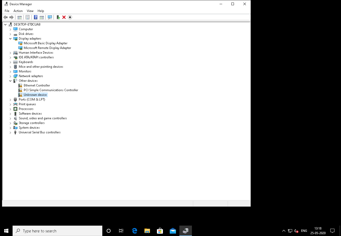

So, what if you install teamviewer then remote into it, is the gpu showing up in device manager?
Interesting.....i dont see the Nvidia card listed here:
Ill install the nvidia package manually and see what happens.
its the basic display adapter, I'm betting you have a code 43 on it.
Dude it worked!!! I just restarted the machine a couple of times to make sure I wasnt seeing things. I could even see the OVMF screen pop up.
Does this mean each time I make a Windows VM, ill have to first VNC the VM, then use an RDP console to install drivers manually each time?
Not sure, windows would usually take care of it on it's own, but if it works, it works :)
