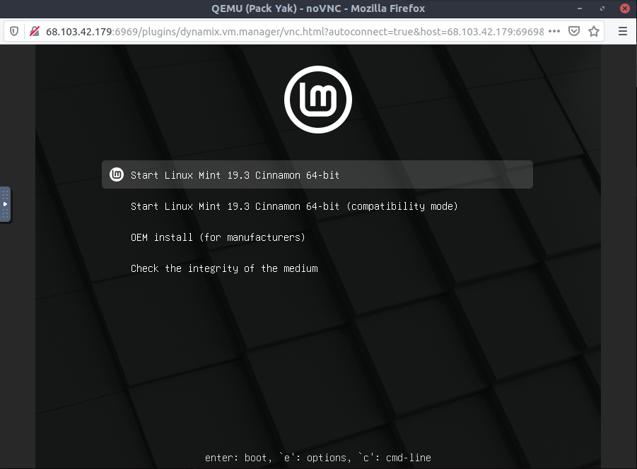

Hello! My apologies I am very new to this, but I haven't managed to get any VMs working in unraid yet. My current config is a Linux Mint install iso and it wont let me get past the first install screen. It gives me this error (I have attached screenshots as well)
error: attempt to read or write outside of disk `hdo` error: you need to load the kernel first.
This is my VM configuration xml bit. If it helps

How much space have you allocated for the vdisk?    That error message sounds as if it may be too small?
The Vdisk size is 107GB right now
