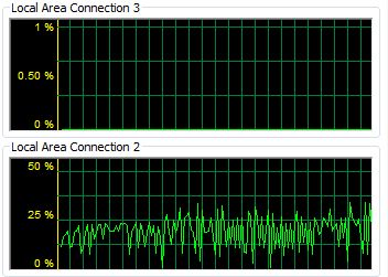

The only think I noticed so far is that since changing out the parity drive I've see choppy transfers when copying files to the array.
In my attempt to check the network connection I installed a second nic and a different cable but the transfer is still choppy.
My transfers have looked like that for a while, but I am still on 4.5.4 I believe (waiting for 4.6final). I thought I read somewhere not to worry about it, but if it is abnormal, I'm right with you.

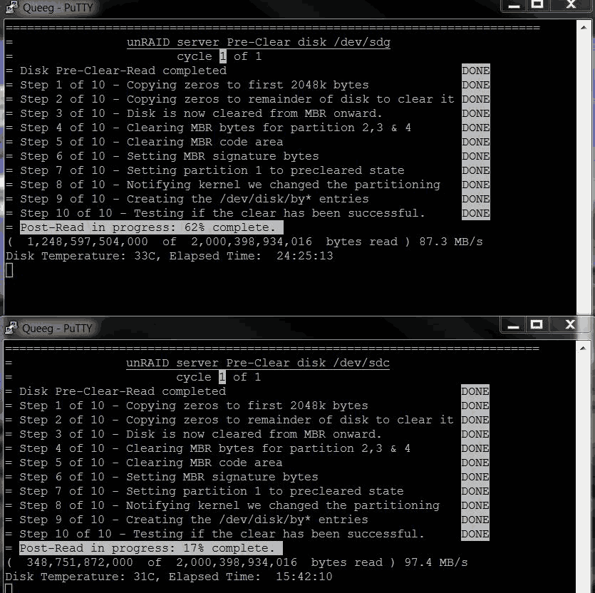

I'm seeing read speeds on my new drives that are fantastic during the preclear.
