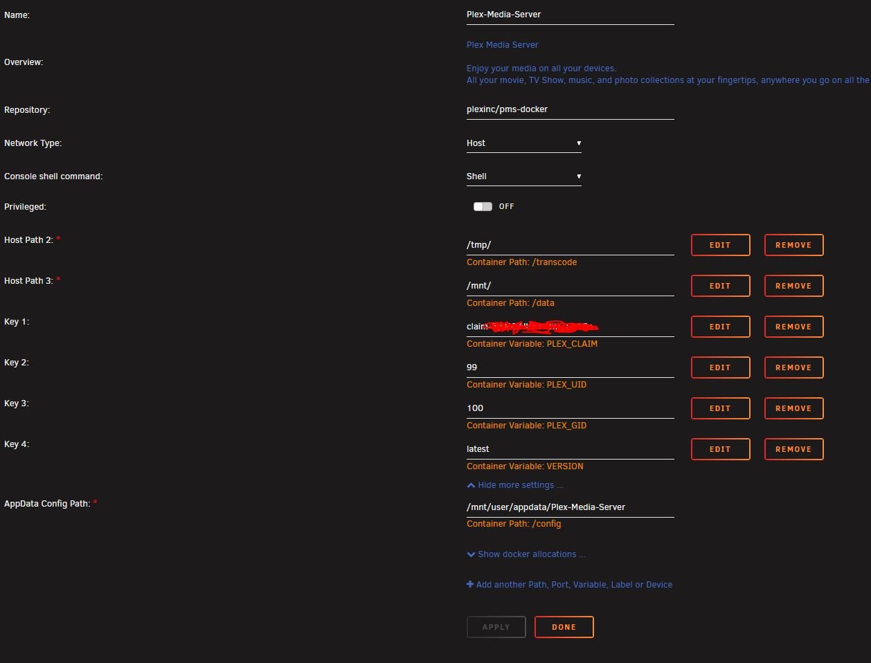

Not sure if they're related or not. I am also posting my config as a screenshot under. I have no idea what I am doing, so I may have configured it wrong. Please help. I have had so much problems with unraid since I started swapping over from my windows server 2016. I am already starting to regret the change.
The screenshot often doesn't show some important details. Post your docker run command as explained in this very first link in the Docker FAQ:

root@localhost:# /usr/local/emhttp/plugins/dynamix.docker.manager/scripts/docker run -d --name='Plex-Media-Server' --net='host' -e TZ="America/Los_Angeles" -e HOST_OS="Unraid" -e 'PLEX_CLAIM'='claim-[redacted]' -e 'PLEX_UID'='99' -e 'PLEX_GID'='100' -e 'VERSION'='latest' -v '/tmp/':'/transcode':'rw' -v '/mnt/':'/data':'rw' -v '/mnt/user/appdata/Plex-Media-Server':'/config':'rw' 'plexinc/pms-docker'

I noticed in your diagnostics you had some remote shares mounted with Unassigned Devices. Does plex use these?
Your only mapping that would reach these (as well as the rest of your disks and user shares local to the Unraid server) is /mnt:/data
But, Unassigned Devices need to be mapped with the slave option, which you don't have in your /mnt mapping.

Yes, these shares are media shares from my second fileserver, and are only mapped to this server for Plex. I followed the link you posted, but it doesn't really tell me how to do this. I found this in one of the linked post by Squid, but not really sure how to do this or where i can edit the mount point:
As far as I can tell, Plex gets access to the shares. I can view media in Plex from those shares.

Actually that post spells it out a little better than the one I gave:
On 5/26/2017 at 10:57 AM, Squid said:
you need to adjust your volume mappings mode (usually either RW or Read Only) to be RW:Slave or Read Only:Slave) by editing the template, and then clicking "Edit" on the volume being passed to the container.
Click on the icon for your Plex on the Dashboard or Docker page and select Edit. That will take you to the Edit Container page (same as the Add Container page you used to setup plex docker). Beside your mapping for /mnt:/data is an Edit button. Click that button and change Access Mode to RW/Slave.
