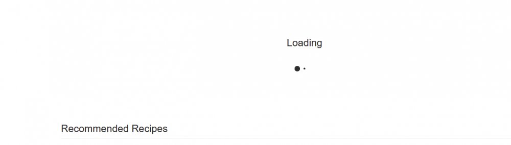

I've got an interest issue with the reverse proxy setup.
Using the subdomain conf in the first post, I can connect perfectly fine.
But I tried to update the conf to use proxy_pass, as I do with the rest of my confs through swag/letsencrypt, and now it just says "Loading" with the dots on open eats. I have updated open eats network to be "proxynet" which is used for all my containers in the reverse proxy.
Here is my proxy conf:
server {
    listen 443 ssl;
    listen [::]:443 ssl;
    server_name openeats.*;
    include /config/nginx/ssl.conf;
    client_max_body_size 0;
    # enable for ldap auth, fill in ldap details in ldap.conf
    #include /config/nginx/ldap.conf;
    # enable for Authelia
    #include /config/nginx/authelia-server.conf;
    location / {
        # enable the next two lines for http auth
        #auth_basic "Restricted";
        #auth_basic_user_file /config/nginx/.htpasswd;
        # enable the next two lines for ldap auth
        #auth_request /auth;
        #error_page 401 =200 /ldaplogin;
        #include /config/nginx/authelia-location.conf;
        include /config/nginx/proxy.conf;
        resolver 127.0.0.11 valid=30s;
        set $upstream_app openeats;
        set $upstream_port 8760;
        set $upstream_proto http;
        proxy_pass $upstream_proto://$upstream_app:$upstream_port;

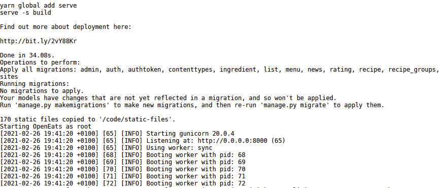

I just upgraded to Unraid 7.0.0 and OpenEats has stopped working. I'm not very well versed in python, but it looks like there's an issue with django perhaps? I've attached my log below. I can access the webGUI, but nothing seems to be populating from the database. I physically checked the database and everything appears to be there and everything appears to be configured correctly in the container settings.
For what its worth, I also attempted to do a fresh install in another container and it never auto-created the tables. It just spat out an error that stated table "[NAME OF THE TABLE I PICKED].auth_user" doesn't exist...which obviously it doesn't, it was a fresh install.

170 static files copied to '/code/static-files'.
Starting OpenEats as root
[2025-01-12 18:28:05 -0500] [35] [INFO] Starting gunicorn 20.0.4
[2025-01-12 18:28:05 -0500] [35] [INFO] Listening at: http://0.0.0.0:8000 (35)
[2025-01-12 18:28:05 -0500] [35] [INFO] Using worker: sync
[2025-01-12 18:28:05 -0500] [38] [INFO] Booting worker with pid: 38
[2025-01-12 18:28:05 -0500] [39] [INFO] Booting worker with pid: 39
[2025-01-12 18:28:05 -0500] [40] [INFO] Booting worker with pid: 40
[2025-01-12 18:28:05 -0500] [41] [INFO] Booting worker with pid: 41
[2025-01-12 18:28:05 -0500] [42] [INFO] Booting worker with pid: 42
Edited by CrispyFrizzles
