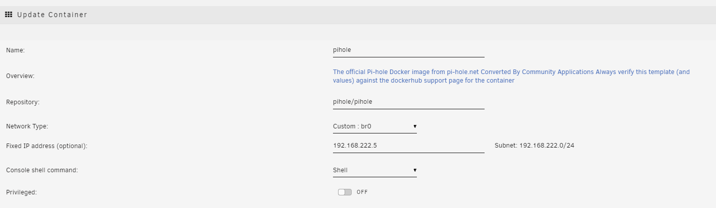

Now for pihole, I've put mine on the custom: br0 bridge and gave it an IP in my own segment, since this allows my to use port 80 of the host and still have pihole available on that same port. No VLAN was required at all for this.
Note that I do use VLANs, but that's mainly to be able to reach the host from a docker container.
I've created a macvlan driver network on that VLAN, without giving the host an IP in that same VLAN, this allows me to reach the unRAID host on its usual address from the newly created network.
