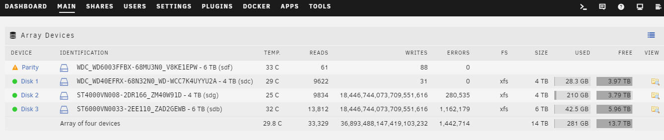

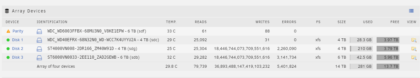

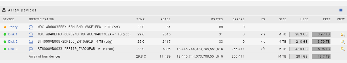

You say 2 disks were giving errors - if so which ones?     Nothing sprung out to me to say which ones from the posted diagnostics.
Errors on multiple disks like that suggests a connection/power or controller problem, check/replace cables first, it it doesn't help try a different controller if available.
