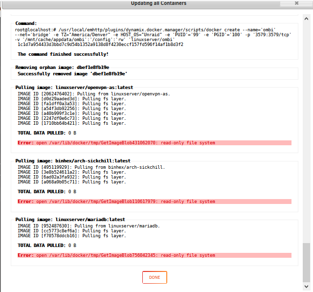

I added a Tortek USB dongle to set up HomeAssistant. When I went to the Docker page, it was blank. Docker reverted to the normal white not dark mode.
I rebooted, it started OK, but updating Docker images failed,  had three items that just had text below,  "read-only file system"image.png.d4794429c8abe6e1436315606484eb7b.png

Docker image is failing a checksum, this means there was data corruption, re-create the docker image but if this keeps happen you might have a hardware issue, like bad RAM.
