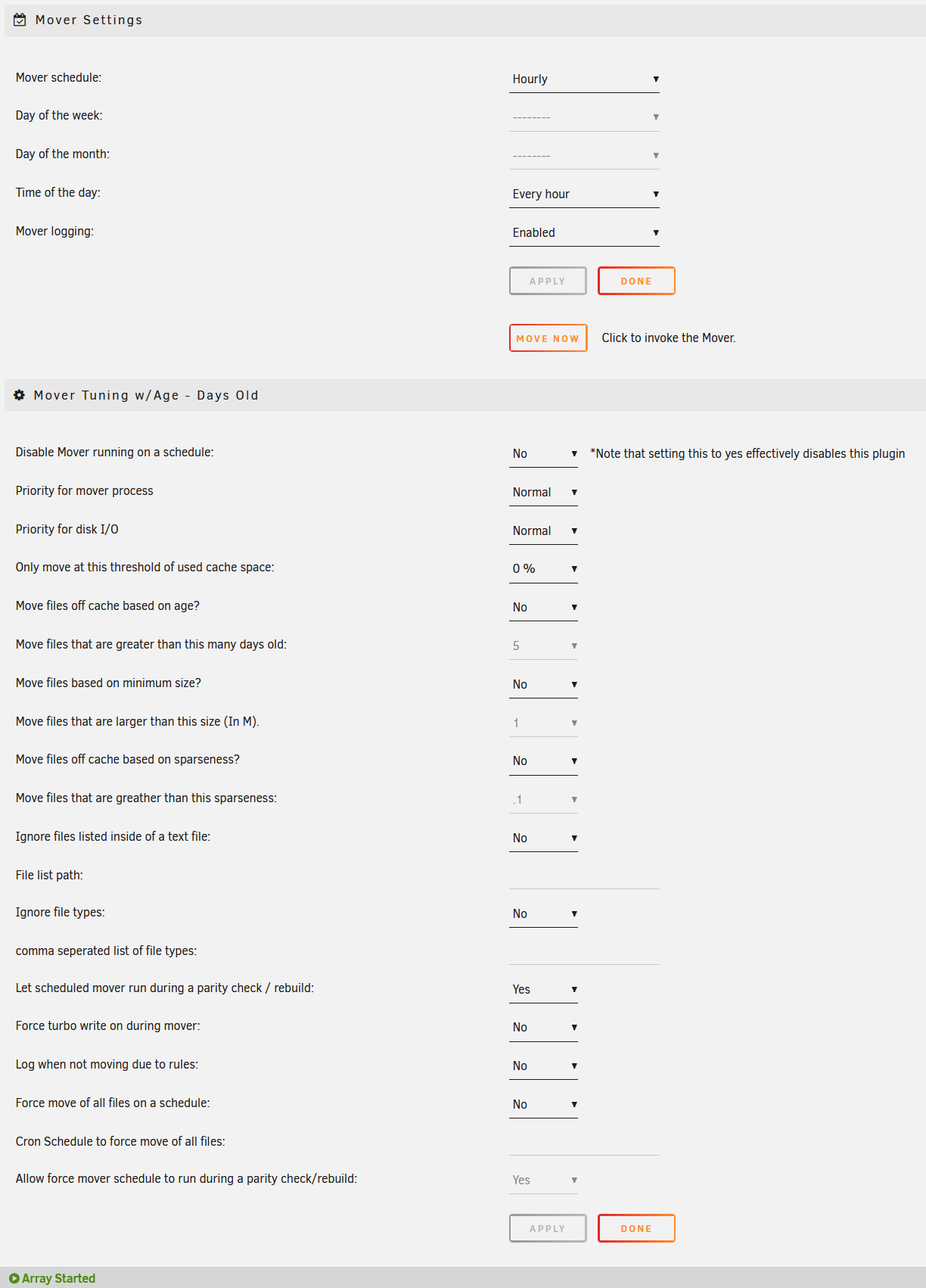

I tried to add the Community Addon "Mover Tuning" but it does not help my cause either.
I set mover logging to enabled but it appears to not prompt anything more in-depth or I am looking in the wrong spot.
I checked the log for "mover" related items but didn't find anything suspicious aside from "started" / "finished" being instantaneous.

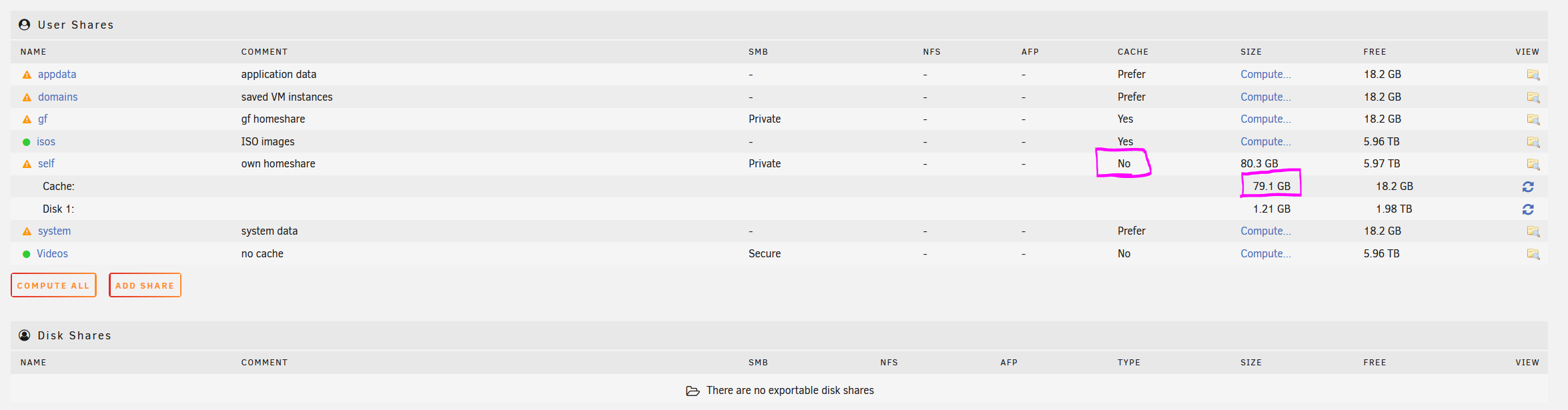

Cache Yes / No:
Even if I set the cache to "Yes" or "No" and run mover manually it still keeps the files on the cache drive. For example attached screenshot is the result of setting it to no and running mover.
It does say:
May 23 09:41:16 BAK root: mover: started
May 23 09:41:16 BAK root: mover: finished
Am I looking at this the wrong way? For example is it impossible to move cached files off of the cache with mover if you set the share to cache: no?
Yes.
Mover ignores cache-no and cache-only shares. It moves cache-yes shares from cache to array, and cache-prefer shares from array to cache. Cache-yes/prefer shares can overflow to the array if cache goes below its Minimum Free setting in Global Share Settings.
Also, mover can't move open files, and it won't move duplicates.
appdata, domains, and system shares are cache-prefer by default, so your dockers/VMs performance won't be impacted by the slower array, and so they won't keep array disks spinning, since these files are usually open files. Those shares all look correct according to the diagnostics you posted assuming you haven't changed them. That is good because it can take a few steps to get them moved to cache since their files are open.
If you want to move other shares from cache to array you must set them to cache-yes. Then if you don't want new files for those shares written to cache, you can set them to cache-no after all the files have been moved.
