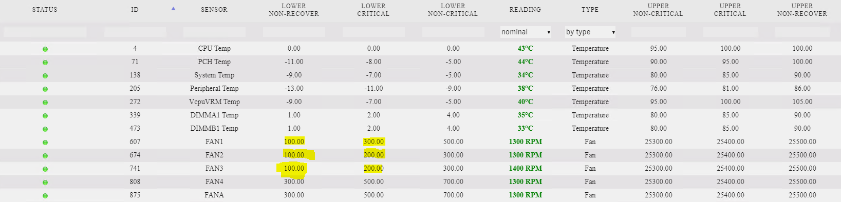

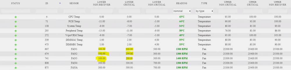

You need to lower the thresholds, they can be lowered on the IMPI plugin for low spinning fans, I had to do the same to some of mine:
Note that not all values are valid, some boards might only accept for example multiples of 150, (150. 300, 450 and so on).
