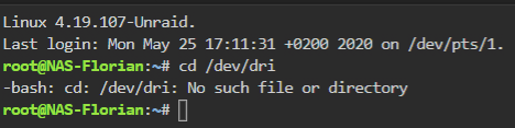

The installation of plex went well. I checked the presence of hardware transcoding using the cd /dev/dri command.
The console returns the command "-bash: cd: / dev / dri: No such file or directory".
Where could the problem come from?
Thank you

root@NAS-Florian:~# cd /dev/dri
-bash: cd: /dev/dri: No such file or directory
root@NAS-Florian:~# modprobe i915
root@NAS-Florian:/dev/dri# ls
by-path/  card0  renderD128
root@NAS-Florian:/dev/dri# chmod -R 777 /dev/dri

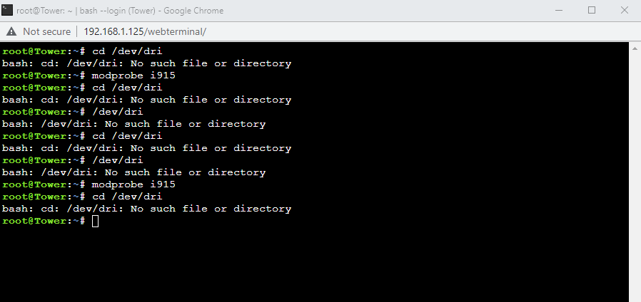

I added the /dev/dri as a device in the Plex docker but this makes the docker error :/
Did you do what the post above yours says and do you have a /dev/dri folder after doing it?

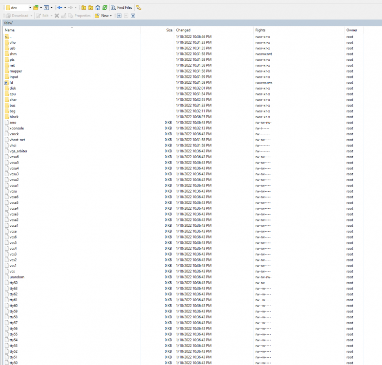

So I recently upgraded from a 6700k to a 12900k because I wanted to get Hardware transcoding on my plex server and was told that the older CPU would not support this. Got the new system build but I can't seem to get integrated graphics to be detected.
I started with this tutorial: https://forums.unraid.net/topic/77943-guide-plex-hardware-acceleration-using-intel-quick-sync/
and immediately rand into a problem where No such file existed
So following advice from here https://forums.unraid.net/topic/92858-error-bash-cd-devdri-no-such-file-or-directory-plex/?_fromLogin=1
I installed intel gpu top, but that didn't change anything.

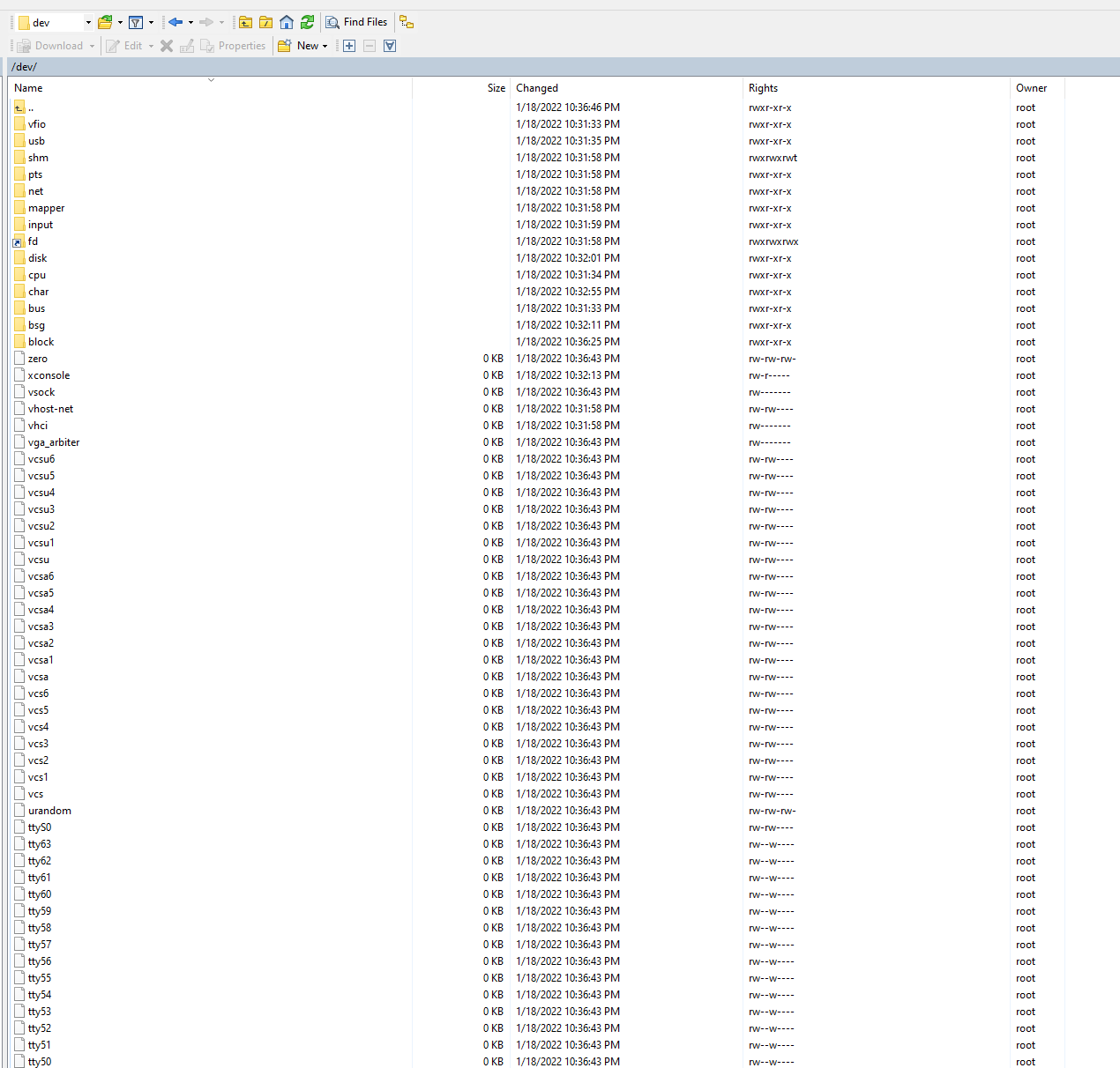

I next went into the MSI bios and set the Initiated Graphic adapter to IGD and rebooted and still nothing
On checking the directories I can see that dri does not exist in the dev.
I did see some comments about needing to white list drivers but that is after the system detect an iGPU and generates the dir directory correct? (Advice found herehttps://forums.unraid.net/topic/103434-69-devdri-is-missing/)
Looking at my system devices I see a VGA compatible controller but I am unsure if that mean it is see the iGPU or not, I dont see anything that say using i915 kernel.
I did see some post saying that the new intel cpu are not supported the 11 and 12 gens. I figure development will take a while would it be better to just put this on the back burner until whenever that is.
Any help would be appreciated.

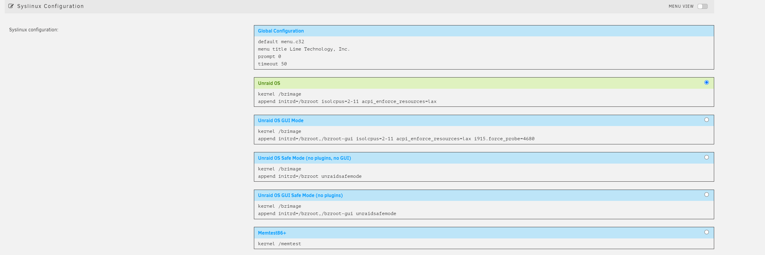

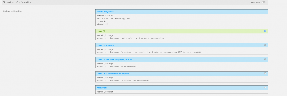

To do the first one in terminal I type "echo "i915.force_probe=4680" >> /syslinux.conf"
Click on the falsh drive from the main tab and update the menu lines you need example on the GUI Menu section.
Thanks for the example it helps alot. So just to be clear your kernel parameters for acpi_enforce_resources and the isolate cpu are not related to fixing this problem right I just need to add the i915.force_probe=4680. Then I reboot and it should generate the folder and work?
Is this similar to the solution added the kernel parameter i915.alpha_support=1 found here where the dev/dri wasn't present.
This is separate from blacklisting i915 and if this didn't work, I should go the blacklist route then I would remove this parameter? Then edit /etc/modprobe.d and add blacklist-i915.conf?

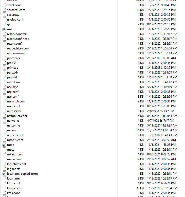

Do I need to create this file becasue I don't see it in the directory etc?
Yes you just need to append this to you existing config and yours maybe different to mine.
Read the post for Alderlake as it has info on blacklist for rc2. On unraid you need to modify /boot/config/modprobe.d and change will take place at reboot. You only need to do 1 of the options.
This is my i915 file on by 12600k system and I have Intel-gpu-top installed.
