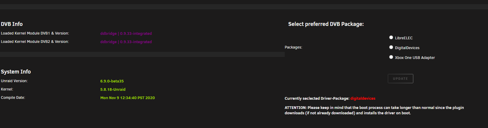

For the Unraid DVB plugin, Is there an option to select a newer driver version than 0.9.33-integrated?
We have a DigitalDevices Max S8X basic and it is not picked up.
The DigitalDevices Cine S6 V6 is picked up, not the S8X though.
I'm assuming I need newer drivers. How do I accomplish this?

Can you tell me which package shows up on the DVB Plugin page, LibreELEC or DigitalDevices?
Have you rebooted after selecting the digitaldevices package?
The digitaldevices package is compiled with the latest available drivers from digitaldevices from their github.
Of course! Thank you!
First, sanity check: The tuner is showing up.
[dd01:000b] 25:00.0 Multimedia controller: Digital Devices GmbH Device 000b
Then, to answer your questions:
- Package that shows up is "digitaldevices".
- I have performed a reboot after selecting download.
Driver version shows as 0.9.33-integrated, while the latest digitaldevices drivers seem to be 0.9.37.
The syslog also reports loading an out of date driver (c 2017)
Nov 15 11:39:37 UMS kernel: ddbridge: Digital Devices PCIE bridge driver 0.9.33-integrated, Copyright (C) 2010-17 Digital Devices GmbH
Since the DigitalDevices S8 series requires extra configuration, I have added this to the syslinux config
kernel /bzimage
append initrd=/bzroot ddbridge.fmode=3 ddbridge.msi=1
However, this used to be part of the documentation of the Unraid DVB post that was removed.
This config step seems to be mandatory, although I am unsure whether not configuring that prevents the drivers from picking up the card at all.
In case the syslinux config change isn't working anymore, what would be necessary is to create a config file in /etc/modprobe.d/ddbridge.conf which must persist between reboots.
http://support.digital-devices.eu/index.php?article=151
I'm also unsure how to achieve this with the new dvb infrastructure
Here's a screenshot of the page (Cine S2 V6 there, Max S8X not there)
Edited by Spiritreader

Hmm, that is indeed very weird.
Good to know it's not the driver version, must be something else then.
Before trying 6.9b35, I also wasn't able to get the card working on 6.8.3 with the custom-kernel-helper builder. That kernel however, also picked up the S2 C6 fine.
Here's the output of lsmod, I put it in a pastebin so it doesn't spam the forum.
https://pastebin.com/5RkQRr74
Yes you can contact me, in fact I would be very glad to!
My timezone is Europe/Berlin, GMT+1.
Thank you for trying to help me out!
Then we are in the same timezone. ;)
I'm located in austria, can you write me a quick PM to talk there and post the solution here afrer we solved it?
