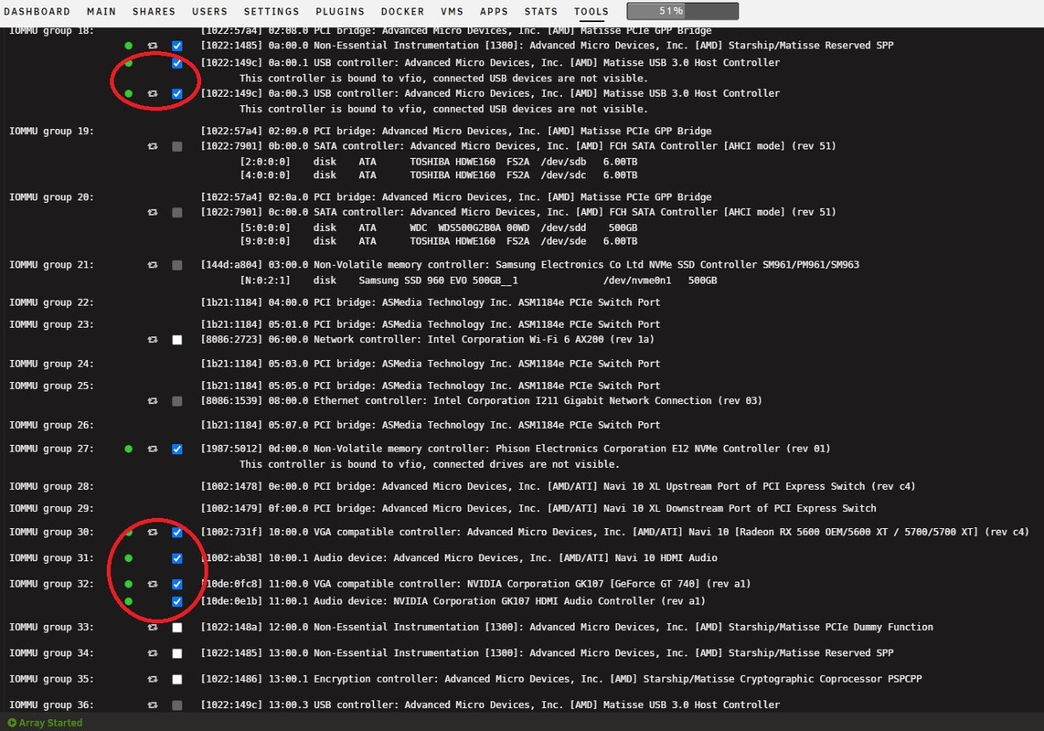

Here's my IOMMU when I DONT use any ACS patches -   I see at bottom both GPUS (Nvidia in one group, AMD in two) but BOTH audio sections dont show FLR enabled and at top the pair of USB controllers we normally have to pass (allegedly other one doesnt like being passed) one of which doesnt show FLR enabled.    I wonder if the BIOS is borked? I'm clutching at straws
I removed RX5700 and put a GT740 in.... zero issues with any reboots etc. I was doing it to try to confirm the BIOS wasnt at fault or my config. I am now pretty sure its either the FLR patch that is at fault OR my Powercolor RX5700 is not same as other RX5700s. I have tried non Powercolor BIOS rom in config and no difference....    I guess my unRAID VMs are gonna have to be done using 2 x GT740s
