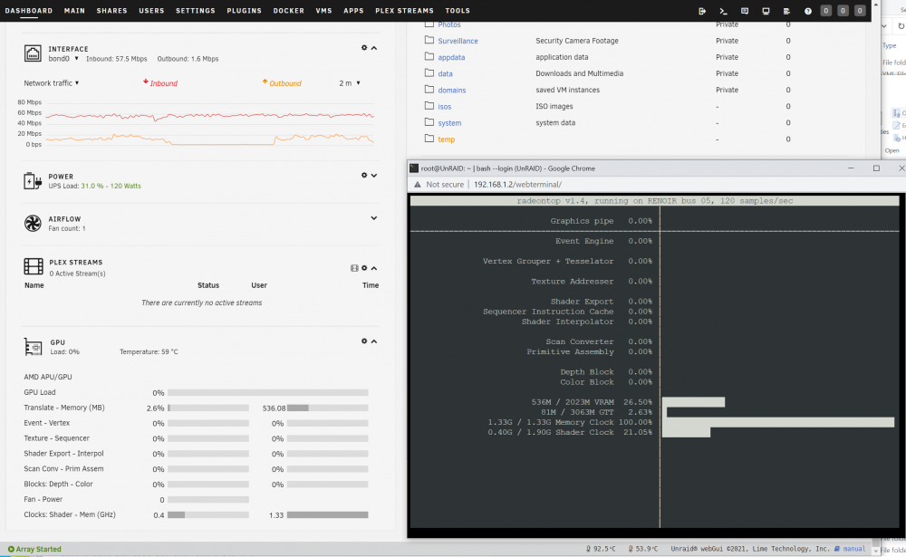

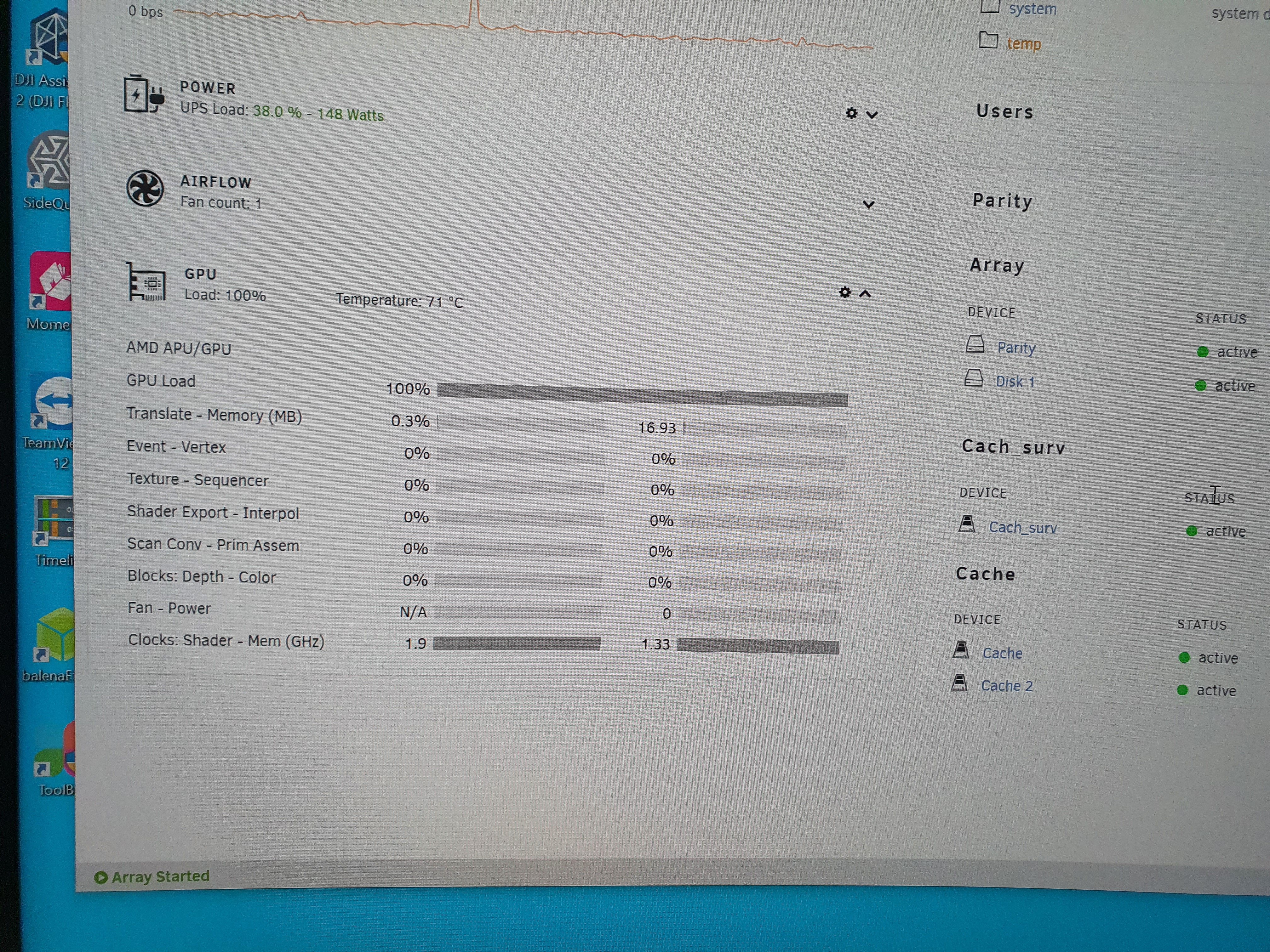

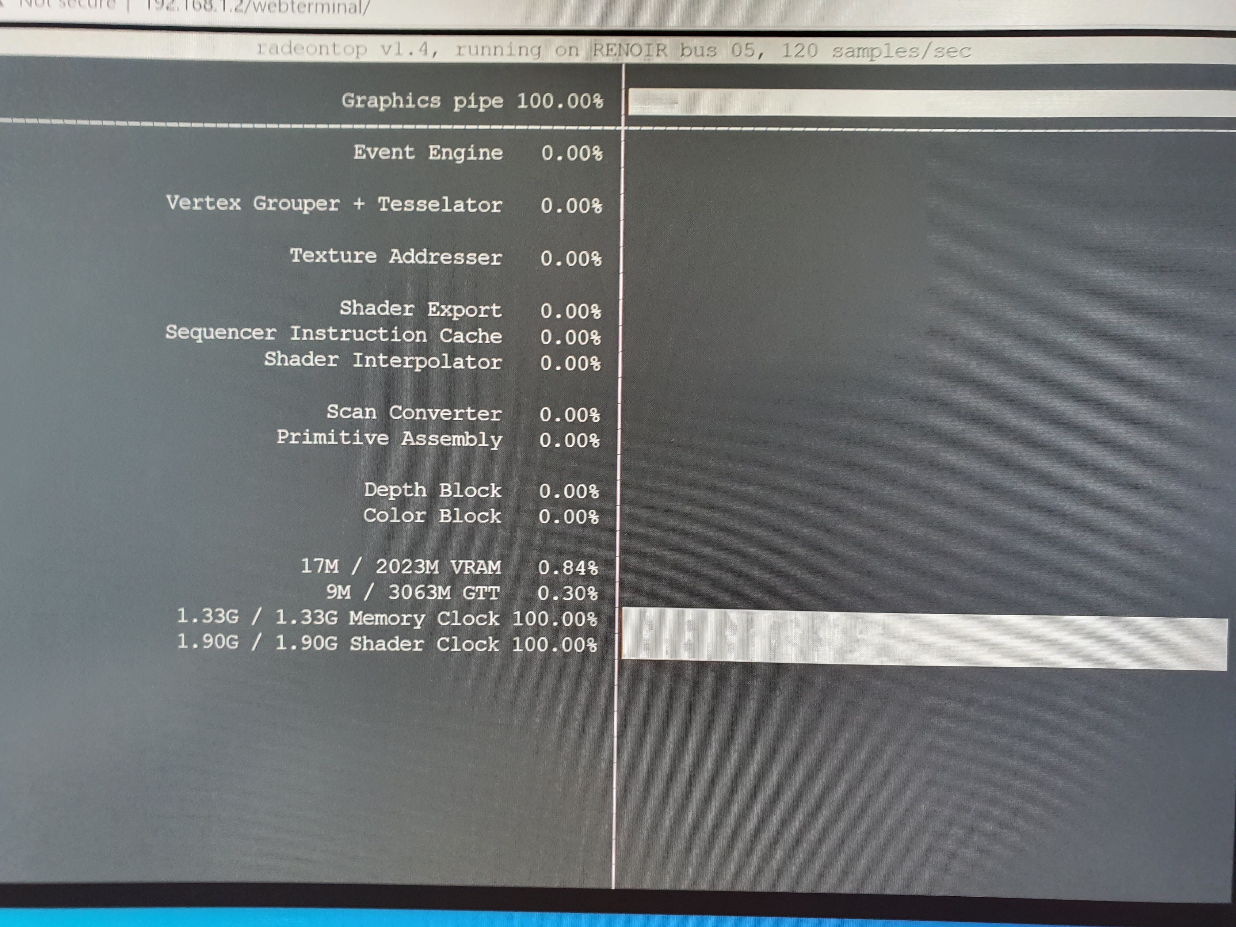

Radeon Top plugin
After a while running frigate with AMD hardware acceleration, the GPU utilisation goes to 100%. Frigate still works, unmanic still works with HW decoding, but it indicates 100% usage (added a couple screenshots). Is it actually at 100% usage, or am i running into an issue? After a reboot it comes back to normal (about 8% usage for frigate, going up to ~80% with frigate and unmanic going).
i have noticed some instability with frigate in general, so have just reverted back to using CPU only there. unmanic appears fine though, even when it says the GPU is at 100%
HW:
AMD 5600G CPU
16GB RAM
Unraid version 6.10 RC2
Thanks for the help

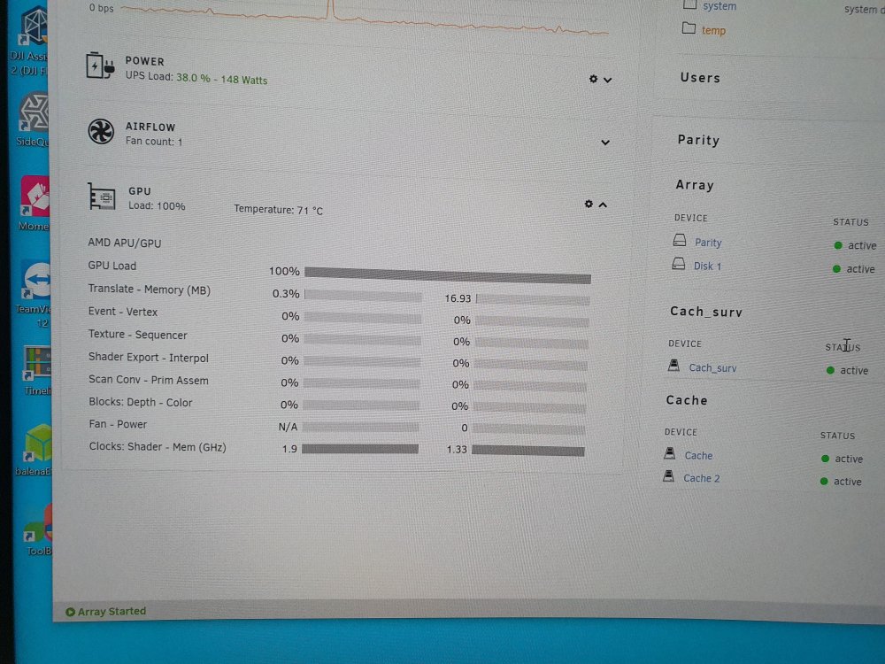

Sorry for the poor quality pictures, I was in a hurry out the door
It could be an issue but I don't think so.
What if you turn off HW transcoding in Frigate in general and only transcode with unmanic, does the same thing happen if yes, can you also turn on HW transcoding in Frigate and turn it off in unmanic?
I think there could be an issue with one of the two applications and not with radeontop.
HW transcoding will still work when it's at 100% but it should be a little slower than usual.

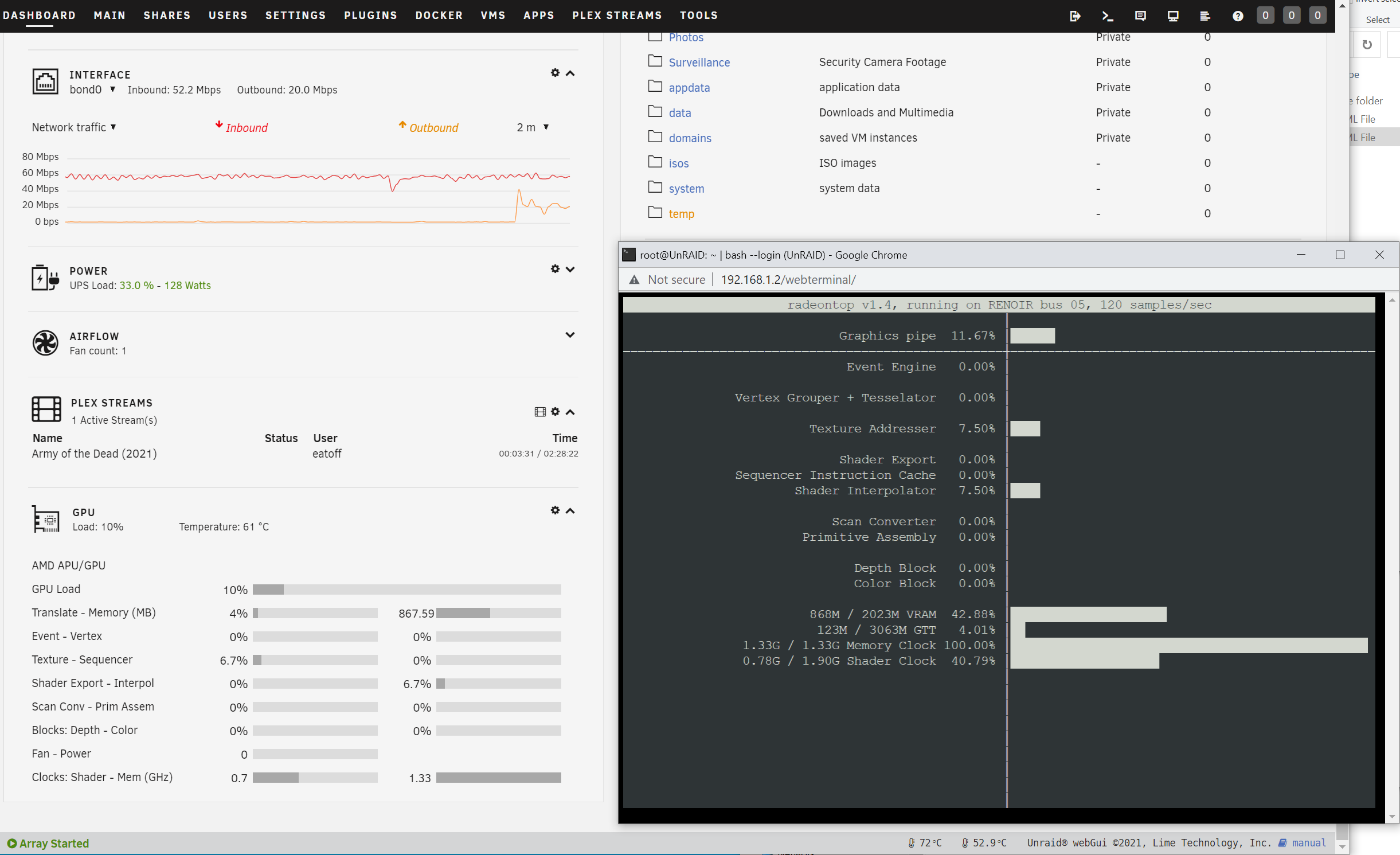

So, its been 24hrs after swtiching Frigate to CPU only, and letting plex and unmanic have at the GPU. GPU usage appears to be correct, drops to 0% when nothing is being transcoded, and shows up to 15% usage while trancoding in Plex.
Looks like it could be a Frigate issue. but when it was hitting 100% it needed a restart of the unraid system (not just the frigate docker) to get it to return to normal.
EDIT: to add, the CPU is a 5600G, integrated AMD graphics, are these drivers the latest and greatest for that?

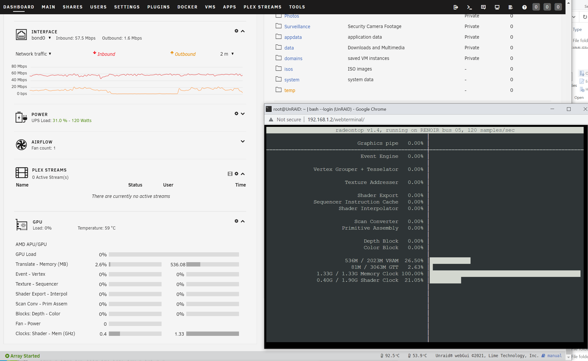

Added an image of what I'm seeing with unmanic doing a transcode for a h.264 file to h.265 - Indicates GPU usage at 0% now. i was certain it showed roughly 80% usage when it was running unmanic.
And here is a pic with both Plex transcoding and Unmanic running (just for info)
Edited by eatoff
The "drivers" are included in the Kernel so you technically don't have to install anything.
Maybe the next update from unRAID with a new Kernel version will solve the issue.
Also radeontop only enables the driver and installs radeontop itself so you can see the usage from your GPU nothing more.
But I really don't know if Frigate fully supports AMD iGPUs or better speaking APUs.
Maybe it transcodes audio first and then starts to transcode video or vice versa...?

correct. I have connected a monitor (most of the time off), right.
Can you try to let it turned on amd see if the same happens again?
Also make sure that you are on the latest BIOS version.
Have you yet tried to enable the Kernel module by hand if it's the same because basically what the Intel GPU TOP plugin does is enable the i915 module and install the application intel_gpu_top from intel_gpu_tools
When monitor is turned on, it seems that no errors come up (so far). Do you know the background of this behaviour? What would be the best workaround to keep the monitor off and to have the possiblity to use the console.
I will do a bios update today.
Thanks for your hints so far.
