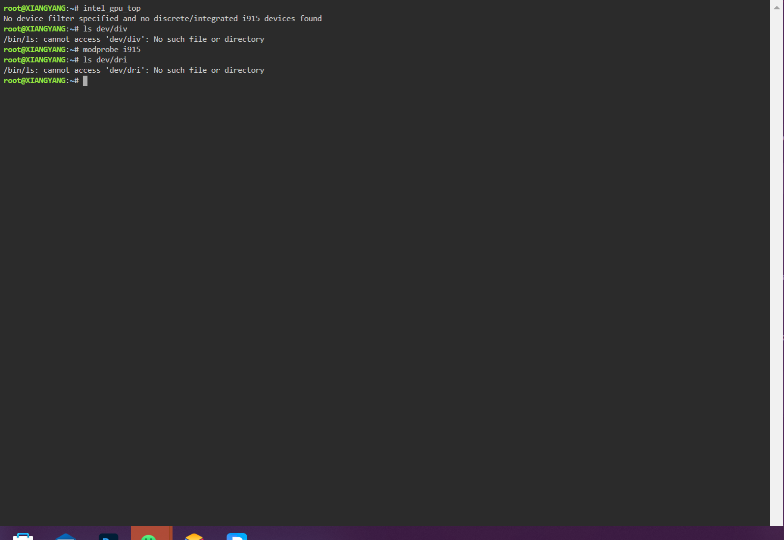

I've been trying to get my iGPU working so I can use HW transcoding in Plex for days now and nothing I seem to do works.
https://forums.unraid.net/topic/92865-support-ich777-amd-vendor-reset-coraltpu-hpsahba/?do=findComment&comment=1076014
That is the latest thing I've tried to follow. I even unplugged a monitor from my GPU and plugged one in via HDMI to my MOBO and I still get
No device filter specified and no discrete/integrated i915 devices found
when I run the "intel_top_gpu" command. And this doesn't even get me to pointing my Plex docker container at the iGPU for HW transcoding... I've attached my diagnostics so any help someone can provide me would be much appreciated.
tower-diagnostics-20220206-0905.zip
I don't see your Intel iGPU in your System devices.
Please make sure that you've set the iGPU to the promary graphics device in your BIOS and try to plug the Monitor in you Motherboard before you boot and see if you get a display output.
On my motherboard a Monitor must be plugged in the motherboard to activate it even if I set it to the primary display output when a dedicated GPU is installed, otherwise the iGPU won't be activated (bought a HDMI Dummy Plug for that purpouse).
I found an old DVI-D monitor laying around and plugged it in. That seemed to do the trick for activating it.image.png.a4d289d8e0cd5b13366eb71f6efc2a83.png
Now I just have to purchase the dummy plug as a longer term solution and figure out why Plex won't utilize it for HW transcoding. Thanks for your help!
For anyone stumbling across this in the future, I'm running an i5-6600 with an Asus H170-E D3 motherboard.

appreciating ur job first
but i still got some trouble
after i installed the plugin, my igpu still not working
typing 'intel_gpu_top' in the terminal , there is ‘No device filter specified and no discrete/integrated i915 devices found’
BTW my cpu is intel pentium g7400
Can you please post your Diagnostics?
If I'm not mistaken this is a Alder Lake CPU.
Are you on the lates RC from unRAID?
Please keep in mind that this CPU or at least the iGPU or better speaking Alder Lake is not fully supported in unRAID/Linux and also can cause crashes from the Server itself.

thx for answering me
this is Alder Lake CPU. no wonder the code 'modprobe i915' didn't work.
so all i can do is waiting till the Alder Lake fully supported, right?
Please post your Diagnostics so that I can go through the logs and also take a closer look why it fails.
