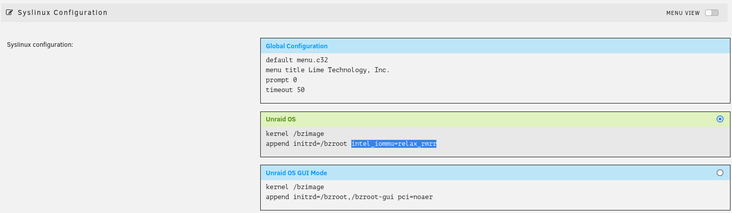

Thank you for letting me know I just need to add intel_iommu=relax_rmrr to my syslinux.cfg but if I click the link to github that you provided the syslinux.cfg looks completely different to mine? do I just put intel_iommu=relax_rmrr at the end? I cannot find any documentation for this?
This is my syslinux.cfg

56 minutes ago, mbc0 said:
I cannot see the changelog link?
Because I've quoted the part from the RC3 Changelog where it says that it's now part of Unraid itself, anyways here is the link: Click
57 minutes ago, mbc0 said:
I went from this post
Those two posts are now also deprecated because it's part of Unraid itself.
Go to the Unraid "Main" tab -> click on your USB Boot device (blue text "flash") -> at the green Syslinux configuration add this (just add it if you have any other things there):
Click on the bottom on "Apply" and reboot your server.
Thank you, that makes sense now 🙂
