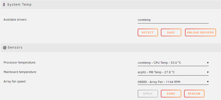

Thank ICH777 for the modified plugin for IT87 !!!!
I dont know how to use it, BUT thank you haha :D
Install it and try to click detect in the Dynamix Temp Plugin.
I installed it, i had to restart my server and MAGIC i saw the good temp and i can control my fan now :)
Thank you for your work !!

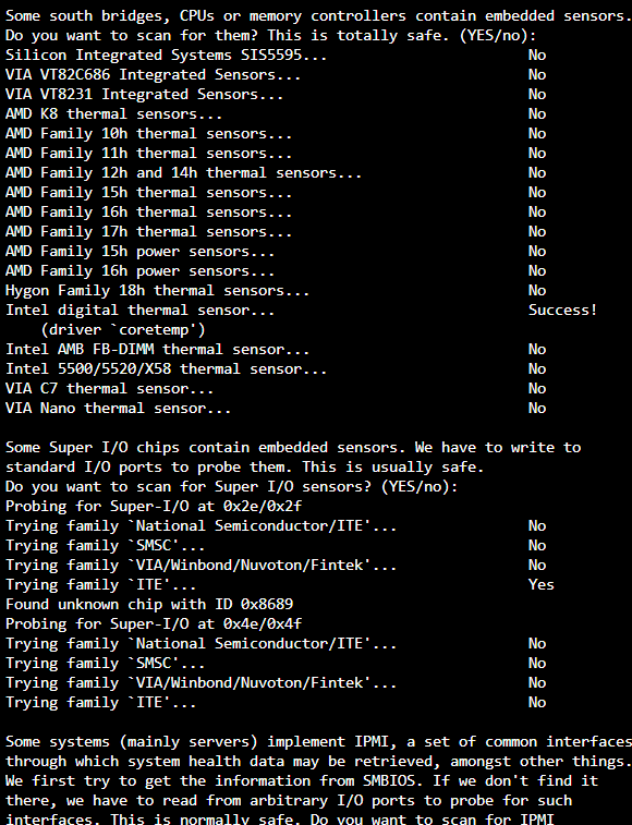

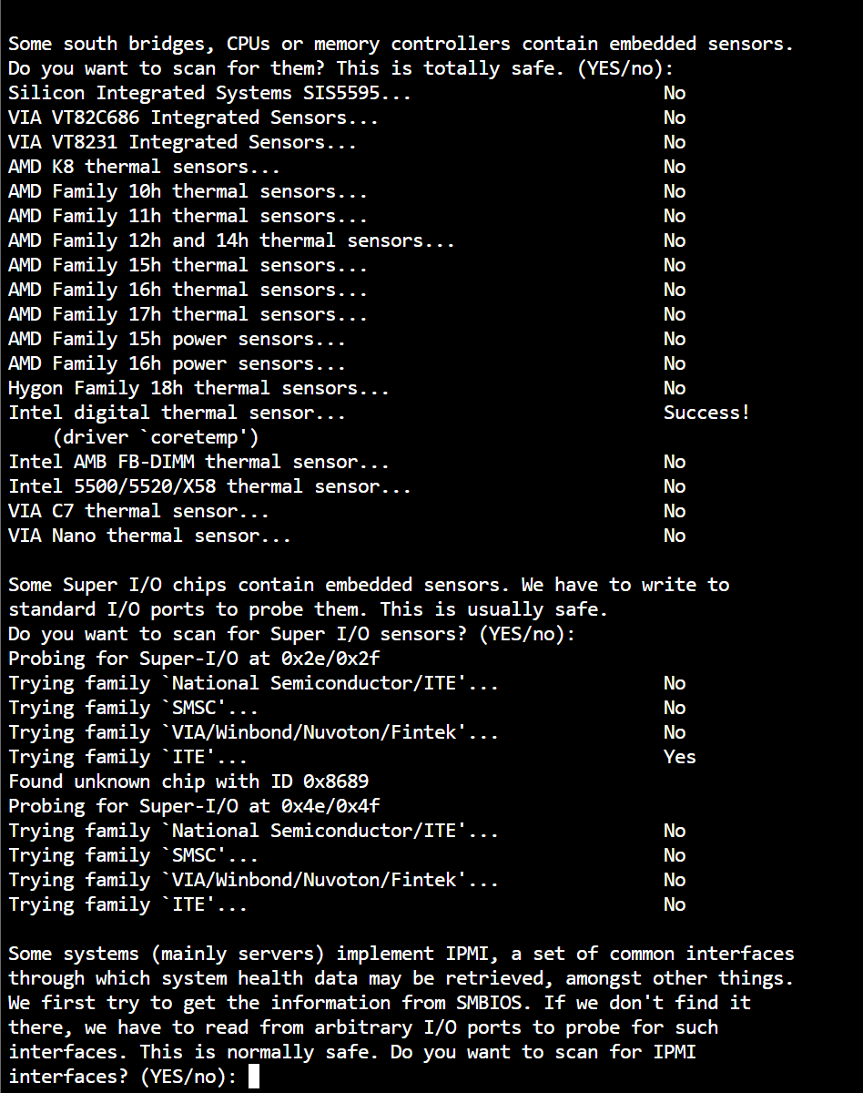

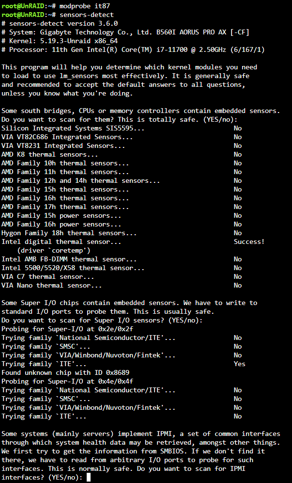

I'm running a Gigabyte Aorus B560I, I have set the same parameters as you in the syslinux, but my Dynamix System Temps still only has coretemp.
When I run sensors-detect I get this:
I had a previous workaround where I added "modprobe it87 force_id=0x8628" to the go file, which gave me the fan speeds, but no fan control. Instead of using force_id=0x8689 should I be using 8628? I cant actually remember where i found 8628, it was some time ago. I figured when looking at the sensors detect showing 8689 then that should be what I used...
Please add it87.force_id=0x8628 to the syslinux.conf and remove the line from your go file and reboot afterwards, after that run sensors detect.
In your case I would recommend that you use:
it87.force_id=0x8689
in your syslinux.conf because you have a different board/chip than @PsychoRS.

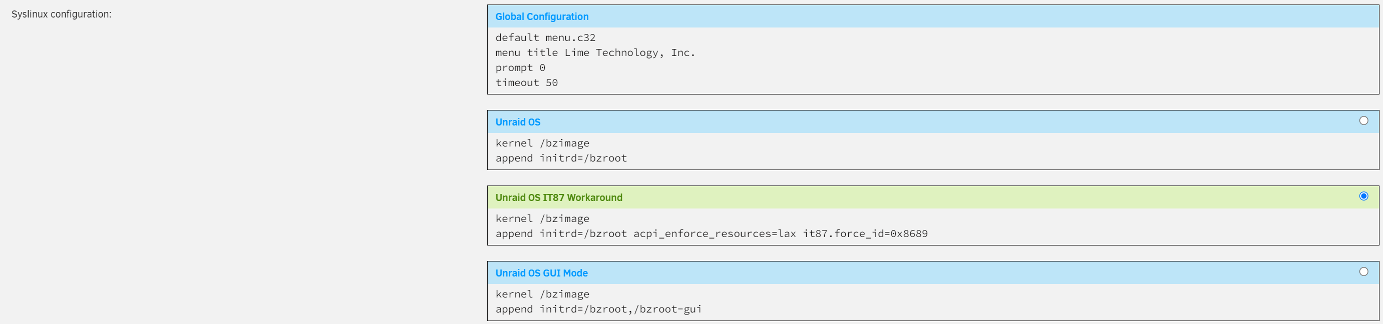

Done this, I had already removed anything from the go file, but changed the syslinux.conf to 8628
Unfortunately, still the same result:
Did I have it in the correct place in my first screenshot? straight after "resources=lax"?
EDIT FOR CLARITY: I have now tried it87.force_id=0x8628 and it87.force_id=0x8689 with the same result.
Edited by eatoff
This doesn't matter where you put it since it's only passed over to the modules/kernel itself and he knows then what to do, no matter what order you place it.
It would be better to change it to your hardware ID which is 0x8689
Please post your Diagnostics.
Done.

Please try to load the module from the command line with:
modprobe it87
and try to run Detect again.
On 9/13/2022 at 3:37 PM, ich777 said:
Have you also rebooted?
modprobe it87
Yeah, I have rebooted after every change to the sysconfig file.
This is my result:
This now does have the fans available in the system temp:
When i Detect for available drivers, nothing comes up apart from coretemp. Am I going to have to modprobe at startup each time to get this working? Or maybe this was working previously, but i was expecting it to come up with the detect button. I'll admit i didnt check the fan speed options since i saw it wasnt picking up the driver module in the available drivers section.
EDIT: After a reboot, I DO need to modprobe it87 otherwise all the sensors disappear on a reboot.
Follow up EDIT: REMOVED, modprobe is required after a reboot
