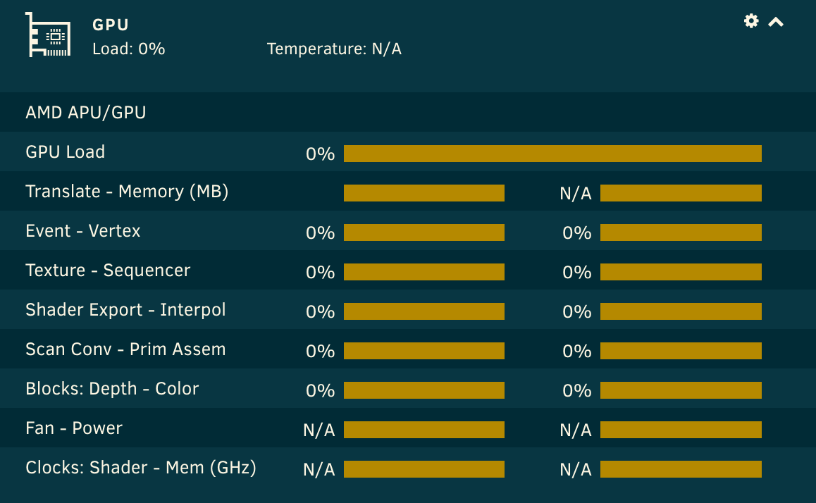

22 hours ago, ich777 said:
Where is the error?
This is looking perfectly fine, nothing is using your GPU...
You can post images here too, just copy it to the clipboard and paste it here. ;)
Have you passed over the device /dev/dri in your container template to the container?
Is Plex now supporting AMD GPU transcoding?
I would recommend that you post this in the appropriate Plex thread because the card is recognized fine and I can imagine that the path /dev/dri do indeed exist on Unraid itself (...otherwise the card won't show up in radeontop).

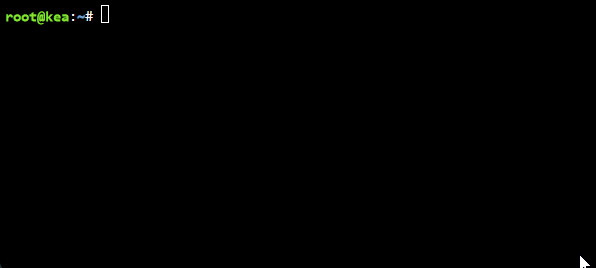

The error when running radeontop from command line is "Failed to open DRM node, no VRAM support." I think zeroes across the board still is fishy because I'm also not getting any sensor data, but I'm not sure if that's normal or not.
I've passed /dev/dri to containers I've tried testing hardware acceleration, but there is only "card0" and no "renderD128" which I understand is required for transcoding?
radeontop -p /dev/dri/card0 returns "Unsupported driver ast" (ast2500) so the amd card is not showing up in /dev/dri
I think my issue may be related to my IPMI, which has an Aspeed AST2500 with onboard graphics. I'm researching this thread where someone has a similar issue: https://forums.unraid.net/topic/72829-hardware-transcoding-plex-transcoding-not-working-renderd128-missing/?do=findComment&comment=669903 However this user has an intel igpu instead of a dedicated amd gpu.
Tomorrow I'll try messing with bios and IPMI VGA settings to see if it makes a difference. I will edit this post if I find a solution.
At this point I don't think it's a plex specific issue (I've tried several docker containers that support hardware acceleration) so I don't want to post in that thread just yet, but I recognize the radeontop plugin is likely not the cause of my problem.
I don't see that in your screenshot from above. Is this the exact message?
Have you already unbound the card from VFIO and rebooted your server?
Also don't forget that radeontop is based on this GitHub repository and I compile this from time to time from the latest master because this repository doesn't follow a strict release cycle (last release was almost a year ago I think).
In other words, radeontop is no indication that you GPU is working or not.

Yes. It appears before the terminal shows the graph. Here's a gif firefox_fJKO9WvRcB.gif.b071b6f90c0577959b9429c079c1ab9f.gif

I thought card0 was my card, but just in case I tried to force radeontop to use card0 with that command, but when I got "unsupported driver ast" I realized maybe the AST2500 card is showing up as card0. Here is ls -la /dev/dri

I got it working! Turns out the card0 is the AST2500, and for some reason even though the 5700xt was showing up fine in lspci and in unraid "system devices" it wasn't showing up in /dev/dri. After swapping around a lot of bios settings, I now have card0 showing up (AST2500) and card1 (5700xt) both showing up, and am able to pass card1 to containers. /dev/dri/renderd128 now also shows up for vaapi encoding.
This IPMI is very finicky. The bios settings I changed were:
SR-IOV Support: disabled
Prioritize onboard video instead of PCIe: enabled
Onboard VGA: from [Auto] to enabled (enabled for some reason is required for the OS to recognize the 5700xt, but also makes the machine take about 2 minutes to post and start displaying video, very odd. I also don't have access to IPMI remote control, which kind of sucks but at least GPU is recognized.)

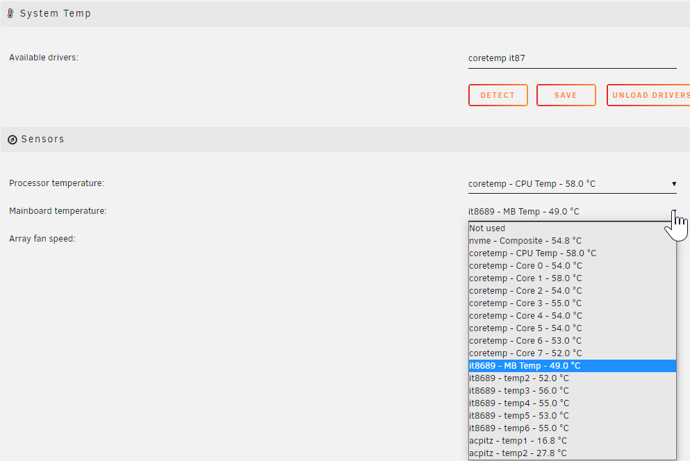

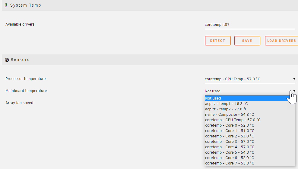

On 9/17/2022 at 10:29 AM, Frank Crawford said:
Folks,
I'm currently maintaining the it87 driver that is now being pulled into your systems, and the current version supports the following chipsets: IT8603E, IT8606E, IT8607E, IT8613E, IT8620E, IT8622E, IT8623E, IT8625E, IT8628E, IT8528E, IT8655E, IT8665E, IT8686E, IT8688E, IT8689E, IT8695E, IT8705F, IT8712F, IT8716F, IT8718F, IT8720F, IT8721F, IT8726F, IT8728F, IT8732F, IT8736F, IT8738E, IT8758E, IT8771E, IT8772E, IT8781F, IT8782F, IT8783E/F, IT8786E, IT8790E, IT8792E, Sis950.
If you are have any of these chipsets, then you don't need to specify the "force_id" option any further.  If you do find you need it please contact me and I'll look at adding any missing chipsets, but it will depend on what details I can find.
Unfortunately, for some motherboards, which have multiple chipsets on board, you will need to add the option "ignore_resource_conflict=1" option, in place of the option "acpi_enforce_resources=lax" during the modprobe command, e.g.
for similar reasons, although it only affects the it87 module not others.
Good luck with the use of this module that various people have been improving over the years.
Welcome and thanks for your work, Frank. Your driver is working flawlessly on my Gigabyte B560M DS3H v2 (8689).
By the way, do you mean that "acpi_enforce_resources=lax" is not needed anymore?
Thanks

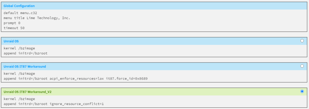

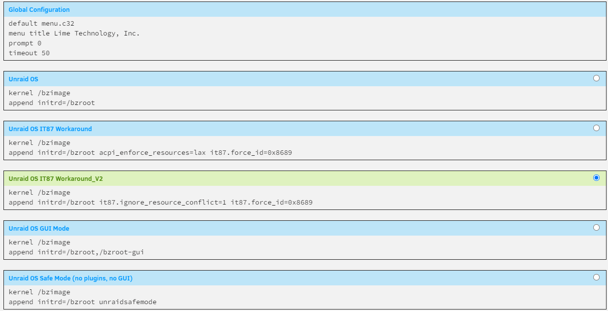

On 9/20/2022 at 12:21 PM, ich777 said:
I didn‘t saw that until now, do you append any extra options to the module?
Sorry, It all works now and survives a restart if I use the workaround options in the below screenshot. How i fixed it was by uninstalling the dynamix system temp plugin, rebooting, then re-installing. But according to Frank, I shouldnt need the acpi=lax or the force ID, hence the PM to get this sorted for others with the same hardware.
When i get a solution I will share it here.
Edited by eatoff
Shouldn't you rather use:
it87.ignore_resource_conflict=1
instead of the "lax" option?

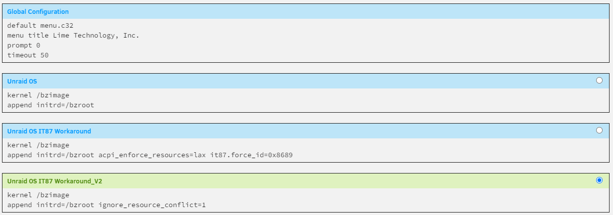

... really, did I miss that somewhere?
what I had in the workaround worked.
Do you mean change the workaround from:
acpi_enforce_resources=lax if87.force_id=0x8689
to only:
See here:
I think you need both, at least you can try:
it87.ignore_resource_conflict=1 it87.force_id=0x8689
I really don't like the "lax" option because you can introduce in certain conditions damage to the hardware...
8 minutes ago, ich777 said:
See here:
Just tried this one with no luck
This:
Also results in this:
Using that Workaround in my image does actually work. But according to Frank it shouldnt be needed, so am trying to work with him to get it resolved.

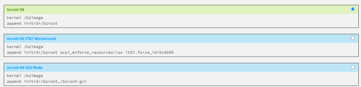

As I wrote above also append your probe.
Apologies, somehow I didnt read that last bit in your post.
To keep this thread up to speed, that did work. It now looks like:
And i now get:

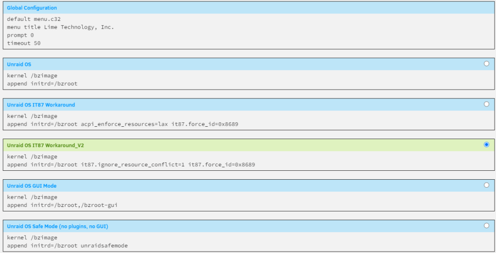

it87.ignore_resource_conflict=1 if87.force_id=0x8689
Just FYI, your code says if87.force_id=0x8689, should be it87.force_id=0x8689
Thanks again for all your help ich777
EDIT: I realise I wasn't clear, this setup does work for me. got rid of the lax argument
Edited by eatoff
I just copy pasted it from you... :D
Anyways, I will change that.
Nice, glad it's now sorted out.
