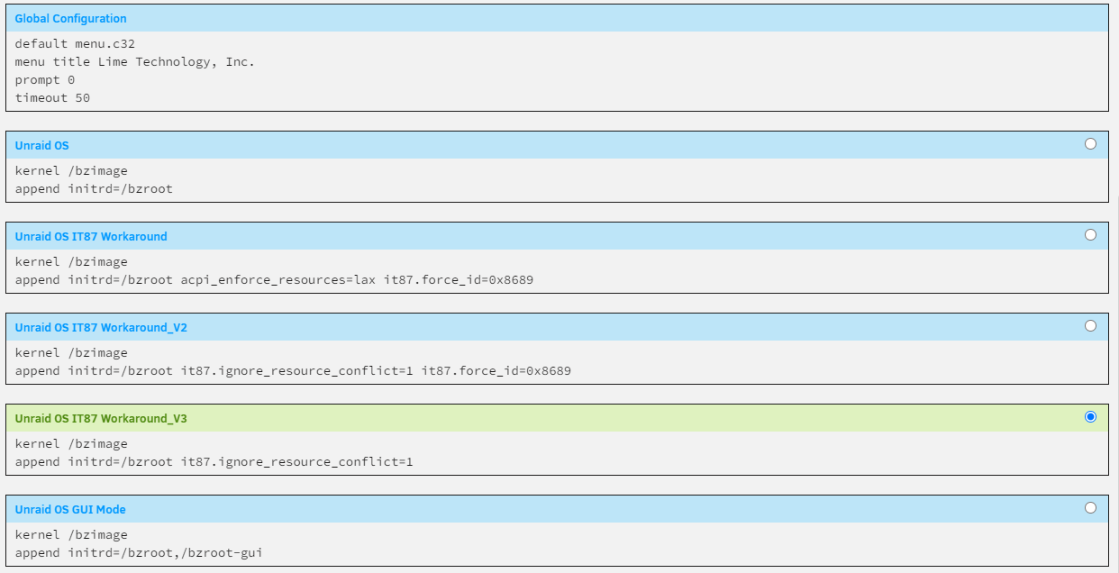

Final update for all those following along at home; I can just use the it87.ignore_resource_conflict=1 and it all works now (screenshot below). No need to force id as per the V2 in that screenshot. Most elegant solution (IMO).
Folks,
I don't read this list too often, so it may take me a while to respond, however, I will try to respond to DMs more quickly.
However, just to bring you up to date on a few changes and other notes,
  • firstly, with my driver it is better to use it87.ignore_resource_conflict=1 rather than acpi_enforce_resource=lax
  • however, the latest version doesn't even need that for boards I know it is safe for (unfortunately mainly ones I have direct access to currently).  More will be added as I get more information from people.
  • we are working on getting all this into the mainline, but it will be a very slow process, probably taking a year or more to see it get out.
  • and finally, I've looked at sensors-detect and realised it only works properly for chips in the mainline module, not mine, as it just lists all the chipsets I have added as "to-be-written".
So, how you can help is if you do find a sensor that is not currently supported, let me know and I'll see what can be done.
Secondly, if you find a board that still needs it87.ignore_resource_conflict=1 let me know the board time and the sensors that you are seeing and I'll look at adding it .
Regards
Frank

My system temp work perfect on 6.10.3 version.
its thanks to ich777!!!
but when I upgrade from 6.10.3 to 6.11.1,
using nerd tools that including perl driver.
my boot option still using
"it87.ignore_resource_conflict=1 it87.force_id=0x8689"
but it no show anything motherboard temp from my ite-8689 chip.
i try using "it87.ignore_resource_conflict=1" to boot, still no work.
is anybody same with me?
