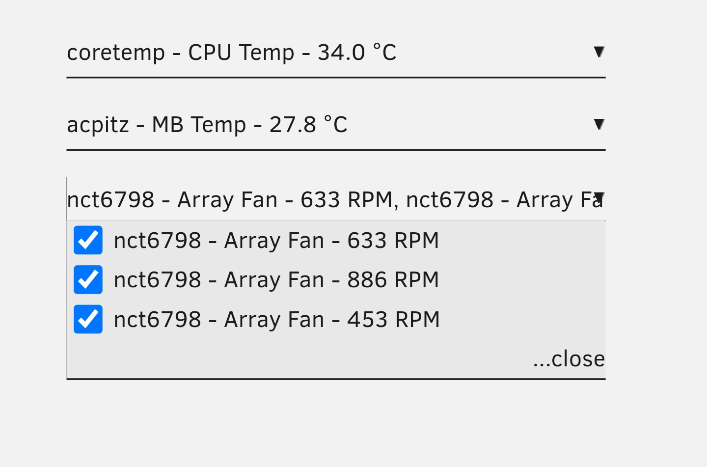

8 hours ago, ich777 said:
You can however pass:
acpi_enforce_resources=lax
That has allowed me to see NTC6798 Fan arrays. Do you know why 'lax' is required to be set to view this device?
Now we know it is a 6798, can this is achieved a different way with less hardware risk?
