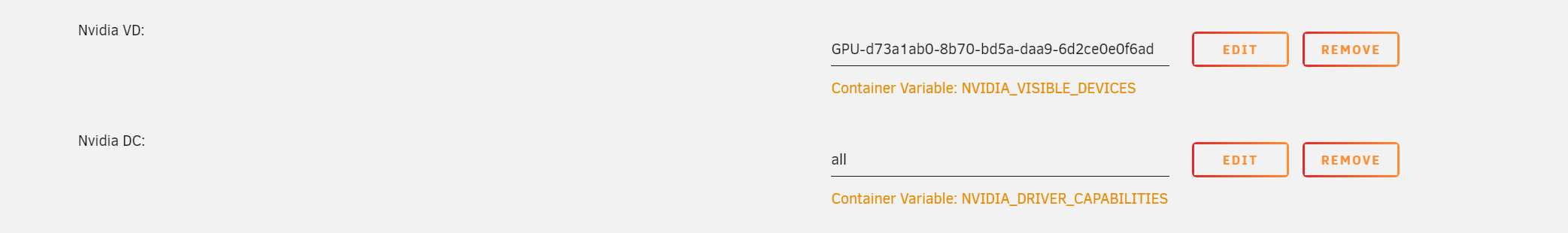

I'm guessing i'll have to adjust the plex docker since i have it like this now
Just remove Nvidia VD and Nvidia DC
and under Extra Parameters Remove that and put in --restart unless-stopped --device /dev/dri:/dev/dri
Sound about right?
Yes.
You can leave the other two variables NVIDIA_VISIBLE_DEVICES and NVIDIA_DRIVER_CAPABILITIES in, they don't do anything if you remove --runtime=nvidia

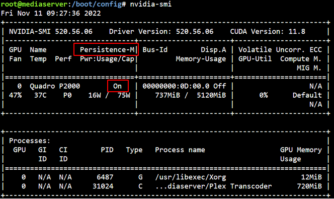

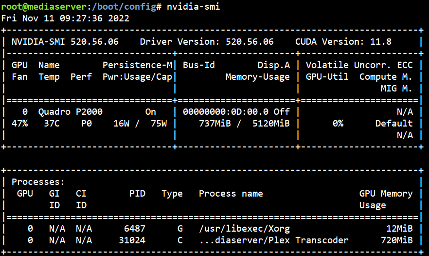

Hey ich777,
How do you know persistence mode is running,
Here is a snippet after I run the command
Here:
But I see that you are booting in GUI mode, then nvidia-persistenced should not be necessary...
P8 will only be enabled if you don't transcode and it will take a little bit of time so that it falls back to that state.
nvidia-persistenced should be only necessary if you boot Unraid CLI only.
