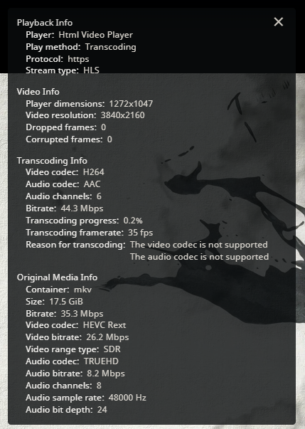

@ich777
Here is the video playback info. My client is Edge html client. I found the cpu usage will still keep high until the video stop. Only this video take so much cpu resource34ED888A.png.753b1513778d3330b1035b16b7647289.png

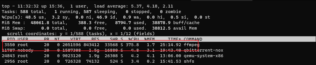

No. I top the shell and ffmpeg keep the cpu usage.
When I pause the video, the usage get down, but when I play, usage come back. Maybe my pause time not enough?
This is really strange, Jellyfin usually should release the CPU after ending the playback however pausing the movie should not stop transcoding.
I would recommend that you post over on the Jellyfin GitHub Issue tracker about that: Click

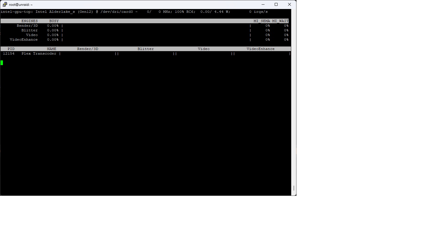

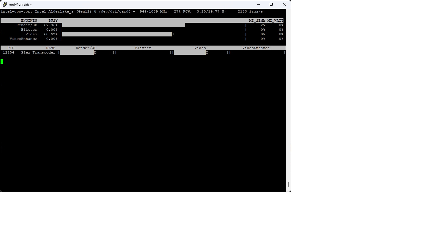

Hi. While testing transcoding I see this strange behavior with "intel_gpu_top'" and similar in the Dashboard plugin: usage is shown for a second then dissapears and goes to zero for longer time and then shows some usage and so on. Plex dashboard shows HW transcoding, cpu usage quite low, from 2 to 14% max.
What going on? :D
1 hour ago, yanakis said:
What going on? :D
Your iGPU is transcoding…
What is wrong or what do you think isn‘t working?
In Plex throttling is enabled by default and this causes such behavior, but pleasr let it enabled, it‘s enabled for a reason…

I know is transcoding, that's why I have this setup but to me it seems it does not transcode in continuous mode...again, both GPU dasboard plugin and intel top gpu app shows usage for 1-2 seconds then all parameters go to 0 then after 5-6 seconds gpu usage appears again then go to zero...
Yes, because as I wrote, throttlig is enabled in Plex.
BTW that is not an issue at all and this question would be better suited in the Plex support thread, but this is default behavior.
As said above, expected behavior.

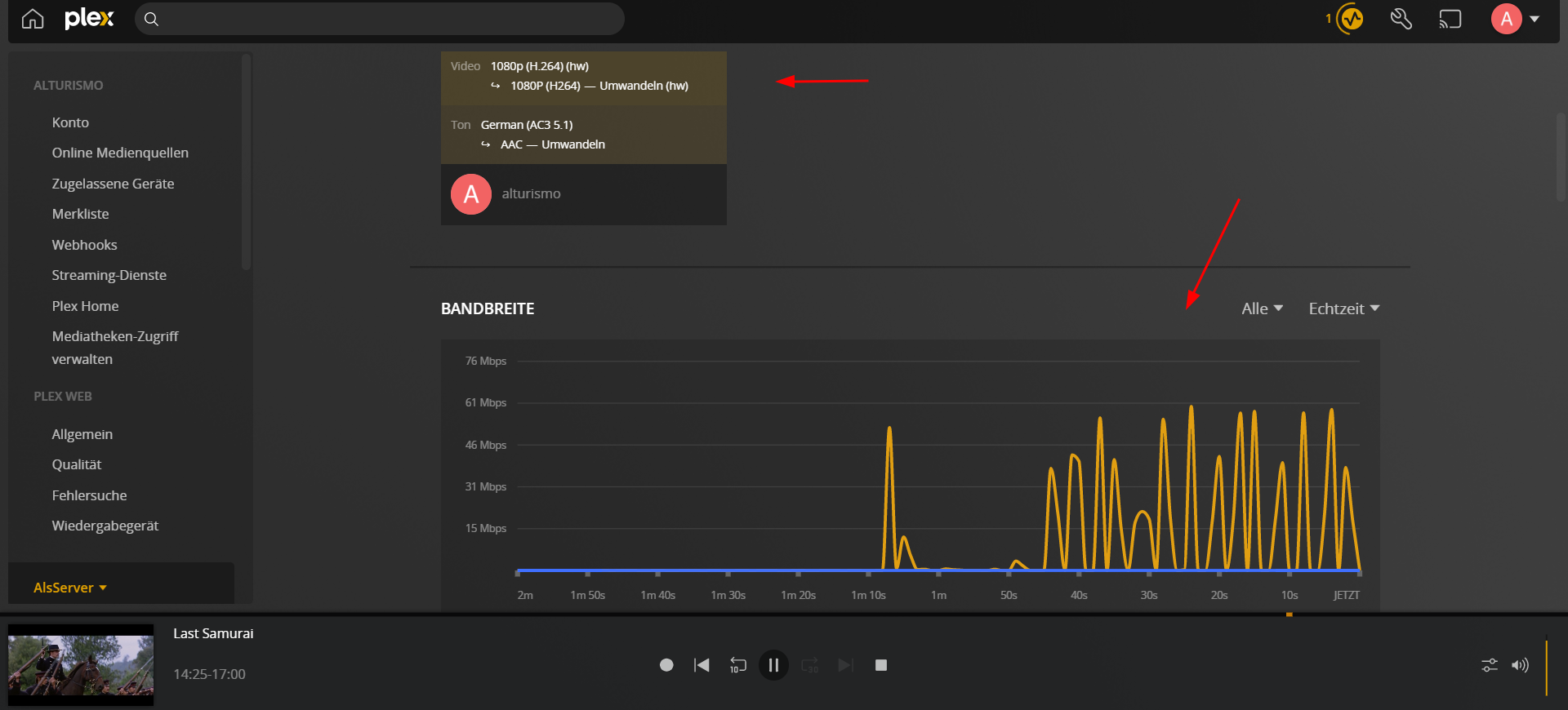

16 minutes ago, yanakis said:
Can I upload a video in here?
i dont think anyone needs a video here from a working and normal behaviour ;)
may to give you an idea about Plex, its working in chunks and not transcoding the whole video in one run to the end ... so a "heartbeat" behaviour is normal, if you want to see another behaviour, install ffmpeg, read how to use it and you will see a steady running 100% encode process ;)
also, i guess you are in the wrong thread overall ?
Ok I see :), I got the same "heart beat" profile, must be fine after all.

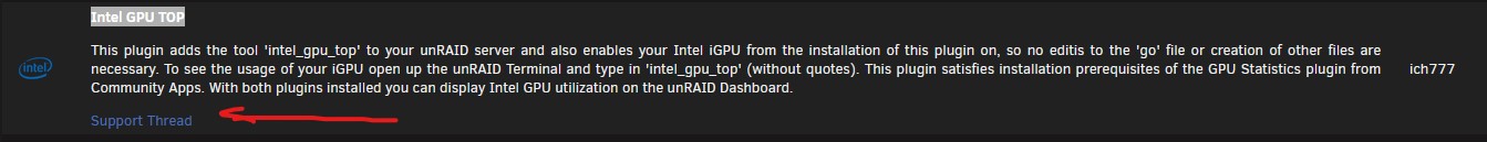

Well, about the thread: I just pressed the "support" link from "Intel GPU TOP" plugin because I started from its "issue" :).
Sorry if I am in the wrong thread and many thanks for your clarifications.
But why should this be an issue with intel_gpu_top? Your issue is related to Plex…
