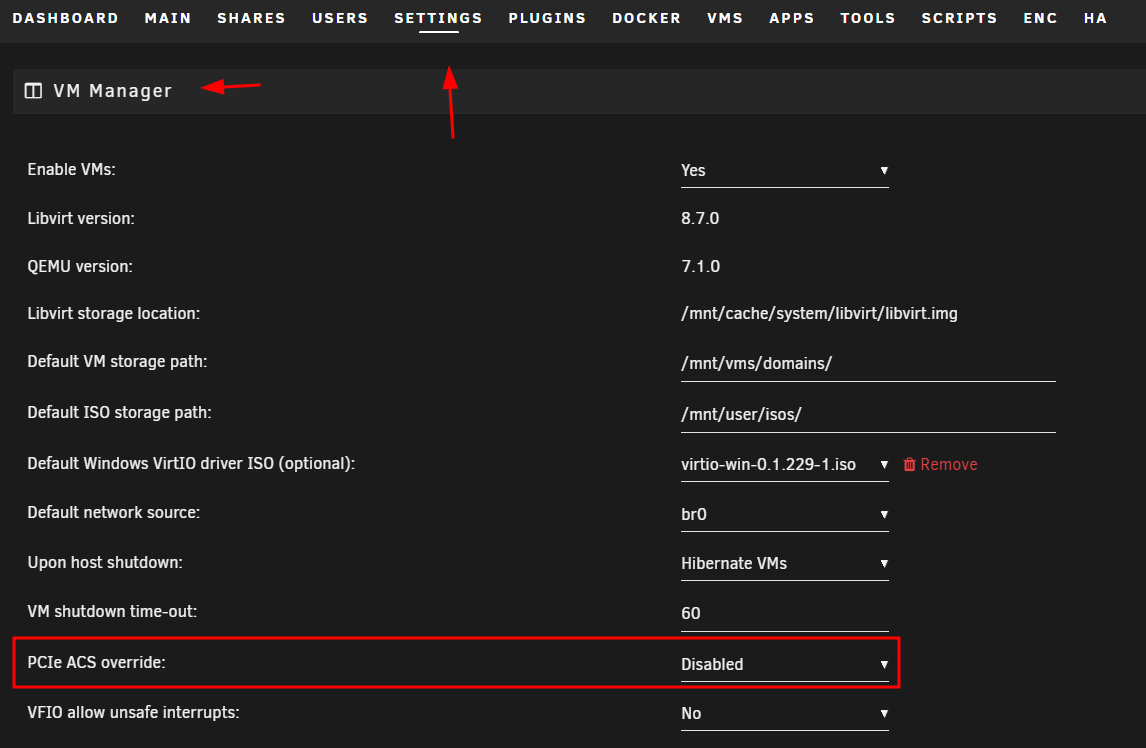

Hi all, just noticed my OpenRGB patch stopped working, after some troubleshooting I realised it was due to the recent setting up of my 1st ever VM (steep learning curve that 1....lol)
Basically once I bound my onboard Intel sound card to VFIO it stopped the patch from working, which makes total sense as SMbus & Serial Bus controller are in the same IOMMU group that is being passed through.
I tried a few thing to free up resources for the Patch via modifying the syslinux config, but to no avail, those being:
"modprobe.blacklist=i2c_i801,i2c_smbus" and unbinding the IOMMU group and binding only the sound device via "vfio-pci.ids=8086:43c8"
So my question is can I utilise both at the same time?
Edited by wacko37
1st i would move to the proper forum part, this is more a virtualisation point then this plugin.
as starter, play with these settings and see if you can get them seperated, be aware in terms of passthrough's, the addressing will change ... so current passthrough's will most likely break and have to be reassigned.
also read the help text what it does ... can be useful, but not always ending up good ;)
and then rather ask in the virtualisation part from the forum.

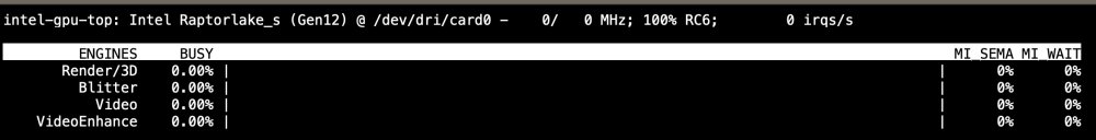

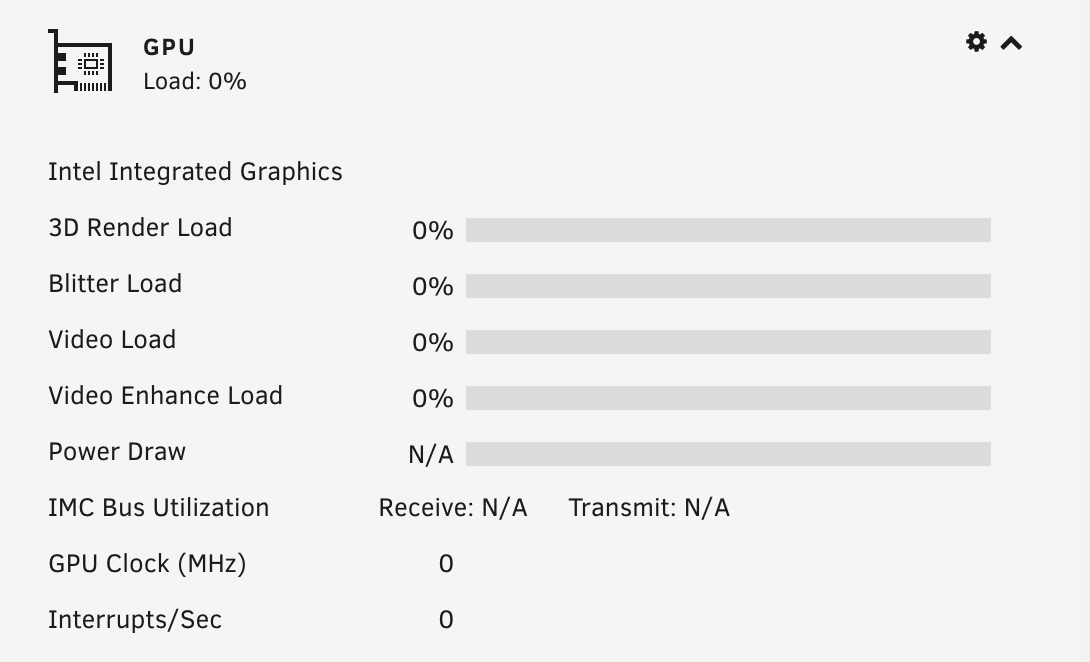

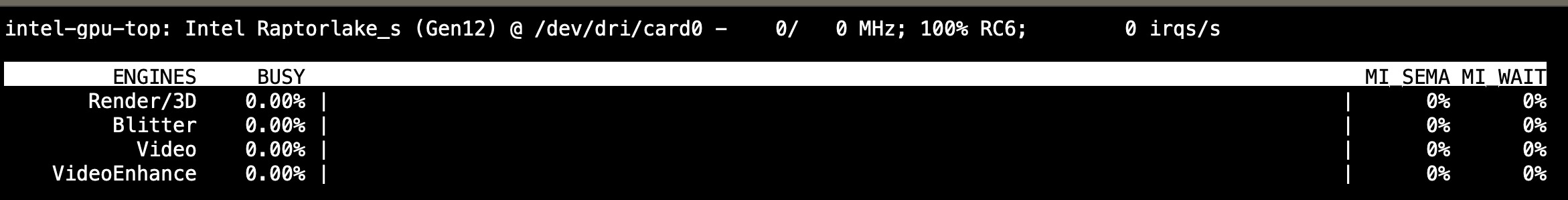

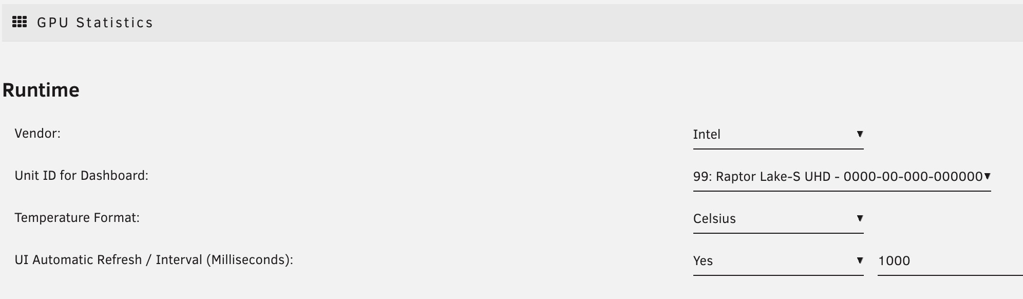

Does this support 13th gen Intel yet? I know there should be little change but I'm getting no stats - and it says Gen12.
- Asus W680 board
- i7 13th gen cpu
- unRaid 6.11.5 (latest stable)
intel_gpu_top.thumb.jpg.2e4acecbbdfa66a265bce7dcac97b6fd.jpg834278031_GPUstatistics-settings.thumb.jpg.b529af728c638dee186fcd6ed2d8e2f7.jpg
filestor-diagnostics-20230306-0813.zip
Yes, because your iGPU is 12th gen and not 13th gen (intel_gpu_top always displays the generation from the iGPU and not from the CPU and yes, the can be different :D ).
For example my i5-10600 (10th gen CPU) has a 9th gen iGPU built in:
intel-gpu-top: Intel Cometlake (Gen9) @ /dev/dri/card0
Is something transcoding on your iGPU or using your iGPU? If not nothing would be displayed because the GPU is basically in render standby (RC6) as you can see on top.
IMC bus utilization is not supported by all CPUs, basically the same as if you have a Nvidia GPU, not all metrics are supported by all cards or better speaking by nvidia-smi.
