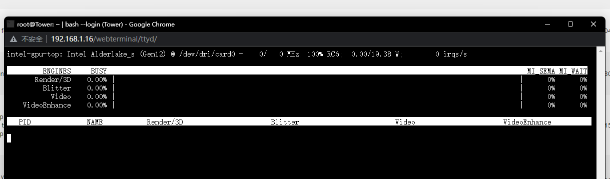

May I know why it is showing all zeros.  Tons of thanks, FYI im using intel 12400
are you currently using the igpu with an transcode as sample ? if not ... why shouldnt it be 0 ;)
Because nothing is using the iGPU.
Put some load on the iGPU and you will see that it won't show zero anymore.
I used windows vms and jellyfin to watch live stream but it still shows zeros
Are you really sure that Jellyfin is configured properly so that transcoding is working?
This is usually a indicator that transcoding is not working.
Please post in the corresponding support thread from your Jellyfin container.
BTW I would strongly recommend that you use the official Jellyfin container.
From what I see the Intel GPU TOP plugin is working fine and doing it‘s job as it should.
windows vm > only when using gvt-g would trigger the igpu ...
jellyfin > may try playing in the browser, enable transcode or use a mobile device not in LAN, should force transcode too
I have set this in jellyfin also try playing non-original resolution in web browser, but still all zeros. Im so confused. Is there any docker heavily relies on gpu for me to test with? Tons of thanks!
This is something for the Jellyfin support thread if it is not working since this has nothing to do with the Intel GPU TOP Plugin.
Make sure that you configure the iGPU also in Jellyfin at Playback and then force a transcode, simply watching something isn't enough because not all media need to be transcoded.
You also didn't answer if you are using the official container or a third party one.
