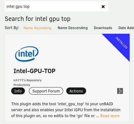

Apologies if this has been covered numerous times, but I cannot find the Intel-gpu-TOP plugin anywhere on CA anymore. Has it been removed or something?
Right there:
On what Unraid version are you? Maybe it's time for a upgrade. ;)
6 minutes ago, ich777 said:
Right there:
That is so strange as I cannot find it at all.
Unraid version (apols for the blown-out colour. Monitor is HDR):
CA Version:
Search:
*Facepalm* Just seen we're at 6.12.4 now. I'm so used to Windows updates with a pop-up.
Got it now! Cheers. Can't believe how out-of-date I was.
