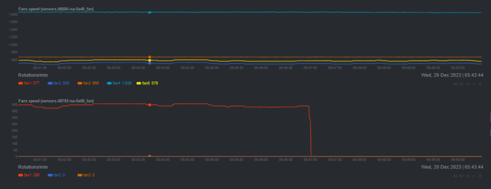

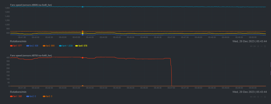

Apologies I stupidly restarted the server and could not get the diagnostics, I will have to wait a few hours for it to happen again and post back, all the fans are showing and reporting on the dash.
I still check the log and used the refrence time from netdata which showed when they turned off with nothing delayed
The fans on that particluar sensor have stopped twice in the past couple of days,
I have attached my current diagnostic and will report back as soon as I can,
Thanks
random-diagnostics-20231219-1523.zip
24 minutes ago, Random Mike said:
I hope this helps.
Nope, nothing in your logs.
Anyways,  please remove this line immediately from your syslinux.conf and reboot:
acpi_enforce_resources=lax
First of all this is really dangerous to your hardware and secondly that is not necessary with the IT87 plugin at all because it works completely differently!
If that issue persists after you removed that line I would recommend that you create a post in the Dynamix Autofan plugin support thread.
Will do, I removed Dynamix Autofan plugin and still same issue, and also tried with and without the acpi_enforce_resources=lax same issue, I moved my hard drive fans to the CPU OPT header on the other sensor and these all stayed on only the fan on sensor it8792 turned off.
I think I may have to move the remaining fan to the working sensor.
Are you sure that the sensors stop working? Did you ever issue sensors after the fans stopped spinning?
If the sensors are working properly this is more a Autofan issue than from the plugin/driver. However this is the first time that I hear from this issue and this could also indicated already a hardware failure.
Autofan is uninstalled, the fan stopped working again this moring with the sensor showing 0 rpm and just check it started back up again at 15:34. if I restart the server the fan spins up and is shown in bios as well as system temp or I can run pwmconfig and it will spin back up as well.
Have you yet tried to uninstall the IT87 plugin to?
Maybe it is not related to any plugin and is a hardware thing?
I will try that next, if i cant get it to work ill move it over to the other sensor, just thought it a bit random if its a hardware problem for the fan to run for hours and shut its self down and start again hours later, as mentioned pwmconfig will start it back up again.
I have added a screen shot of my sensors for extra information
Thanks for your help.
The IT87 plugin does nothing on it's own, it only installs and loads the driver.

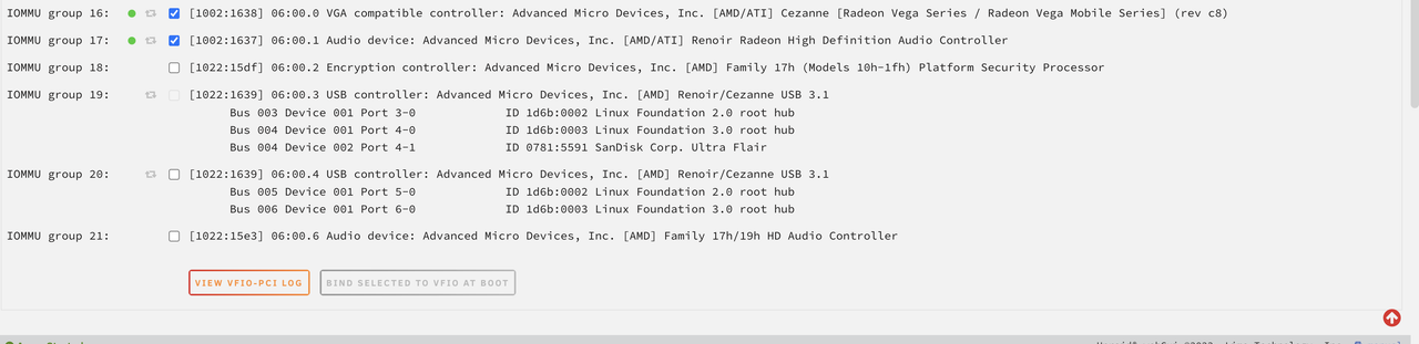

Hello there, and thank-you ich777 for your plugging and super hardwork.
I am trying to use hardware acceleration with gpu passthrough for my streaming Jellyfin docker image. I have been struggling now for many days and I am now seeking help from you guys.
What have I tried:
I have tried to go through many threads on Unraid forum or Reddit, but somewhat, many of them don't seem to be related to my setup. I found the following tutorial, and it seems close from my goal, but didn't work in the end. Somewhat, even after installing radeonTop plugging, the path /dev/dri doesn't exist. I have unRaid version 6.12.6, with AMD Ryzen 7 5700G.
You can fin bellow my PCI Devices and IOMMU Groups settings:
I also downloaded the gpu plugin, but as you can see, there is no data showing up
As I said, when I am doing:
nas:~# ls -al /dev/dri
/bin/ls: cannot access '/dev/dri': No such file or directory
What can be the next steps? Where can I go from here?
Thank-you so much for the help you can give me,
Cheers,
Arthur
Please unbind you iGPU from VFIO on the System page since if you bind it to VFIO Unraid can't "see" your iGPU because you reserve it for usage in VMs.
After unbinding it reboot and you will have the directory /dev/dri on your Server.
Please make sure that you are using the official one from the repository: jellyfin/jellyfin
Oh my god, it works !!! Thank-you so much 🤩.
I didn't have t use the `jellyfin/jellyfin` image, `lscr.io/linuxserver/jellyfin` works just fine as it is.
