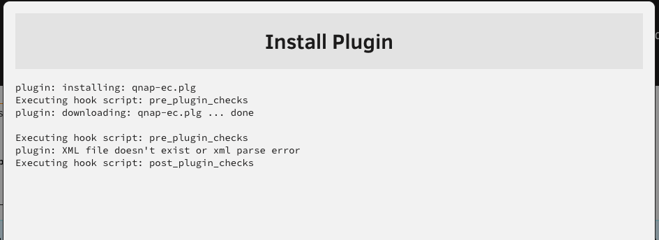

Hm, I'm having some trouble following a brief power outage. The plugin was working perfectly for me before the power outage. I did a clean reboot of my QNAP TS-464 NAS after the power came back up, and just noticed all my drives were running hot, and the box for the plugin on the dashboard was gone. I followed the setup instructions again, found that my fan seemed to have moved from hwmon3 to hwmon2, but I was getting permission errors when trying to write to pwm1.
I thought maybe a fresh install would be a good idea so I removed the plugin, and now I can't even reinstall it. When I look in the "Apps" section, the QNAP EC plugin is listed as "Pending" with no download button. When I try to install directly from Plugins > Install Plugin from the URL https://github.com/ich777/unraid-qnapec/blob/master/qnap-ec.plg, I get the error
plugin: XML file doesn't exist or xml parse error
Any idea what I can do to get the plugin reinstalled and running successfully again?
Thanks for the help!

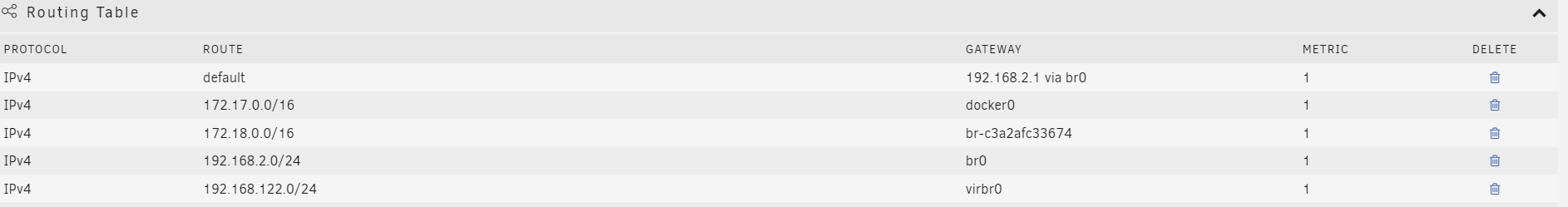

I just installed your rcon plugin to try and connect to my Palworld server. I can use an rcon client on my pc to connect to the server without a problem but when I do it from unraid i cannot connect.
If i change my palworld server network type to bridge then i can connect to it from unraid. But if i set it to Custom : br0 and have a static ip 192.168.2.205 i cannot connect to it from inside unraid.
Any help would be apreciated.
Please read this post:
I did, i found a temporary fix that that is to have the container set to Bridge and add
&& docker network connect --ip 192.168.2.205 br0 Palworld
this way i can still connect using 192.168.2.205 but i can also connect using rcon within unraid rcon -H 172.17.0.3 -p 25575 -P password.
I can connect from my desktop using rcon -H 192.168.2.205 -p 25575 -P password but in unraid i have to use con -H 172.17.0.3 -p 25575 -P password
Edited by SuperToaster
You could also enable Allow Host Access in the Docker settings to circumvent that.
May I ask why did you even set it up as br0, in my opinion this makes no sense and has not really any benefit.
I wanted all my game containers to have a different local IP and not have my other containers visible to them.
You could also achieve that with a custom bridge network, as said above, in my opinion that's a bit overkill and not necessary because you the port assignment is the important bit.
However that's all up to you. ;)

Ok, I managed to get the plugin reinstalled, and have just been trying to re-follow the directions here, but it seems like the plugin isn't loaded. When I check my dashboard, the fans module isn't there, and when I go to /sys/class/hwmon/, there is no symlink to ../../devices/platform/qnap-ec/hwmon/hwmonX/.
root@Tower:/sys/class/hwmon# ls -la
total 0
drwxr-xr-x  2 root root 0 Feb  3 11:55 ./
drwxr-xr-x 50 root root 0 Feb  3 11:54 ../
lrwxrwxrwx  1 root root 0 Feb  3 11:55 hwmon0 -> ../../devices/virtual/thermal/thermal_zone0/hwmon0/
lrwxrwxrwx  1 root root 0 Feb  3 11:55 hwmon1 -> ../../devices/pci0000:00/0000:00:1c.4/0000:03:00.0/nvme/nvme0/hwmon1/
lrwxrwxrwx  1 root root 0 Feb  3 11:55 hwmon2 -> ../../devices/platform/coretemp.0/hwmon/hwmon2/
Just in case, I rebooted after installing the plugin to see if that would get it to load.
Before these problems started, the symlink was to hwmon3, but that folder isn't there now. I'm attaching my diagnostics, hoping to get some help. Thanks!
tower-diagnostics-20240203-1148.zip
Uninstall the plugin, reboot, reinstall it, create the file from your linked README.md and then reboot again and post your Diagnostics please if it isn't working afterwards.
I really can not help much with QNAP since I don't have any QNAP device.
Thank you, I think I was being stupid 🙃
Is modprobe qnap-ec check-for-chip=no the command that loads the plugin? I misunderstood that step and so I think it wasn't loading bc...I wasn't loading it. This is what I get for blindly following directions and not looking up what the commands I don't recognize mean.
Anyway, removing the plugin, deleting and re-creating the modprobe.d folder and qnap-ec.config file, and then running that command got me back up and running. Thanks again <3

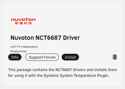

Hello all,
@ich777 awsome work with these plugin.
I'm running Unraid OS 6.12.3 with stock kernel.
However, I need to update the kernel so modules for the NCT6775 can be loaded.
I also use BTRFS extensively in my pools (for data bandwidth), and features and bugfixes are frequent on this FS within linux kernel updates.
I also need drivers for Coral TPU and nvidia GPU.
I can see that your plugins goes up to kernel 6.6.13-unraid. Where can I find the bz* corresponding images please?
Have you yet tried to install the NCT plugin from the CA App?:
It supports even some 67xx chips.
Yes I did, but the 6775 module is not found. (unless I missed something).
Because it is using the 6687 module.
