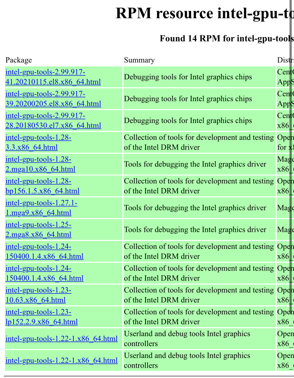

I made the mistake of going to pkgs.org and looking for the generic intel-gpu-tools package, which intel_gpu_top is apparently part of. The package returned has the 2.99.917 version number, but I haven't gone as far as extracting the package to see if intel_gpu_top has been updated. Plus the package appears to only be available as a .rpm so I'll have to run it through rpm2targz to convert it for Slackware. Need to get my test box back in service before I try that. Link here if you want to take a look: https://pkgs.org/download/intel-gpu-tools
So ignore my fumbling... 🤔 🤣
I just looked into that and I think this is a odd choice of naming a debug release:
(in my humble oppinion not even worth extracting)
