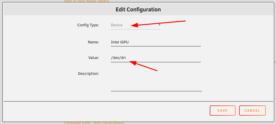

You should really add the path like that:

Does the path above replace what I did in extra parameters? I added something similar there, see attached photo. Let me know if I need to remove the extra parameter.
Yes.

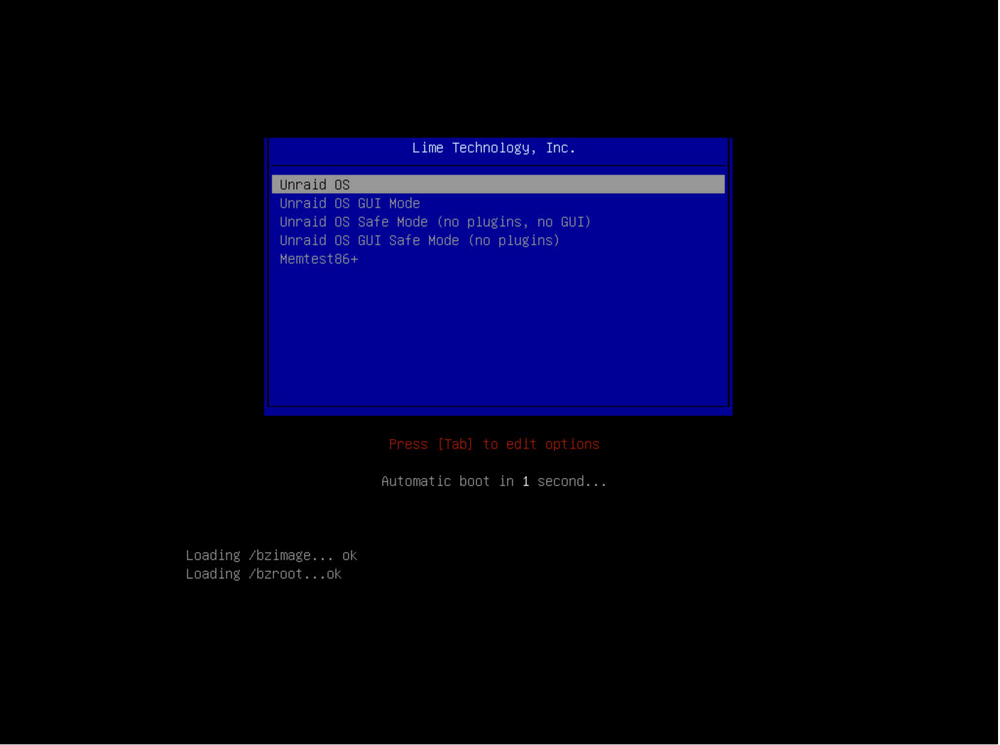

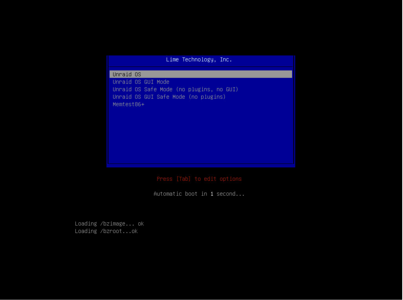

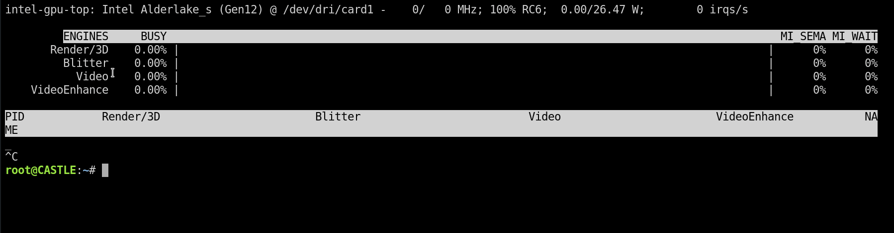

So I believe your hunch of disabling the ASPEED igpu is correct to get the primary igpu working. I didn't disable the ASPEED, but let me explain why I think you're correct.
So whenever I set the primary display to either auto or cpu and i don't have a monitor plugged in, I would get a black screen on the KVM, and my system didn't boot to unraid. When I set my primary display to cpu and enabled igpu multi-monitor, I can use the KVM and unraid boots, but intel_gpu_top doesn't work, meaning the primary display is not working.
I used the dummy hdmi adapter and I set my primary display to cpu and disabled igpu multi-montor and the KVM works up until the unraid boot screen comes up and then it freezes as the countdown hits 1. The first time this happened, I thought unraid didn't boot properly, so I power cycled my PC, but after I power cycled my PC, i noticed that the unraid login page was up. So I waited for the reboot to finish and it did the same thing as I watched the boot from the KVM, then KVM freezes at the unraid boot screen. This time I switched over to the unraid login page and I see that it was up and I was able to login.
When I ran intel_gpu_top in the terminal it worked. See screenshots.
So here's why you're right about the ASPEED. It seems that with the dummy hdmi adapter I can use the KVM (ASPEED) up until unraid boots and once it does, the igpu(primary display) takes over, which disable the KVM (ASPEED), hence the KVM freezes.
At least with it set up this way I have a partial KVM instead of no KVM at all, so I will leave it like this for know. I'm going to bring this up with ASUS support to see if they can resolve this problem in a future update. The ASPEED igpu and primary igpu should be able to work at the same time, it why people purchase a motherboard with a KVM.
