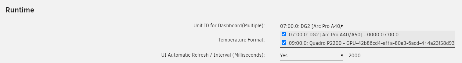

Does the Intel GPU TOP plugin support Intel Pro A40?   I'm having a little trouble with setup (I can see the device through the command line with lspci, but GPU statistics doesn't show it).   lspci snippet below.
07:00.0 VGA compatible controller: Intel Corporation DG2 [Arc Pro A40/A50] (rev 05)
08:00.0 Audio device: Intel Corporation DG2 Audio Controller
Are you running 7 beta? Required for arc support.
Thank you @SimonF for the amazingly quick response.  Yes, I am running 7 beta and I did a little tinkering with the dashboard settings and got it working!!
For others who may follow in my footsteps with a Pro A40 card, you'll need to select the drop-down in the GPU statistics "Unit ID for Dashboard(Multiple):
Selecting both options enabled an extra statistics window.

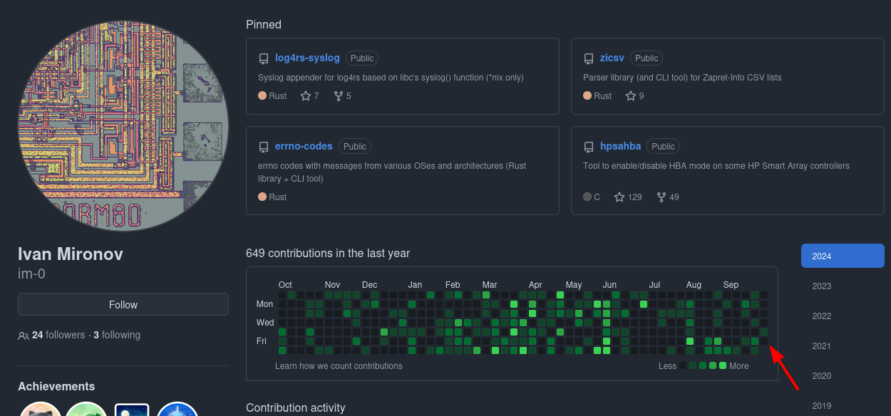

11 minutes ago, fargotto48 said:
I don't see any activity from the author.
I see a lot of activity from the maintainer:
Sorry... I think you got my point wrong about creating a second plugin.
The second repository that you've linked is just a fork and I really don't want to create a plugin from a not maintained repository off that is maybe working for this release but not working for one of the next Unraid releases, I would rather want to have to have the plugin based by a well maintained repository like the one from im-0 (at least it was always well maintained and I hope it still is).
You are the first one who reported such an issue, I assume it was always working for other people in the past since nobody yet reported such an issue.
