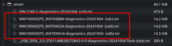

24 minutes ago, fargotto48 said:
Here's my data archive.
As you can see here only three disks are recognized:
Here is also something in the logs which indicate a driver issue:
Oct  4 05:36:03 Tower kernel: hpsa can't handle SMP requests
Oct  4 05:36:03 Tower kernel: hpsa 0000:06:00.0: aborted: LUN:000000c000000001 CDB:12000000310000000000000000000000
Oct  4 05:36:03 Tower kernel: hpsa 0000:06:00.0: hpsa_update_device_info: inquiry failed, device will be skipped.
Oct  4 05:36:03 Tower kernel: hpsa 0000:06:00.0: aborted: LUN:000000c000000101 CDB:12000000310000000000000000000000
Oct  4 05:36:03 Tower kernel: hpsa 0000:06:00.0: aborted: LUN:000000c000000201 CDB:12000000310000000000000000000000
Oct  4 05:36:03 Tower kernel: hpsa 0000:06:00.0: aborted: LUN:000000c000000301 CDB:12000000310000000000000000000000
Oct  4 05:36:03 Tower kernel: hpsa 0000:06:00.0: aborted: LUN:000000c000000401 CDB:12000000310000000000000000000000
Oct  4 05:36:03 Tower kernel: hpsa 0000:06:00.0: scsi 3:0:0:0: added RAID              HP       P410             controller SSDSmartPathCap- En- Exp=1
Oct  4 05:36:03 Tower kernel: hpsa 0000:06:00.0: scsi 3:0:1:0: masked Direct-Access     ATA      MM1000GFJTE      PHYS DRV SSDSmartPathCap- En- Exp=0
Oct  4 05:36:03 Tower kernel: hpsa 0000:06:00.0: scsi 3:0:2:0: masked Direct-Access     ATA      MM1000GFJTE      PHYS DRV SSDSmartPathCap- En- Exp=0
Oct  4 05:36:03 Tower kernel: hpsa 0000:06:00.0: scsi 3:0:3:0: masked Direct-Access     ATA      MM1000GFJTE      PHYS DRV SSDSmartPathCap- En- Exp=0
Oct  4 05:36:03 Tower kernel: hpsa 0000:06:00.0: scsi 3:0:4:0: masked Enclosure         PMCSIERA  SRC 8x6G        enclosure SSDSmartPathCap- En- Exp=0
As I thought this is not a software issue this is a driver issue.
