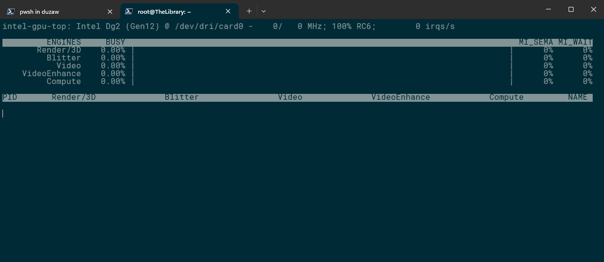

1 hour ago, DuzAwe said:
Just got an a40. I cant see the power draw in the CLI nor in the dashboard. The bar fills but no numbers.
That's normal and I can't do anything about it.
dGPUs report the temperature alongside the power different than an iGPU.
Issue `sensors` form a Unraid terminal and see if your card reports any of the above mentioned.
AH! Yup says N/A for power1.
Cool, as always thanks for the help and awesome work.

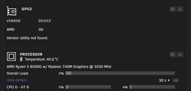

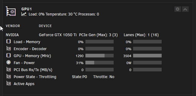

RADEON-TOP
UR 6.12.13
Ryzen 5 8500G / Radeon 740M Graphics
Forgive me if this was listed somewhere. I've been working on this for quite some time and all the searches I have done have led me nowhere.
I've managed to get the system to boot up and the GPU is shown in the device list. I had to blacklist it in modprobe or the whole server would lock up at boot.
So now that the system is up and I can see the VGA in the devices, I went to install Radeon-Top. When it came to the last part, enabling amdgpu kernel 'something', the whole thing locked up again.
Was this a fluke and I should try installing it again? If the GPU is blacklisted does this pose a problem for Radeon-Top? Is Radeon-Top needed anymore to get the GPU into a Plex container?
The GPU Stats plugin can see my Nvidia card and it does see the AMD one but nothing is displayed.
Could this be down to the UR kernel not supporting the GPU as yet? (I can't confirm this is a fact but other posts on Linux systems all point to kernels above 6.1.106)
Yes, because RadeonTOP is making sure the module is enabled.
If you have issues booting up your server without blacklisting your AMD GPU it isn't a fluke and if you install RadeonTOP again it will make again sure to enable the module that you've blacklisted.
I would recommend that you upgrade to Unraid 7.0.0-beta.4 and see if you can boot that version without the blacklist, if the server boots fine without the blacklist then it is safe to install RadeonTOP.
I assume you know when you blacklist a module in modprobe.d that the device isn't working properly since the driver isn't loaded.
However, if you are feeling uncomfortable upgrading to Unraid 7.0.0-beta.4 I can tell you that I've been running in on my main server since release (compiling Kernel Module packages for the Driver plugins, creating Plugins,...).
