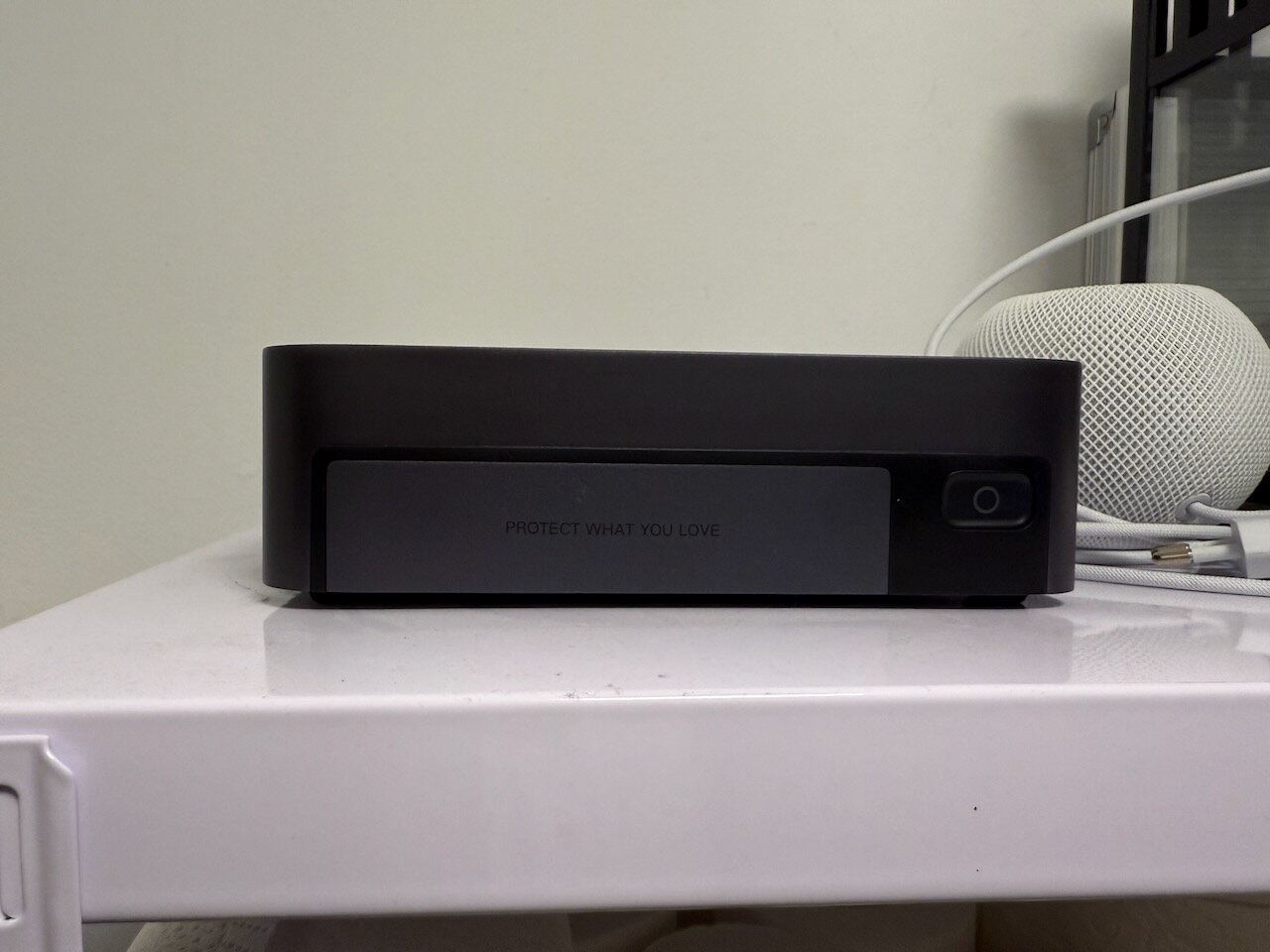

Sorry I don’t own such hardware, what is the first led? Power, LAN, HDD?
You're right, my apologizes.
Here you can see a short video of LED activity:
As you can observe, the Power Button LED is still, the LAN LED is always flashing and the Disk 1 flashes (with a different pace) only during read/write operations.
Thank you for your support!
This is expected behavior.
This is also expected since most likely something is always using the network. If you want to test of it works disconnect the LAN cable.
This is also expected.
What should be different?
I didn't know, sorry.
I tought that LAN was supposed to stay still when connected and off when disconnected.
Thank you for clarifying!
No worries at all.
It actually indicates when there is activity.
The LED stays solid when there is no activity.
