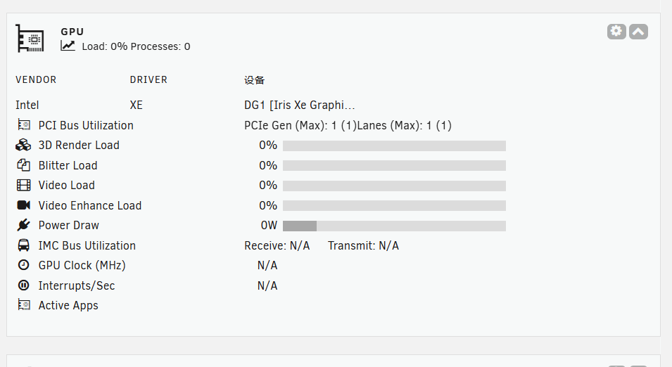

Hi, thank you for your work !
Before i used a uhd630 and it can be detectd by "Intel GPU TOP" and display the gpu status correctly.
But recently i got a intel dg1 graphic card and it use xe driver, "Intel GPU TOP" can not  recognize the card.
Is there some way to solve this problem? thanks!
It would be very helpful to have your Diagnostics.
People are using DG1 cards and have no issues AFAIK, I think there was at least one post about such a card here and it seemed to work.

40 minutes ago, XINJIAWEI said:
hi, here is my diagnostics. hope it is helpful !!!
I assume the DG1 doesn't have a Display output?
It seems that the driver can't wake the card, are you sure that the card is in working condition:
Mar 25 21:34:51 JiaweiUnraid kernel: xe 0000:03:00.0: [drm] GT0: Engine reset: engine_class=vcs, logical_mask: 0x3, guc_id=3
Mar 25 21:34:51 JiaweiUnraid kernel: xe 0000:03:00.0: [drm] GT0: Timedout job: seqno=4294967169, lrc_seqno=4294967169, guc_id=3, flags=0x0 in ffmpeg [13624]
Mar 25 21:34:51 JiaweiUnraid kernel: xe 0000:03:00.0: [drm] Xe device coredump has been created
Mar 25 21:34:51 JiaweiUnraid kernel: xe 0000:03:00.0: [drm] Check your /sys/class/drm/card0/device/devcoredump/data
Mar 25 21:34:51 JiaweiUnraid kernel: xe 0000:03:00.0: [drm] GT0: failed to get forcewake for coredump capture
Mar 25 21:34:51 JiaweiUnraid kernel: xe 0000:03:00.0: [drm] GT0: Timedout job: seqno=4294967174, lrc_seqno=4294967174, guc_id=3, flags=0x0 in ffmpeg [13624]
Mar 25 21:34:57 JiaweiUnraid kernel: xe 0000:03:00.0: [drm] GT0: Engine reset: engine_class=vcs, logical_mask: 0x3, guc_id=22
Mar 25 21:34:57 JiaweiUnraid kernel: xe 0000:03:00.0: [drm] GT0: Timedout job: seqno=4294967169, lrc_seqno=4294967169, guc_id=22, flags=0x0 in ffmpeg [13624]
Mar 25 21:34:57 JiaweiUnraid kernel: xe 0000:03:00.0: [drm] GT0: Timedout job: seqno=4294967171, lrc_seqno=4294967171, guc_id=22, flags=0x0 in ffmpeg [13624]
Mar 25 21:34:57 JiaweiUnraid kernel: xe 0000:03:00.0: [drm] GT0: Timedout job: seqno=4294967172, lrc_seqno=4294967172, guc_id=22, flags=0x0 in ffmpeg [13624]
Mar 25 21:35:00 JiaweiUnraid rpc.mountd[11948]: v4.0 client attached: 0xf101fd8567e2b0d0 from "10.168.1.128:926"
Mar 25 21:35:04 JiaweiUnraid kernel: xe 0000:03:00.0: [drm] GT0: Engine reset: engine_class=vcs, logical_mask: 0x3, guc_id=3
Mar 25 21:35:04 JiaweiUnraid kernel: xe 0000:03:00.0: [drm] GT0: Timedout job: seqno=4294967169, lrc_seqno=4294967169, guc_id=3, flags=0x0 in ffmpeg [14038]
Mar 25 21:35:04 JiaweiUnraid kernel: xe 0000:03:00.0: [drm] GT0: Timedout job: seqno=4294967174, lrc_seqno=4294967174, guc_id=3, flags=0x0 in ffmpeg [14038]
Mar 25 21:35:10 JiaweiUnraid kernel: xe 0000:03:00.0: [drm] GT0: Engine reset: engine_class=vcs, logical_mask: 0x3, guc_id=22
Mar 25 21:35:10 JiaweiUnraid kernel: xe 0000:03:00.0: [drm] GT0: Timedout job: seqno=4294967169, lrc_seqno=4294967169, guc_id=22, flags=0x0 in ffmpeg [14038]
Mar 25 21:35:10 JiaweiUnraid kernel: xe 0000:03:00.0: [drm] GT0: Timedout job: seqno=4294967171, lrc_seqno=4294967171, guc_id=22, flags=0x0 in ffmpeg [14038]
Mar 25 21:35:10 JiaweiUnraid kernel: xe 0000:03:00.0: [drm] GT0: Timedout job: seqno=4294967172, lrc_seqno=4294967172, guc_id=22, flags=0x0 in ffmpeg [14038]
Mar 25 21:35:16 JiaweiUnraid kernel: xe 0000:03:00.0: [drm] GT0: Engine reset: engine_class=vcs, logical_mask: 0x3, guc_id=3
Mar 25 21:35:16 JiaweiUnraid kernel: xe 0000:03:00.0: [drm] GT0: Timedout job: seqno=4294967169, lrc_seqno=4294967169, guc_id=3, flags=0x0 in ffmpeg [14413]
Mar 25 21:35:16 JiaweiUnraid kernel: xe 0000:03:00.0: [drm] GT0: Timedout job: seqno=4294967174, lrc_seqno=4294967174, guc_id=3, flags=0x0 in ffmpeg [14413]
Mar 25 21:35:22 JiaweiUnraid kernel: xe 0000:03:00.0: [drm] GT0: Engine reset: engine_class=vcs, logical_mask: 0x3, guc_id=22
Mar 25 21:35:22 JiaweiUnraid kernel: xe 0000:03:00.0: [drm] GT0: Timedout job: seqno=4294967169, lrc_seqno=4294967169, guc_id=22, flags=0x0 in ffmpeg [14413]
Mar 25 21:35:22 JiaweiUnraid kernel: xe 0000:03:00.0: [drm] GT0: Timedout job: seqno=4294967171, lrc_seqno=4294967171, guc_id=22, flags=0x0 in ffmpeg [14413]
Mar 25 21:35:22 JiaweiUnraid kernel: xe 0000:03:00.0: [drm] GT0: Timedout job: seqno=4294967172, lrc_seqno=4294967172, guc_id=22, flags=0x0 in ffmpeg [14413]
You tried a lot from what I can see in your Diagnostics, please remove all the files from your modprobe.d directory, blacklist the xe and i915 driver and let Intel-GPU-TOP handle the modprobe.
The Intel-GPU-TOP plugin has a routine built in so that it probes the i915 driver with the correct probe against your GPU, but I'm not sure if that will help.
Just because I saw it, please don't do that in your go file since this is bad in my opinion:
