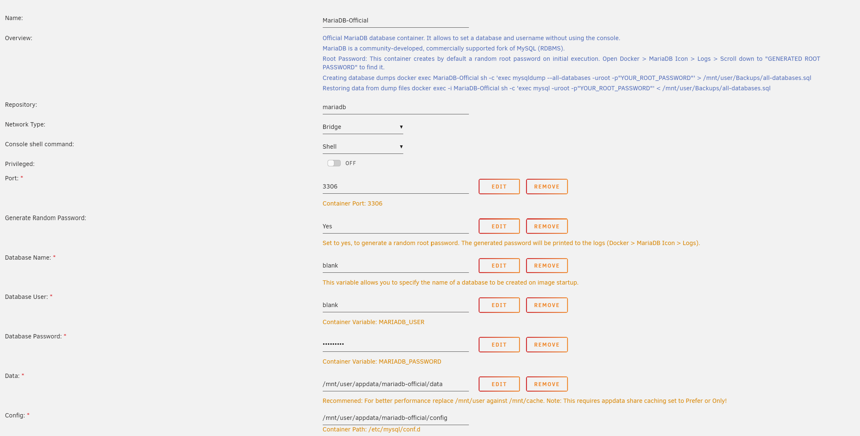

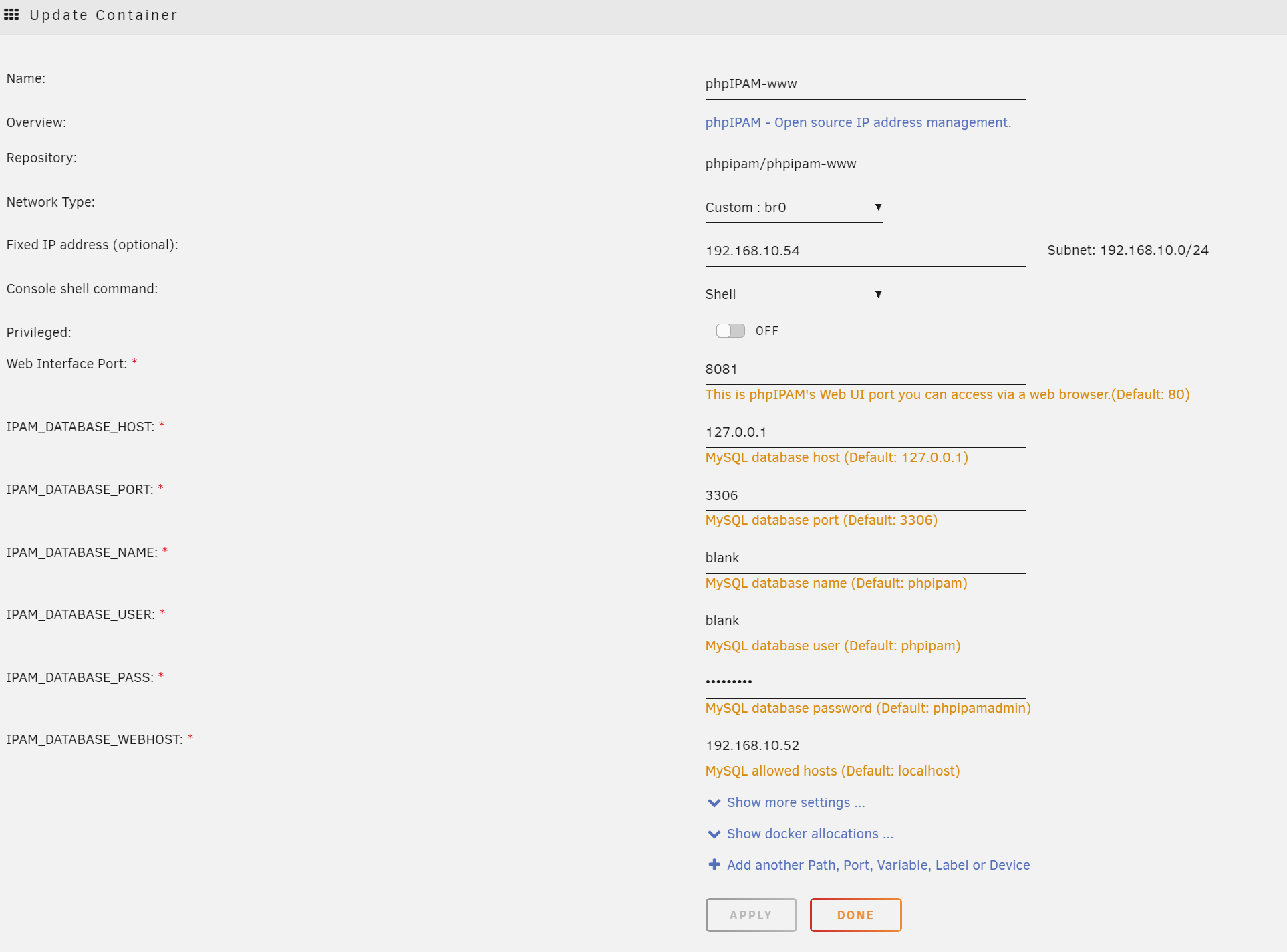

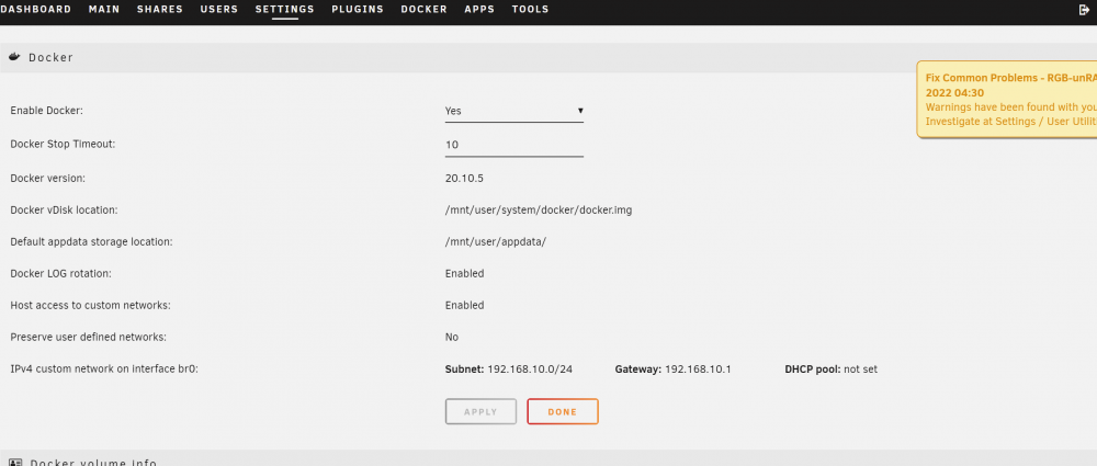

May 3, 20224 yr I ended up getting it to work by enabling "Host access to custom networks" in the Docker System Settings, advanced view. Without that it won't allow Dockers to talk to each other, it seems. In the phpipam docker, it must be set to the br0 Network Type. Then set a Fixed IP address and set IPAM_DATABASE_WEBHOST to the same address. IPAM_DATABASE_HOST should be set to the IP address of MariaDB, mine is the same as the Unraid server IP address. I ran the new install with using the automatic database creation and it worked without a hitch. MariaDB is set to Network Type - Bridge.

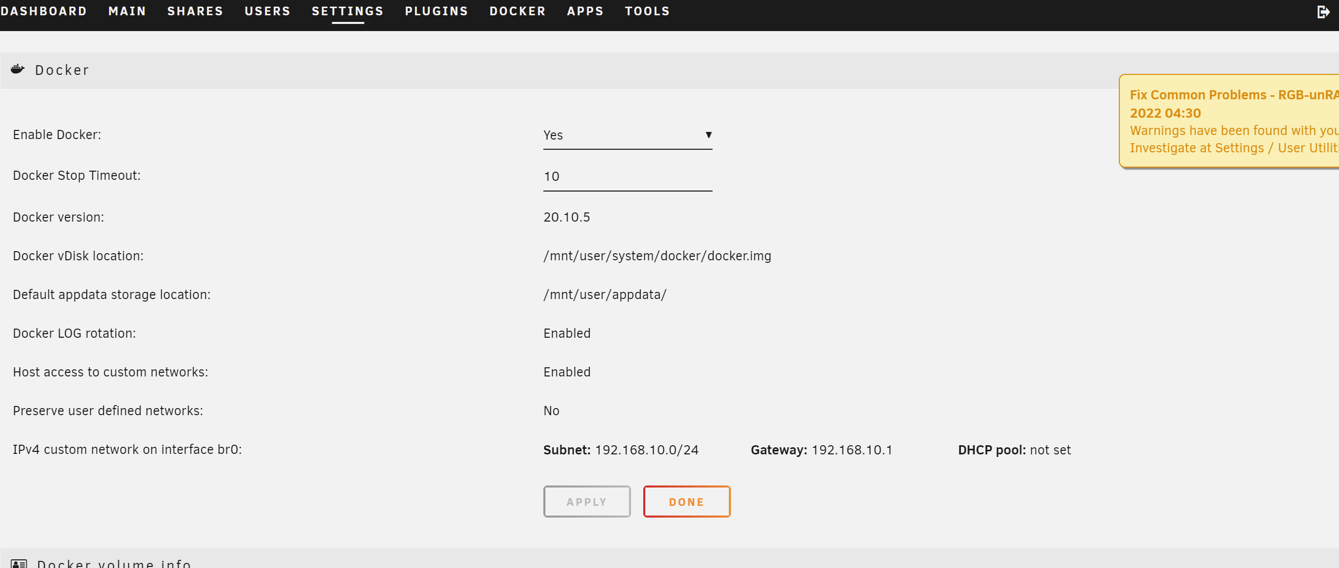

May 8, 20224 yr On 5/3/2022 at 9:01 AM, Ron Lucania said: I ended up getting it to work by enabling "Host access to custom networks" in the Docker System Settings, advanced view. Without that it won't allow Dockers to talk to each other, it seems. In the phpipam docker, it must be set to the br0 Network Type. Then set a Fixed IP address and set IPAM_DATABASE_WEBHOST to the same address. IPAM_DATABASE_HOST should be set to the IP address of MariaDB, mine is the same as the Unraid server IP address. I ran the new install with using the automatic database creation and it worked without a hitch. MariaDB is set to Network Type - Bridge. Ron, How do I enable "Host access to customer networks'? There doesn't appear to be a selector for this option. If anyone else may know how to change that, that would be great to know. Thanks!
May 8, 20224 yr Under settings in unraid, click on Docker and it will be greyed out at the bottom until you stop docker Edited May 8, 20224 yr by RGB_KGB
