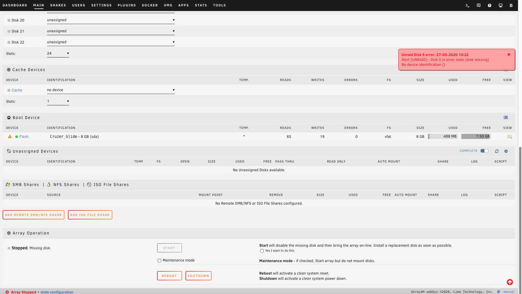

I have been trying to enable VM mgt. My unraid works great without it.  All drives mount, everything perfect.  But when I enable VT-X and VT-d in bios my entire array fails to mount properly.   Any ideas on how to investigate cause. see system config attached.

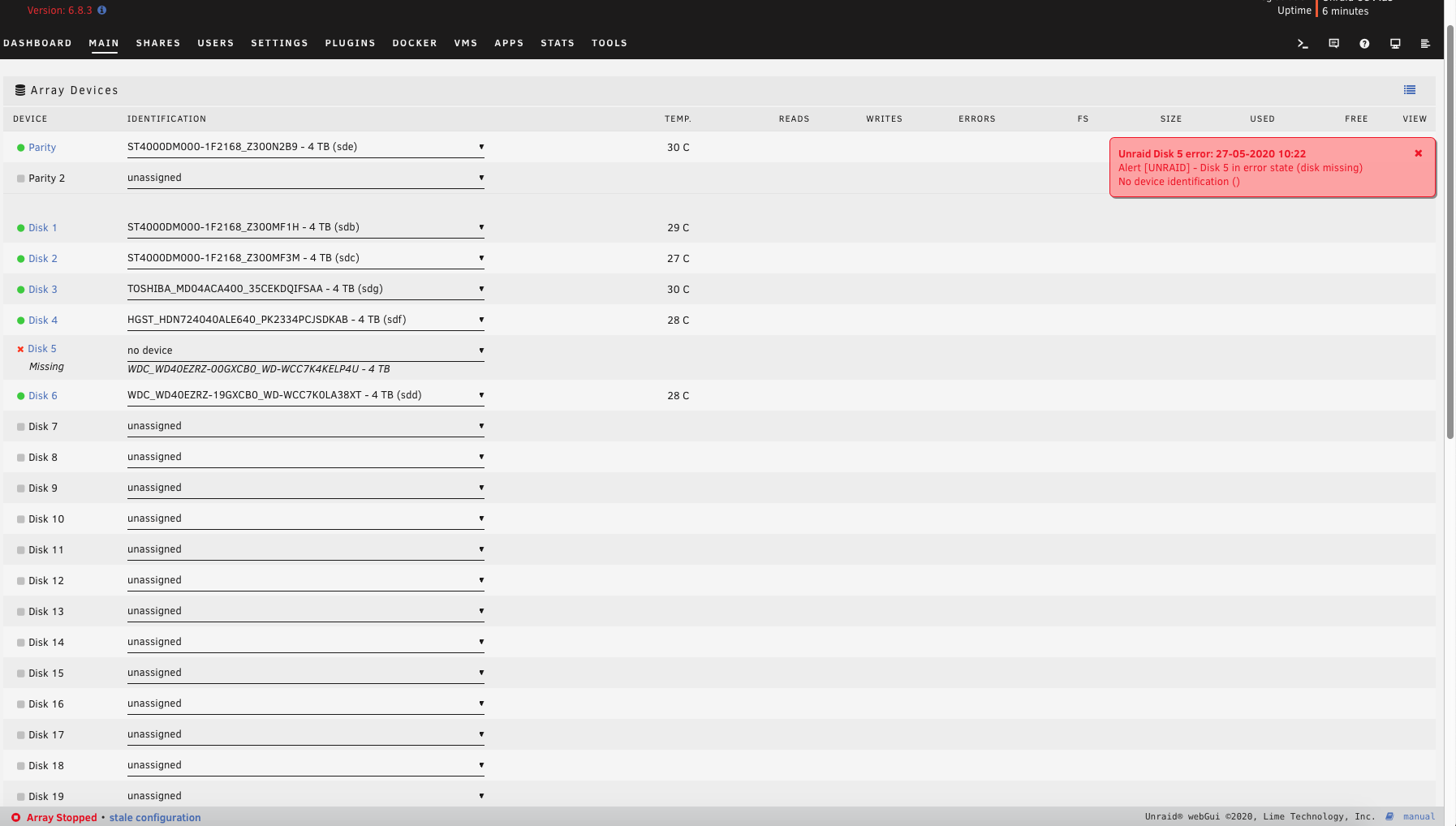

Heres the diagnostic after i've enabled VT-x and VT-d on the Bios.    The array starts off line with an error on Disk 5 of the array and shows the disk missing.  Also the cache drive does not mount.   No disks are showing in unassigned devices.

Marvell 9230 has known issues with vt-d enable, this works for some, failing that get a new non Marvell controller.
thanks you for your time and quick reply!  I really do appreciate it.
Worked like a charm!!!!!!      you are a genius!
