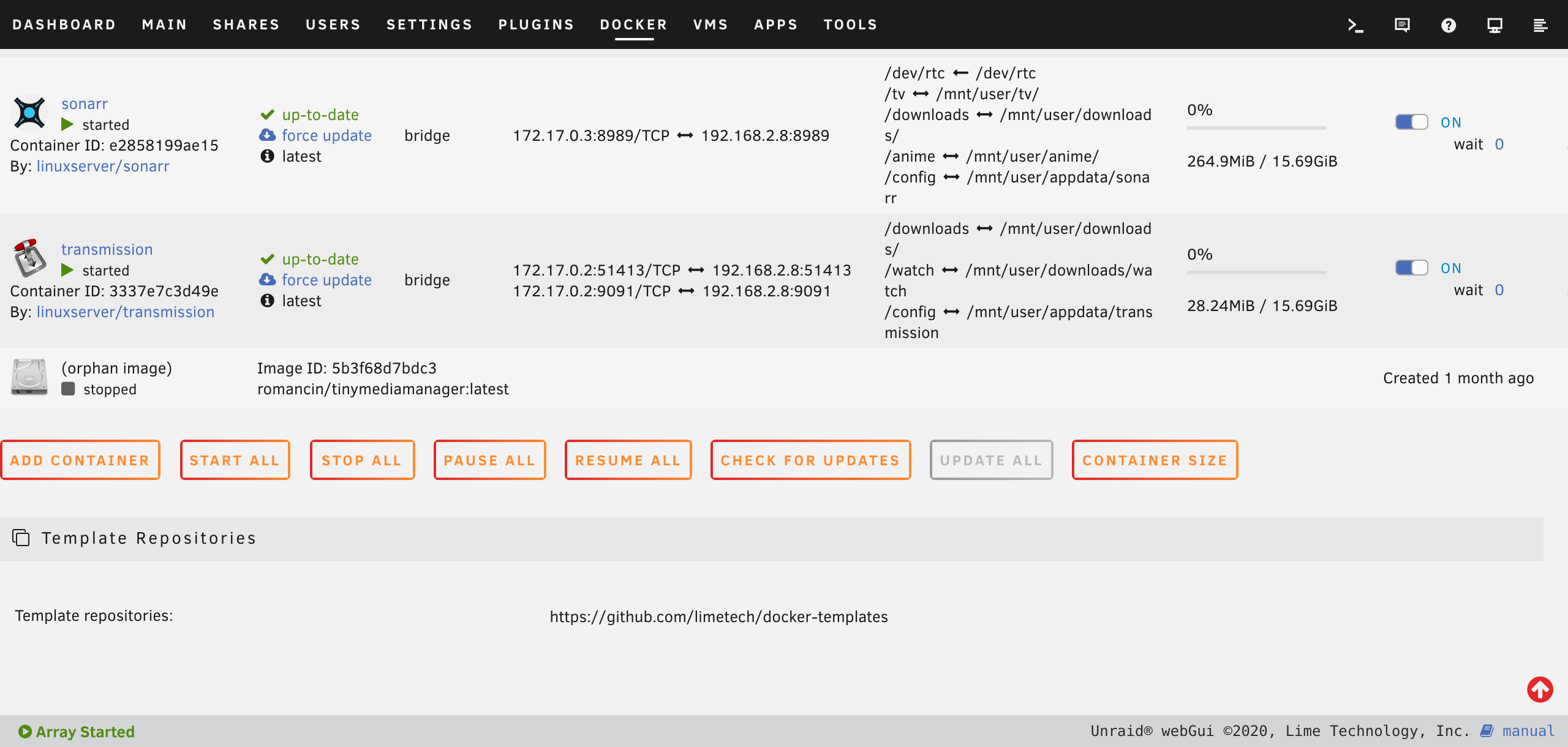

All of images I pulled from docker by command line would turn to orphan ...
First  of all ,I don't why some apps exsit on docker but not being available in Community Applications ? Such as
romancin/tinymediamanager

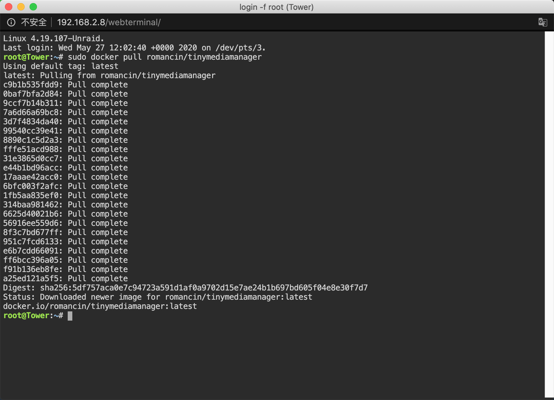

After that,I pulled the Tinymediamanager by command line, it shows "install successfully", whereas it reveals Orphan Image in docker page finnally.
I got the same result after many times.
699580812_commandline.thumb.png.a2bfc002f694ef7cd853971f006cb4fa.pngorphan.thumb.png.bef5533381b8455b0db6b7e44c3e8a5c.png
Would you tell me how to fix it ?
Thanks for helping.

Probably because the container hasn't been initialized to run after a simple pull.  IE: switching to docker run instead of docker pull doesn't result in an orphan, and starting the container after a pull via docker run also fixes the problem.

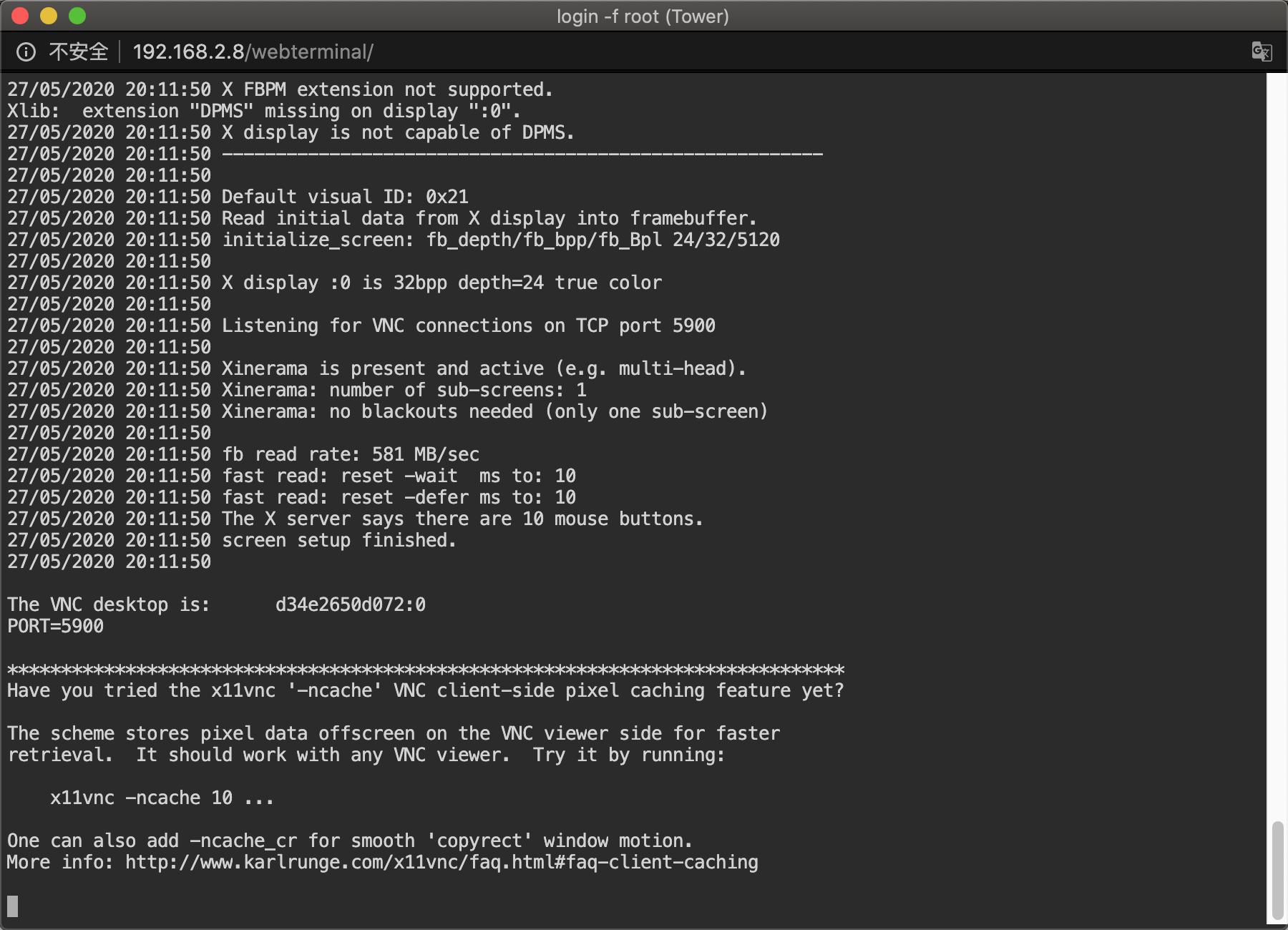

I used "Docker pull" in OMV, that would be done.
Docker run works. It pull and initialize the image ,and start it.  There is no orphan image any more.

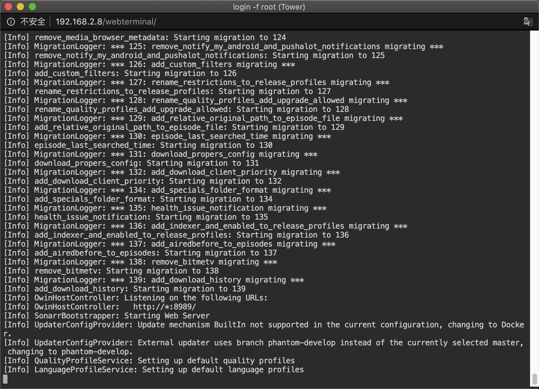

But the other issue happen , the tinymediamanegement and the Sonarr:perview could not start normally.
It seems that process stuck in the command line, and some strange image appear in docker.
Could you tell me how to fix it?
tinymediamanegement install log:
sonarr:perview install log:
