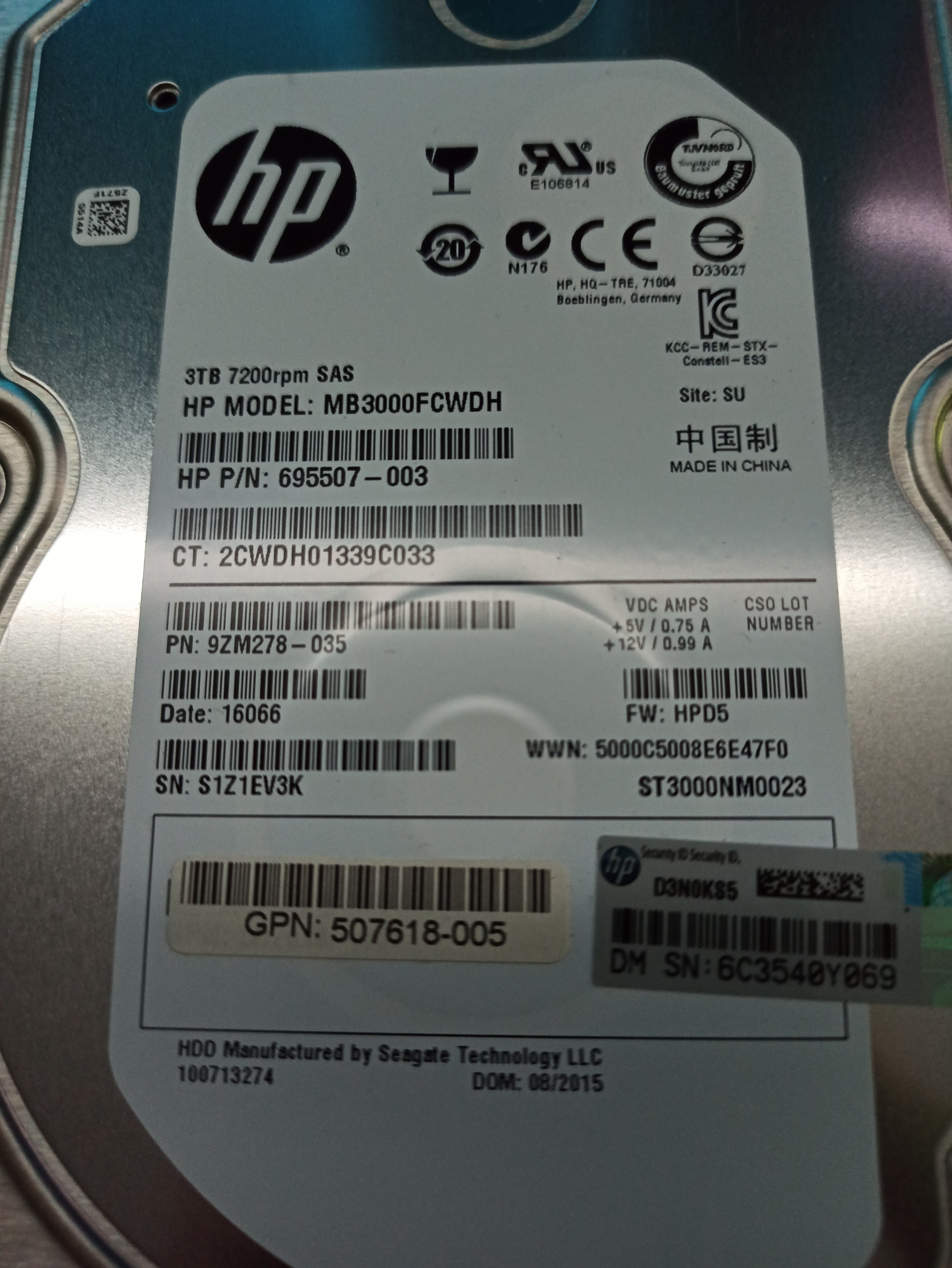

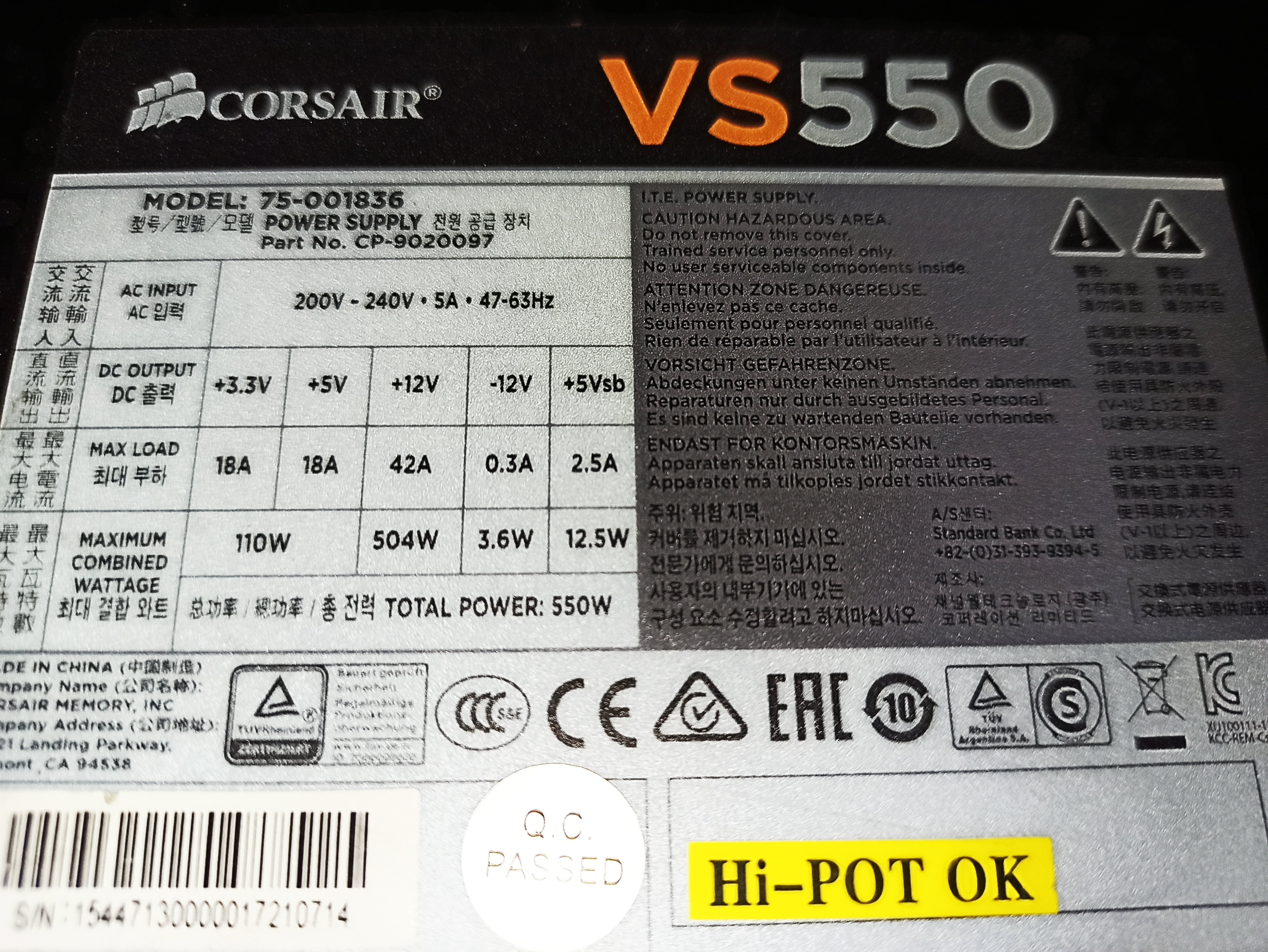

Needing some advice for new power supply just in case my current one doesn't have enough juice when all disks are at full load and causing my errors. My current power supply is Corsair VS550 with specs attached in image.

8 x HP MB3000FCWDH (3TB 6G SAS 7.2K 3.5in DP MDL SC HDD) - Future upgrade to 15x

Should the current spec power supply be enough for my needs or should I be looking for something with more amps on the 5/12v?

disk image
Unless the supply is faulty, that really should be fine.  My main server has 12 drives, and runs very happily on a 520W supply (see my sig below).  When very busy with the CPU fully loaded it draws about 150 - 200W from the mains supply.  I have never seen over 300W even when all the drives spin up at once.
How many drives are hanging off of a single run back to the power supply?
Currently a have two runs from the power supply in use, each supporting 4 disks.
My whole rack only draws about 300 watts - but you should try a different power supply, it should have more than enough to run 8 drives and what you're describing could be explained by voltage sag.
Also, I wouldn't hang too much more off a line than what you currently are (stay away from crap molded splitters, too. they'll burn your house down. get the punch down type)
