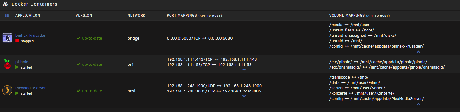

  • Moved the docker image location to cache only! (see screenshot docker_image_settings.png)
  • Set the docker parameters for each docker to cache only! (see screenshot docker_settings.png)

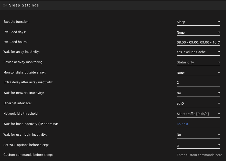

  • Activate the Dynamix Sleep Plugin with the settings shown in my attached screenshot (sleep_plugin_settings.png)
    • Excluded no days
    • Excluded hours from 08:00 until 24:00

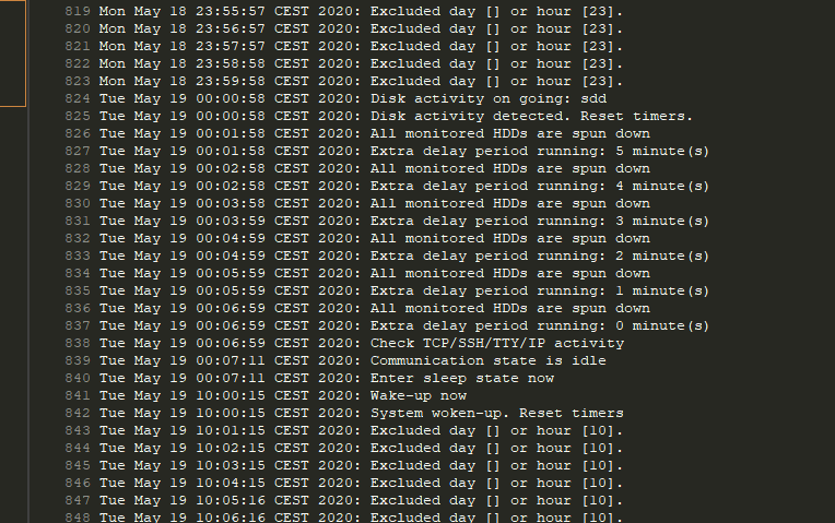

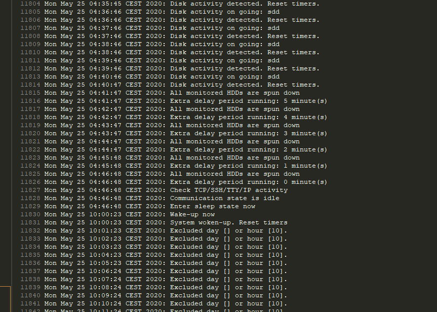

And - for complete confusion - sometimes it works completly correct (see sleep_works.png) or sometime just particially (see sleep_part.png) from 04:41 to 10:00 (RTC start)

And - it already worked on some days with the dockers running - I only have PLEX and Pi-Hole.

The sleep plugin just telling me that "sdd" got "activity" - sorry, but that is not a "debug log" - that information is completly useless due to the missing of details.

Update: Yesterday Bonienl (the dev of the plugin) gave me the hint to change the Device activity monitoring to "counters only" and it seems to work. 🙏
I'll validate this within the next days to be sure that my server is going to sleep reliably and will give an update here.
Jun  3 00:03:26 UNRAID s3_sleep: All monitored HDDs are spun down
Jun  3 00:03:26 UNRAID s3_sleep: Extra delay period running: 0 minute(s)
Jun  3 00:03:26 UNRAID s3_sleep: Check TCP/SSH/TTY/IP activity
Jun  3 00:03:26 UNRAID s3_sleep: Communication state is idle
Jun  3 00:03:26 UNRAID s3_sleep: Enter sleep state now
