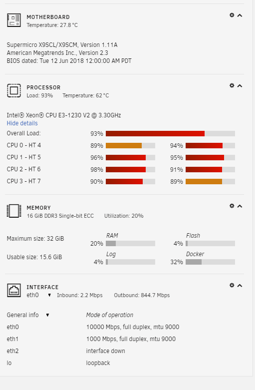

Extremely High Outbound Traffic
I've done some reaserch on the forums and have done some googling and can't seem to get to the bottom of my issue.  My unraid server continously has outbound traffic in the 600-700 Mbps range which seems insane to me.  The CPU usage sits in the up 80's - min 90's.  Can anyone point me at some potential troubleshooting that I may not have thought of?
Attached are the diasgnostic logs

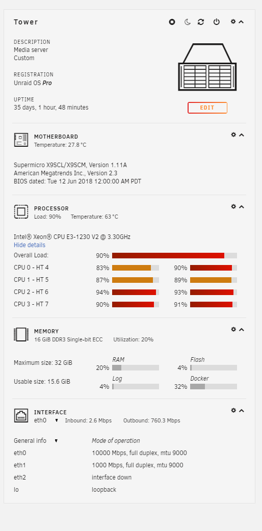

I've waited untill the "analyze intros" stopped running and am still experienceing the same weird almost Gbps outbound traffic from the sever.  I've also attached the diagnostics from this moment as well. I've persued the logs, but I really don't know what I'm looking for.  Any Ideas on troubleshooting tips?
