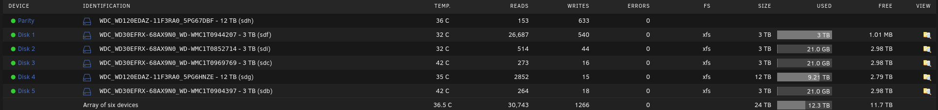

Can't copy anymore to Array . BUT still enough space

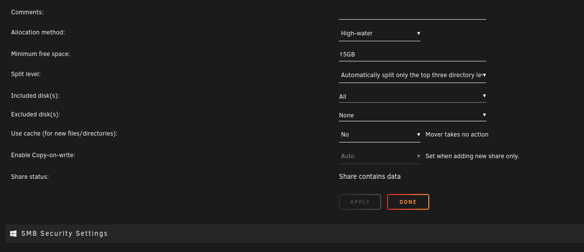

share where i copy it too
i copy it to /mnt/user/share/
the structure of the maps are  /share/Complete/[0-9,A-Z] each is 1 directory.
in those directories are the serie names. so it should split on the serie name maps.
but when i was coping it still put all on 1 hdd which is good till it was full but now i cant copy any file anymore to that share.
maybe unless i do it manual to disk X that is empty? but that isnt very handy.
Yes some of those directories can be BIG.
The problem is almost certainly the Split Level setting.     In the event of there being contention between the different setting on the share about which disk to select for a file then Split Level always wins.
also, how are you copying the files.   Some methods will create all the folders first.

i use the crusader docker
That is an app that is known to create all the target folders at the start of the copy which can result in exactly this sort of issue if your split level is too restrictive so that files are forced to the disk whish has their containing folder.
