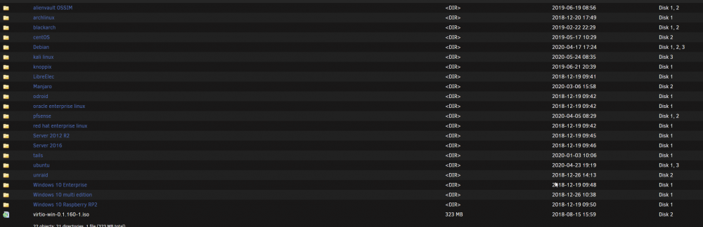

This status (the ! warning) is not valid).
as you can see, none of the files are on the cache.
What causes this or how can i fix the invalid error warning?
repo
Edited by repomanz
attached.
Edited by repomanz
If the isos folder exists on cache is enough to have the warning, check if it does exist on /mnt/cache, or set the share to cache="yes" and run the mover, the folder, if still there and empty, will be deleted.
This happens because the isos folder exists on your cache device, but has no content.
Follow the advice of @johnnie.black to remove the folder
thanks, that did it.
