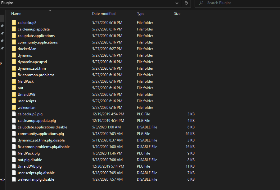

This lead me to believe that it is an issue with a plugin. I looked on the forms and saw that you could remove the files in Config/Plugins so i have (Before and after shots attatched). After doing this, the server is still responding with the same behavior. What i did notice, is after turning the server back on, the folder Config/plugins/dynamix was recreated somehow.
What do i do?!
You shouldn't delete the whole config/plugins folder. Just delete or rename any .plg files in that folder and the plugins won't load.
I have renamed all the PLG files in the Config/Plugin folder and the symptoms are the same.
