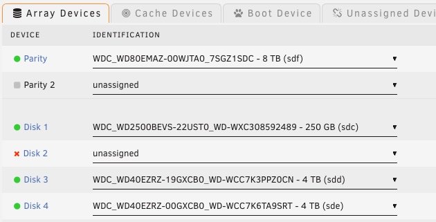

I moved all the data off the drive - that is disk 2 - see attached picture. I checked it was empty first.
Stopped the array, went to Tools -> New Config -> checked off everything in Preserved Current Assignments - see attached pic
Check Yes I want this to be Done
(disk 2 was then physically taken out of the server)

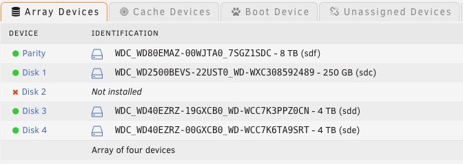

then went back to Main --> Array Devices - but Disk 2 can't be removed? see attached pic
I figure it's something simple, but I don't want to mess up.
Thanks.
After doing the New Config and returning to the Main tab to unassign disk 2 did you then start the array to commit the change and start rebuilding parity?  Simply removing the disk is not sufficient as Unraid would just treat this as a missing/failed disk scenario.
thanks so much. looks like parity is rebuilding now.
from the wiki steps 8 and 9 confused me - your clarification on step 8 to go to the main tab to restart the array AND not checking valid parity helped. I didn't know to go to the main tab!!
