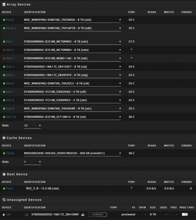

May 28, 20206 yr Actually 3 disks! First it started with Parity 1 with (UDMA CRC error count) I changed the SATA cable and connected it to another SATA port in the motherboard, and started rebuilding. While rebuilding, Disk 2 got disabled with +2000 IO errors. Rebuilding was not interrupted, I think because I have 2 Parities. Rebuilding completed, Parity 1 disk became green again. Disk 2 has red ball. After few hours, Disk 3 got disabled. Disk 2 - ST8000DM004-2CX188_WCT0M8D4 (sdm) (errors 2) Disk 3 - ST8000DM004-2CX188_WG8011AG (sdl) (errors 2048) Parity 1 is connected like this: motherborad -> 5.25 to 3.5 converter -> HDD Disk 2 and Disk 3 are connected to LSI SAS HBA through the same port. What is the best way to proceed? I believe losing another disk would cause data lose. I have a spare pre-cleared disk but it has (60 Reported uncorrect), not sure how it got pre-cleared without issues. Please let me know if need more info. I know I did a mistake by shutting down the server before getting the logs, I wanted to check the connections and was too scared to lose another disk. Thanks. Unraid Version: 6.7.2 CPU: AMD Ryzen 7 2700X Mobo: MSI X470 GAMING PLUS (MS-7B79) Memory: 16 GiB DDR4 tower-diagnostics-20200528-1303.zip Edited May 28, 20206 yr by HAMANY
May 28, 20206 yr Community Expert You rebooted since the errors so we can't see what happened, for now I would recommend unassigning both disabled disks and starting the array, check that both emulated disk mount correctly and contents look OK.
May 28, 20206 yr Author 31 minutes ago, johnnie.black said: You rebooted since the errors so we can't see what happened, for now I would recommend unassigning both disabled disks and starting the array, check that both emulated disk mount correctly and contents look OK. Thanks for the quick response. Will try this now. Edit: Done, the files looks fine. Is there anyway to prevent the logs from being removed with rebooting, and keep them for few days? Edited May 28, 20206 yr by HAMANY
