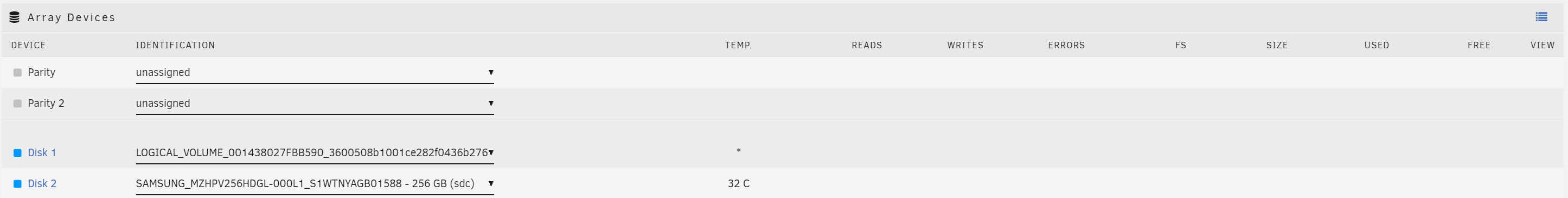

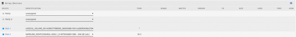

When i go to the main tab i can select the disks i want and i want one of the 12TB disks to be the Partity drive and the two others as Disk 1 & 2 and my two SSD's for Cache drive.
Though when i click the tabs to select the disk it seems to put two of the disks together both on SSD and HDD and the last HDD is missing.
Do you have any clues on how i could solve this issue.
