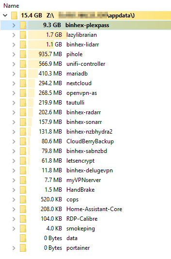

I think I've terribly misconfigured my dockers as I've been setting them up because stuff like plex is at 9.3GB and others are higher than I imagined.  I assume it's because I've been careless when choosing where to put the /config directly and allowing it to be put into the appdata folder.  For Plex I can see my metadata folder is massive - I can confirm I don't have any media hosted in there - just the /config directory is massive.
This looks to be the same case for all my other dockers where I've not put any thought into where the config dir should live.
Should I move my /config directory out of the appdata or is it ok in there?
Is there any issue with increasing the size of the docker.img to accommodate these large folders?
Cheers
Tom

Typically the "config" folder for a docker is mapped to appdata. Plex appdata can become a bit large and what you have seems fine.

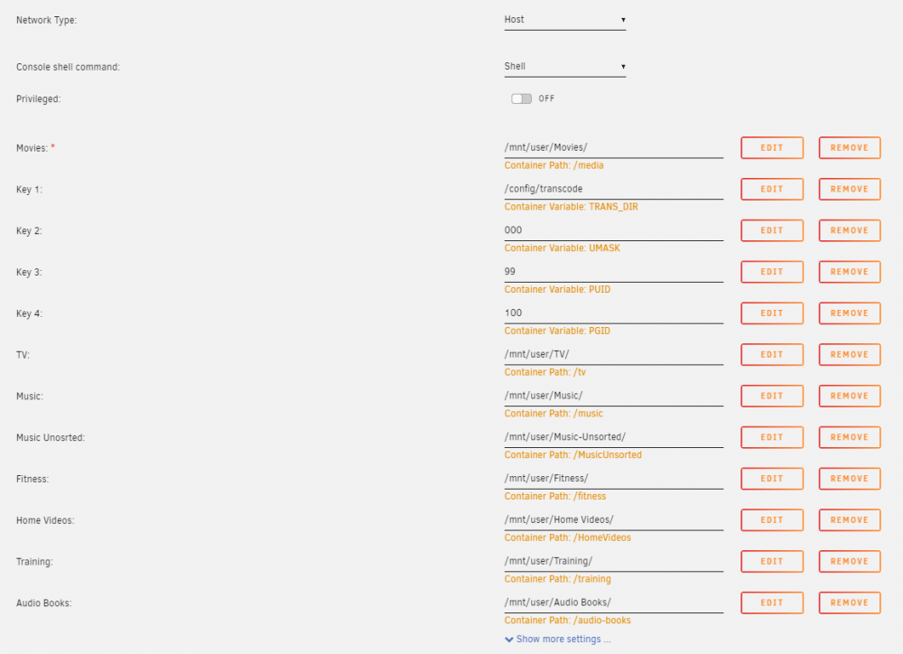

This is the run command from the container (ignore the test environment variable)
root@localhost:# /usr/local/emhttp/plugins/dynamix.docker.manager/scripts/docker run -d --name='binhex-plexpass' --net='host' -e TZ="Europe/London" -e HOST_OS="Unraid" -e 'TRANS_DIR'='/config/transcode' -e 'UMASK'='000' -e 'PUID'='99' -e 'PGID'='100' -e 'Test'='Test' -v '/mnt/user/Movies/':'/movies':'rw' -v '/mnt/user/TV/':'/tv':'rw' -v '/mnt/user/Music/':'/music':'rw' -v '/mnt/user/Music-Unsorted/':'/MusicUnsorted':'rw' -v '/mnt/user/Fitness/':'/fitness':'rw' -v '/mnt/user/Home Videos/':'/HomeVideos':'rw' -v '/mnt/user/Training/':'/training':'rw' -v '/mnt/user/Audio Books/':'/audio-books':'rw' -v '/mnt/user/appdata/binhex-plexpass':'/config':'rw' 'binhex/arch-plexpass'

That looks OK, depending on your answer to this:
1 hour ago, trurl said:
Also, the transcode directory setting within the plex application.
Plex doesn't write much except trancodes and possibly DVR if you use that. Do you use DVR in Plex?

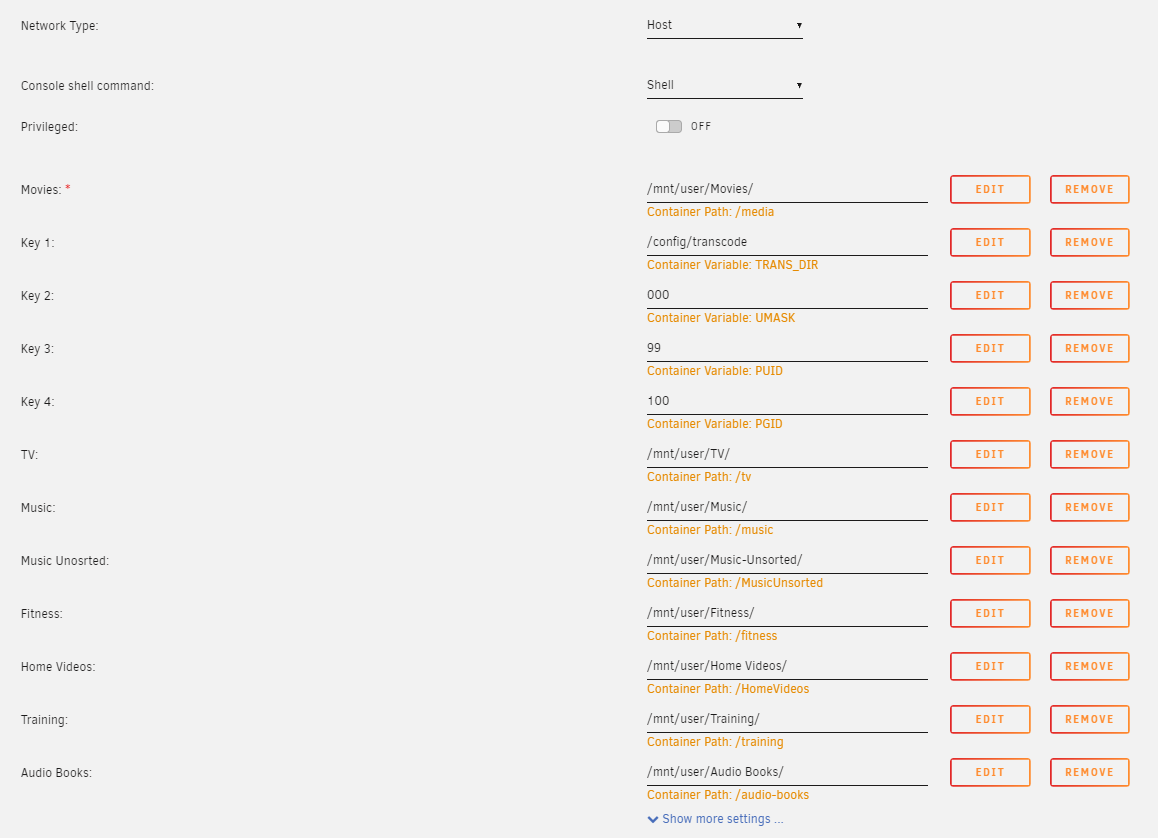

I'm not using DVR in Plex - I have probably set it up at some point but I never really got any use out of it.  My transcode directory doesn't look like it's configured correctly, I thought I have pointed this at a share on my cache drive.

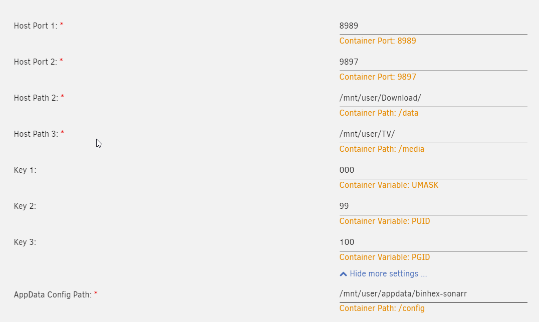

I have had a quick look through all my container settings and it seems they are all setup correctly using the case I set my shares to, i.e. "Download" and not "download" (this is massively helped by the unraid GUI doing the path creation for me.  I've mainly used Binhex's applications so I can't imagine the paths in the application are incorrect, but maybe I'm misunderstanding something.

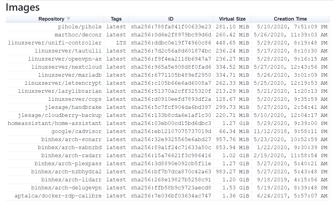

Trying to find the main culprit I used the cAdvisor (based on another post) to see the virtual size of my dockers and it seems that the ones that reference my "Download" share are the ones with higher usage.  I don't know if this is the right way to go.

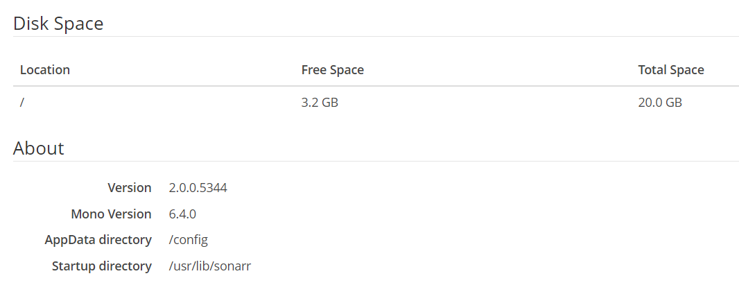

I drilled into Sonarr (just to pick one) and the directories look correct
The settings in docker seem to match my shares...
Not sure why you are telling me that. Perhaps you don't understand my explanation above. It is the settings within the application itself that must exactly match your mappings, specifically the container path in your mappings.
For example, if your deluge docker has /download mapped to /mnt/user/Download, but within the deluge application itself you have it set to use /Download, then that won't work because /download and /Download are different paths. The application must use the path specified as the container path in the mapping.
