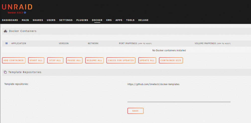

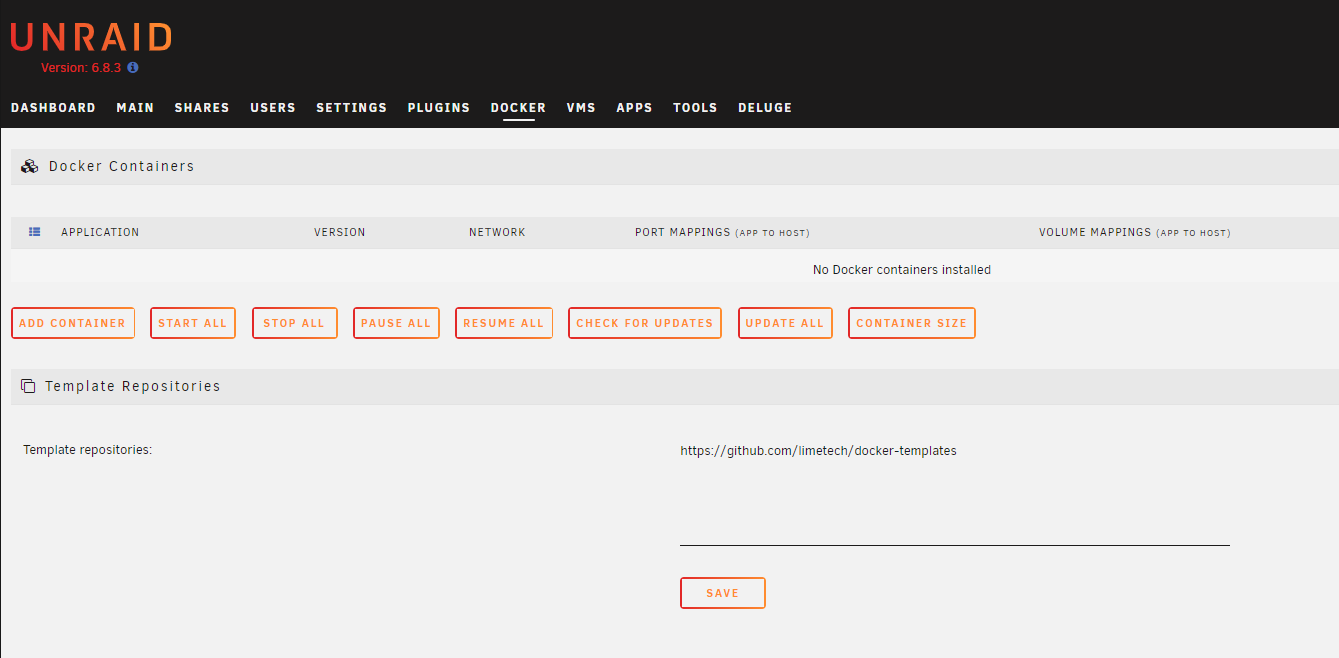

so every time I reboot the server all of the docker containers are gone.
The appdata/config is still there but I need to redownload every docker container each time I reboot the system.
It started happening two weeks ago. Before that everything was working fine.
If you guys need some kind of log please tell me which one because I'm truly at a loss here.
You can find the whole diagnostic file as an attachment. Note that I am currently in the process of redownloading all of the dockers.
